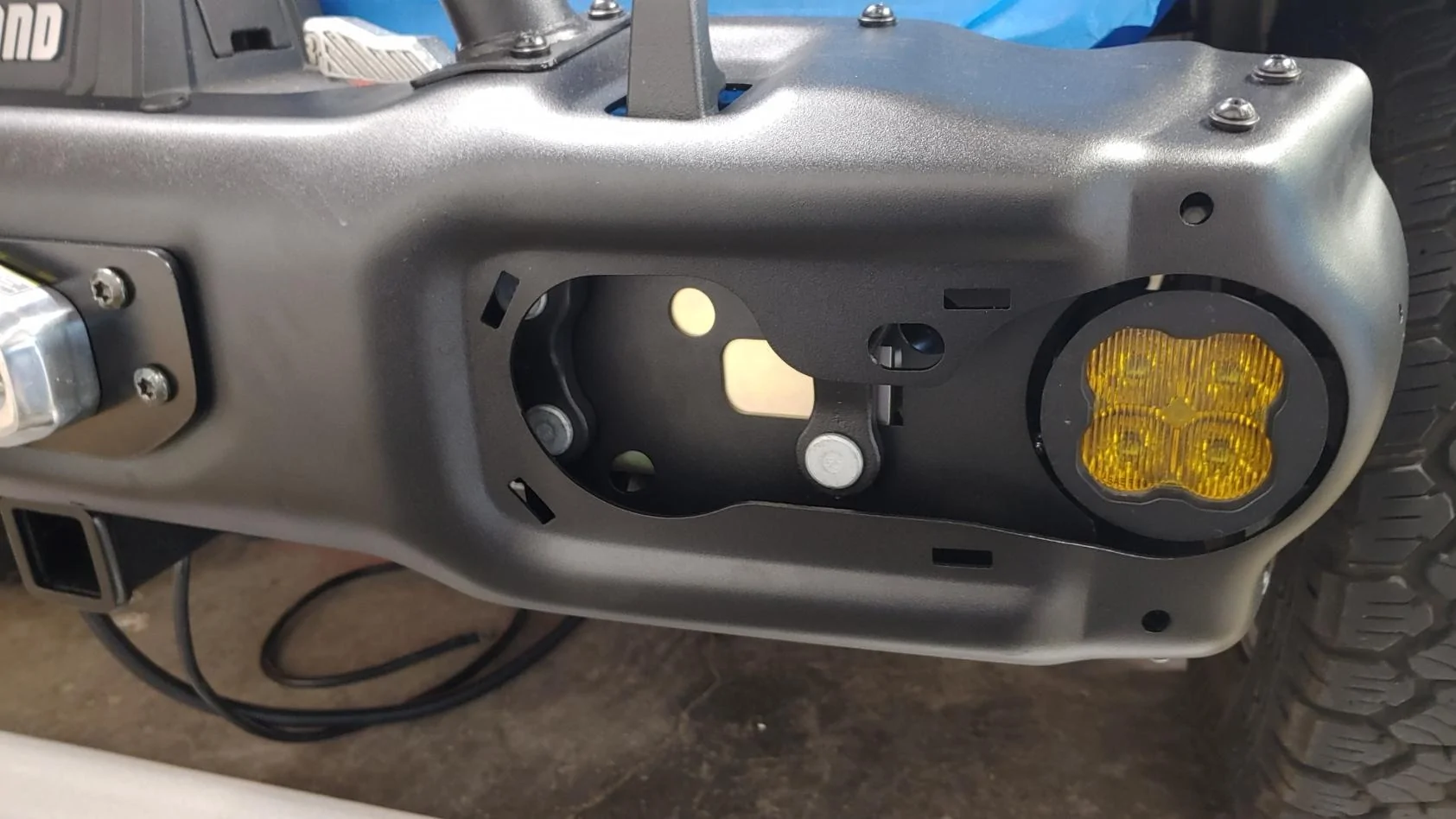

Everything fit ok, prolly the least quality fit was the plastic inserts/covers that go over the fog lights (I reused my factory LED fogs). They didn't snap in all that great and I suspect i'll need to come up with a Plan B at some point for those.
The fog light bezels have 2 holes in the outer ends. Those are for POM rivets that hold the bezel to the steel bumper. Those holes in the bezel should line up with holes in each end of the bumper. POM rivets are used on the MOPAR bumper, and that's what I did with my eBay bumper.
Mine came with plugs for the sensor holes, but they are absolutely junk. So i'll prolly order some rubber ones from McMaster or something.

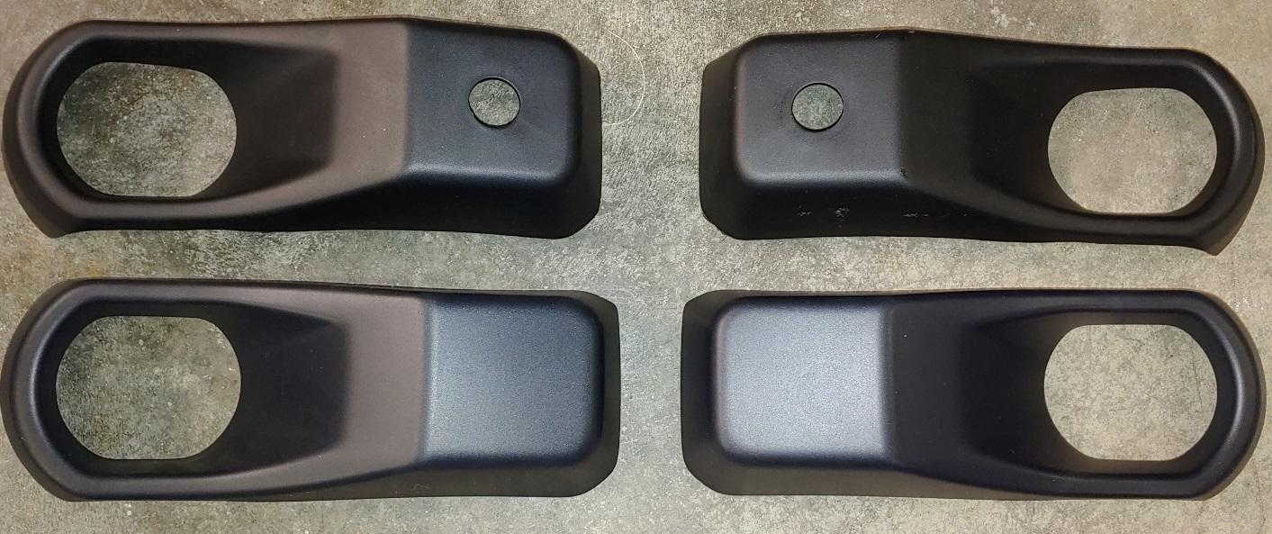

@ShadowsPapa - Do you think it worth it to get the bumper sand-blasted and re-powder coated? I was considering going this route... maybe even having the inside pieces (where the fog lights go) powder coated to color match the Gobi. (https://www.prismaticpowders.com/shop/powder-coating-colors/PSB-4920/refuge-green)

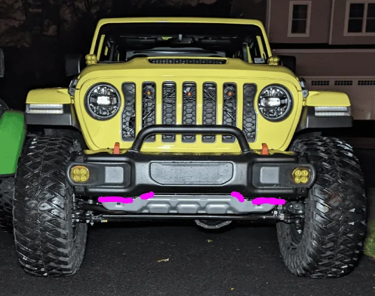

@Minty JL - How did you trim the Mojave skid to work? I saw another thread where someone trimmed the lower portion of the bumper instead to jive with the skid plate.
I think it was worth it. Color match would be cool.
However - the bezels around the fog lights are plastic.

I opted to trim the skid plate because it was easier and quicker to remove and test fit.
I used a cut off wheel to trim as needed.

Ended up being a total of 5 cuts, 2 on each side and that top center section.
I could have done it one shot, but I'm very methodical with cutting. I want clean cuts and enough spacing where there would not be any metal on metal contact. I'm not saying my way is better, its what worked for me.
This area on the extensions or ends would be good to have colored -
Thanks for the heads up! I thought the entire thing was steel... makes sense that the bezels might be plastic. Unless I can remove that inner part of the extension, powdercoating that little portion might be tough.

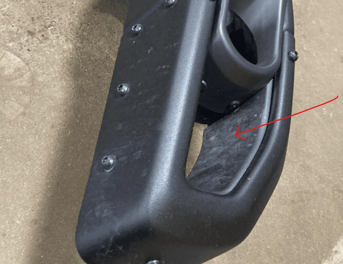

Crap - I forgot that the piece I have the arrow pointing to is also plastic. Dang, that's the part that the eBay bumper uses screws to hold in place and MOPAR uses POM rivets.
Sorry, that part is plastic as well. Only the back side of that extension or end, and the outer shell of the end is steel. That's what I get for being tired.
You'd need to paint that part as well. But since it's plastic or similar material, if you do paint it, use an additive to make the paint more flexible.
I had to have additive added to the paint used on my SX4's fender flares otherwise paint didn't last long with the temp changes of the material and the flexing.

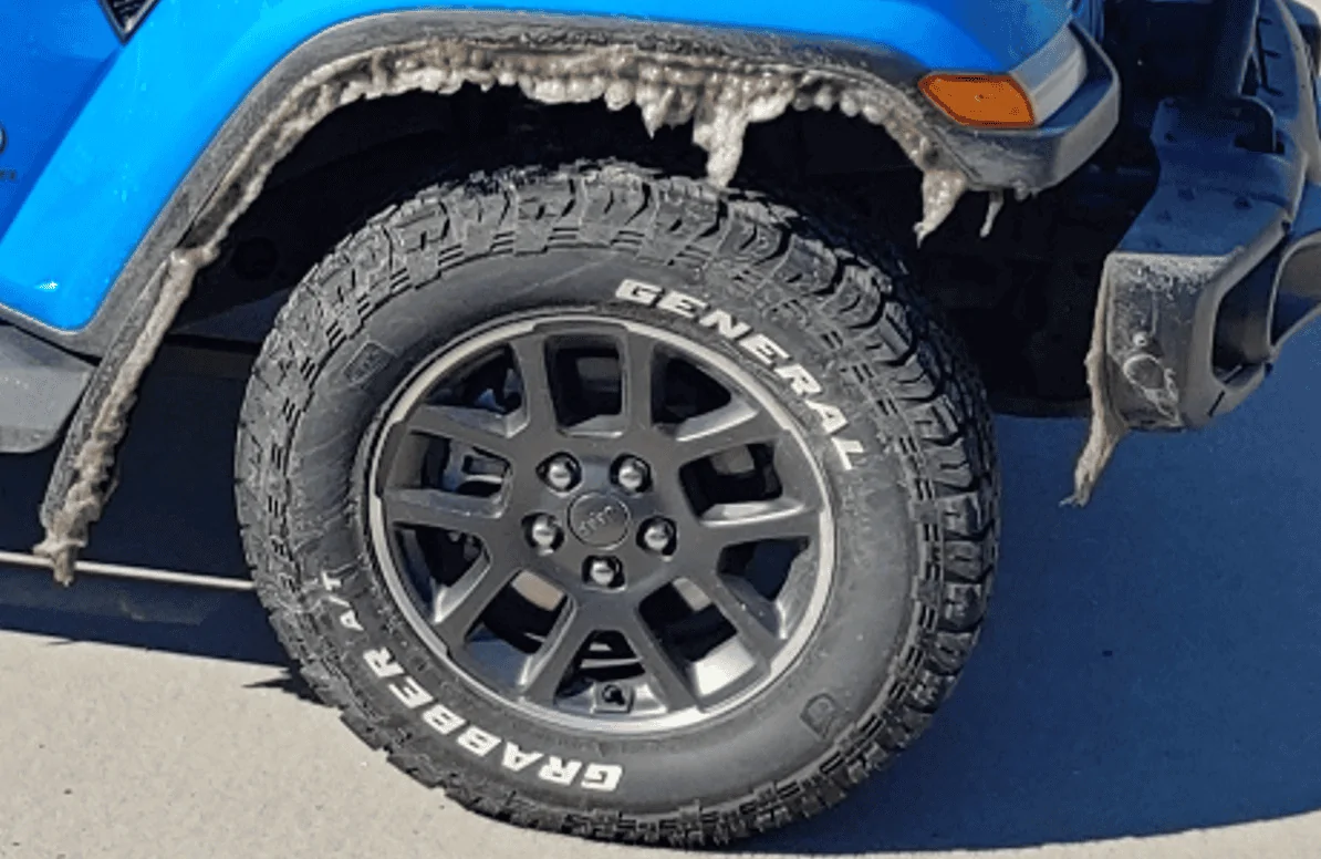

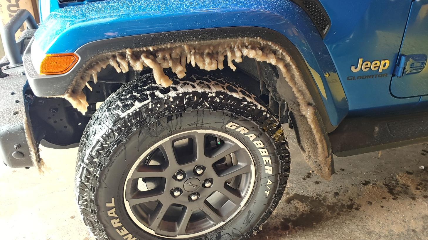

This is what does them in after a couple of years. In fact, this pits concrete when it thaws due to the salt content. I don't care what they use - sodium chloride, calcium chloride, whatever, they could use potassium chloride for all I care - they are all salts of metals. It's SALT.
That gets thrown forward into the inside of the bumper, sits and thaws and then you get rust inside the bumper where the mounting brackets bolt to the main body or shell of the bumper.
The outside holds up because this isn't sitting on it. And you won't see the rust inside until you take it apart.
Making it worse is the sand and grit and dirt on the highways that holds the wet salts against the metal like a wet sponge.
IF they don't use salts or chemicals on the roads, it's gonna hold up nicely. (actually, this should be a warning for any metal bumper with parts that bolt together)
