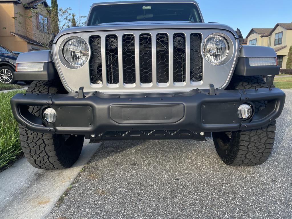

Is this OEM Mopar or a knock off rubicon steel bumper?
Gobi-Wan Kenobi
Feb 22, 2020
100
94
Earth
2020 Gladiator Sport
More info on the skid plate. I bought a bumper I was told was OEM, but I believe is a JTR. It had no skid plate, more info would be great!
I believe this bumper will work with any skid plate that works with the stock Rubicon metal bumper. There are a different number of bolts in the skid plate on the metal bumper so even a skid plate from a plastic Rubicon bumper will not fit. This has messed up a few people because they assumed that any Rubicon skid plate would work.
The fog light bezels are not the same as Mopar.
SteveInOrlando
Steve
Nov 1, 2020
507
496
Orlando, FL
2021 Jeep Gladiator Sport S
Software Design
yeah, those are customer fab to reduce the front bumper overhang. I really did not like those plastic bumps sticking out with nothing behind them. I shortened the bumper a few inches by removing them and replacing with simple patch panels.
Ok. Nifty

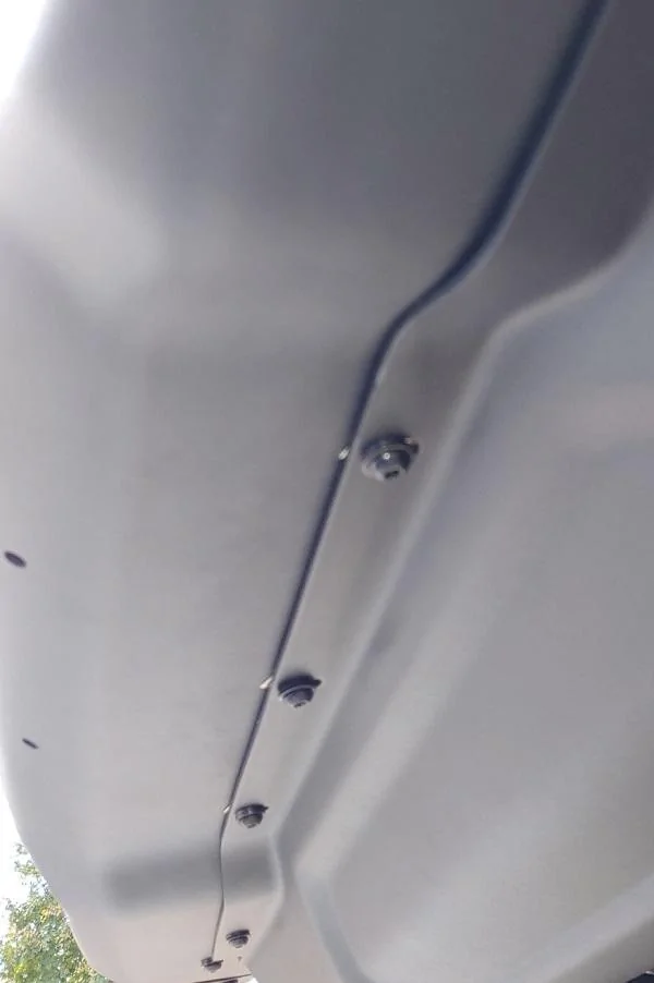

There are two different steel skid plates. The one for the plastic bumper doesn't attach to the steel bumper.
But both style skid plates used the same rear brackets that attach it to the frame at the back or lower part of the skid plate.
If you have the skid plate used with the plastic bumper, you won't use the front brackets.
The "knock-off" bumper comes with screws to attach the skid plate to the bumper.
So if you buy the skid plate for use with the steel bumper, you'll have the two front brackets left over when you are done.
This is how the skid plate made for steel bumpers attaches at the front. It will use the same rear brackets as the other skid plate so leave those attached to the frame.

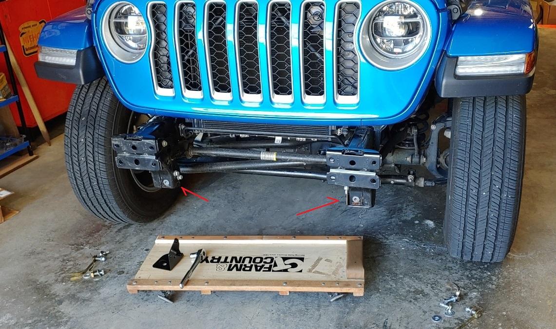

I may go this route since its not too much to get the skid without the hardware. Just to confirm, and sorry for being repetitive, I only need to purchase the new skid itself and do not need the hardware that you can get with it?
As long as you have the steel skid plate that comes with the "plastic" bumper, you don't need other brackets.
These are the only brackets needed - they attach to the frame using two bolts each bracket (you can see the bolts - silver - in this picture)
