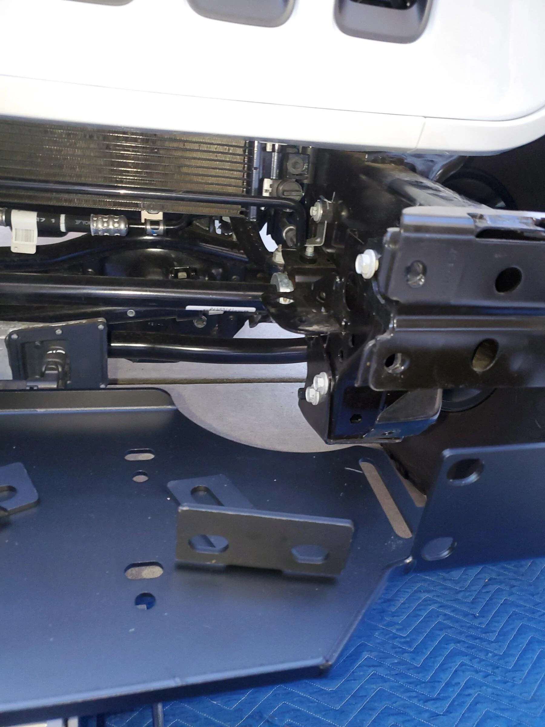

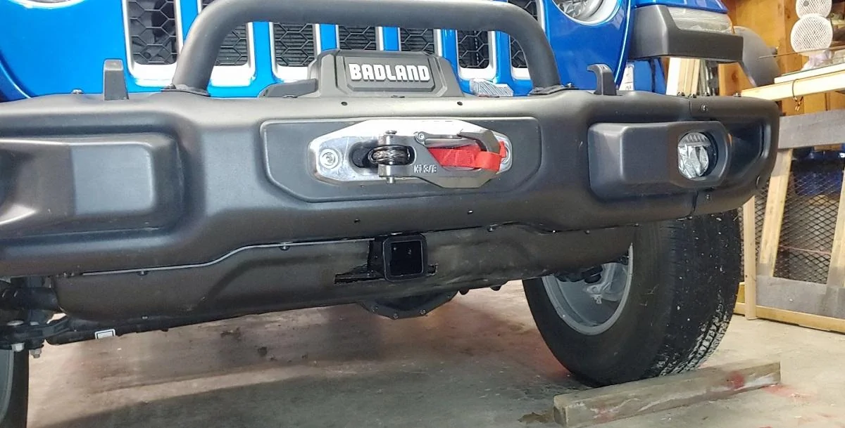

Thx for all the input. The halogen fogs were able to switch over with the brackets they provided. I transferred the tow hooks, wiring harnes, halogen fogs and the screws and bolts that held in the fogs over to the new steel bumper. My only question is the winch plate. I installed it but unsure if i did it correctly. Ill share pics of the winch plate so you guys can correct me lol. The pic of the winch plate with a bracket on it, is that the bracket il supose to install on the insides on the bumper bracket?
Jeep Gladiator Knock off Rubicon metal bumper? 20220512_225102
Jeep Gladiator Knock off Rubicon metal bumper? 20220512_225021
Jeep Gladiator Knock off Rubicon metal bumper? 20220512_225115
Jeep Gladiator Knock off Rubicon metal bumper? 20220512_200845
40,449
53,885
I'll try, do what I can - but these are a puzzle with no instructions and worse, the picture of what the puzzle should look like when completed is missing from the front of the puzzle box LOL.
Consider it a puzzle of a clear, starry night sky.
I found that, assuming even I did it correctly, you may have to do some bracket trimming, the brackets that bolt to the sides of the plate and then to the inside faces of the frame interfere with the lower or rear skid plate brackets.
In your bottom picture, the bracket laying on the winch plate would go on the right side of the vehicle - on the left in the picture.

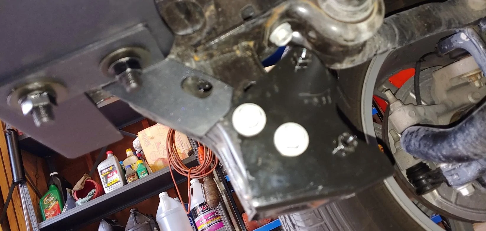

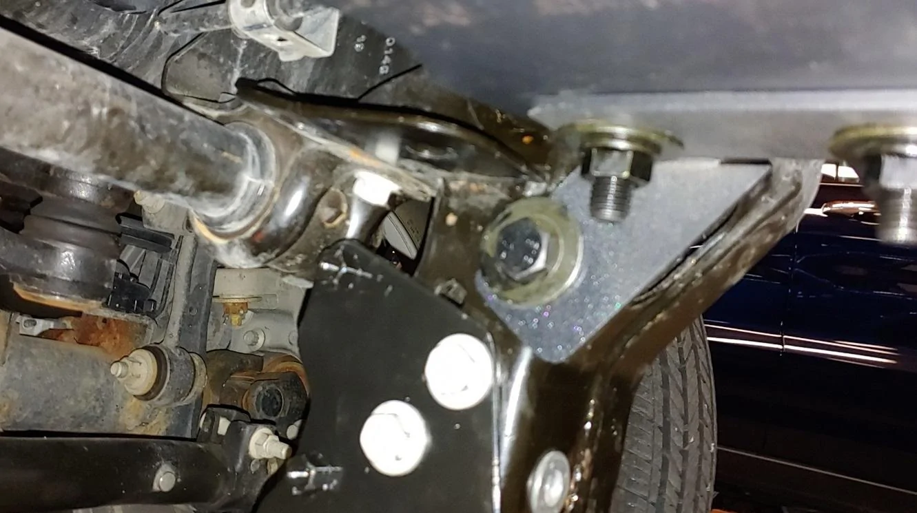

This pic below shows the right side of the truck. The wheel is the right front wheel. The line is where I had to trim the plate bracket to clear the skid plate bracket.
Jeep Gladiator Knock off Rubicon metal bumper? 20201015_162032_HDR

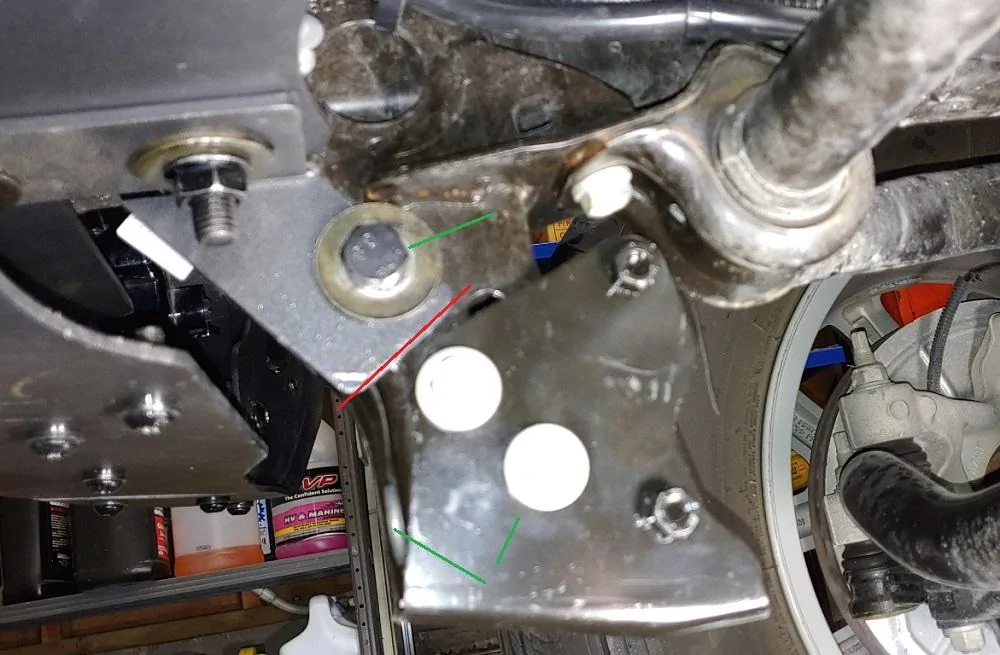

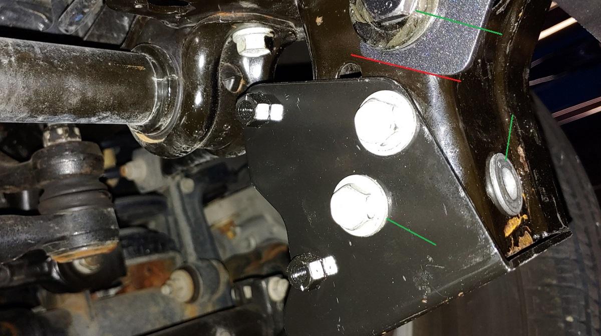

And this is the driver or left side frame rail and brackets. I did a crappy job trimming - they aren't totally even. More clearance on this side. I guess I rushed a bit.....
Ignore the green lines. I put those there for another purpose. The top bolt with a green line pointing to it is the bolt holding the plate bracket to the frame, the red is where I trimmed the winch plate bracket to clear the left side skid plate bracket.
Jeep Gladiator Knock off Rubicon metal bumper? 20201015_162050_HDR
Left/driver side again.
I will tell you, those bolts that hold the brackets to the skid plate do rust - you might find some better bolts or bolts with a better finish. It took a couple of years but the bracket bolts shown on mine are now rusty. So when I move things to my new Gladiator, I'll either replate these bolts when I do the next batch for a customer, or just buy new bolts.

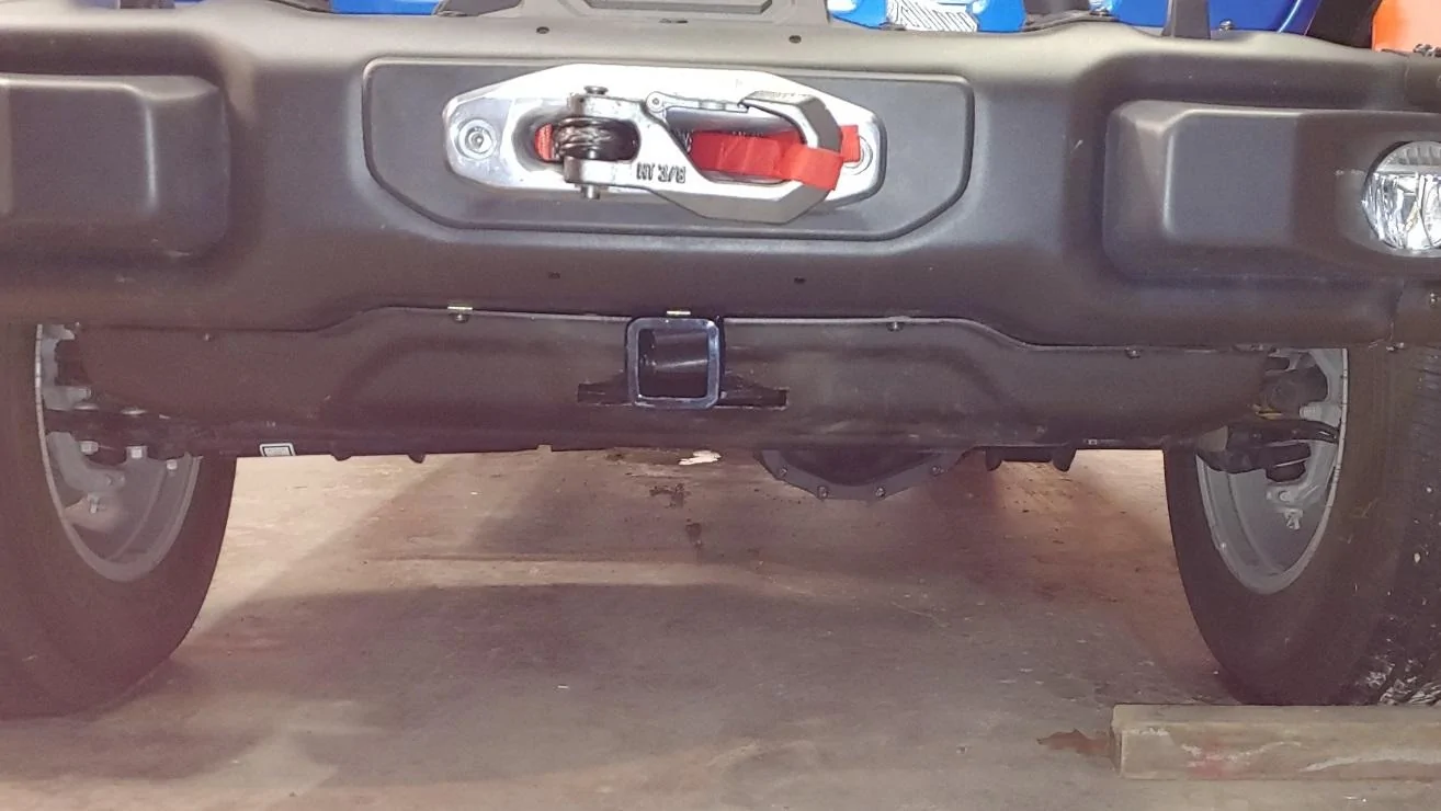

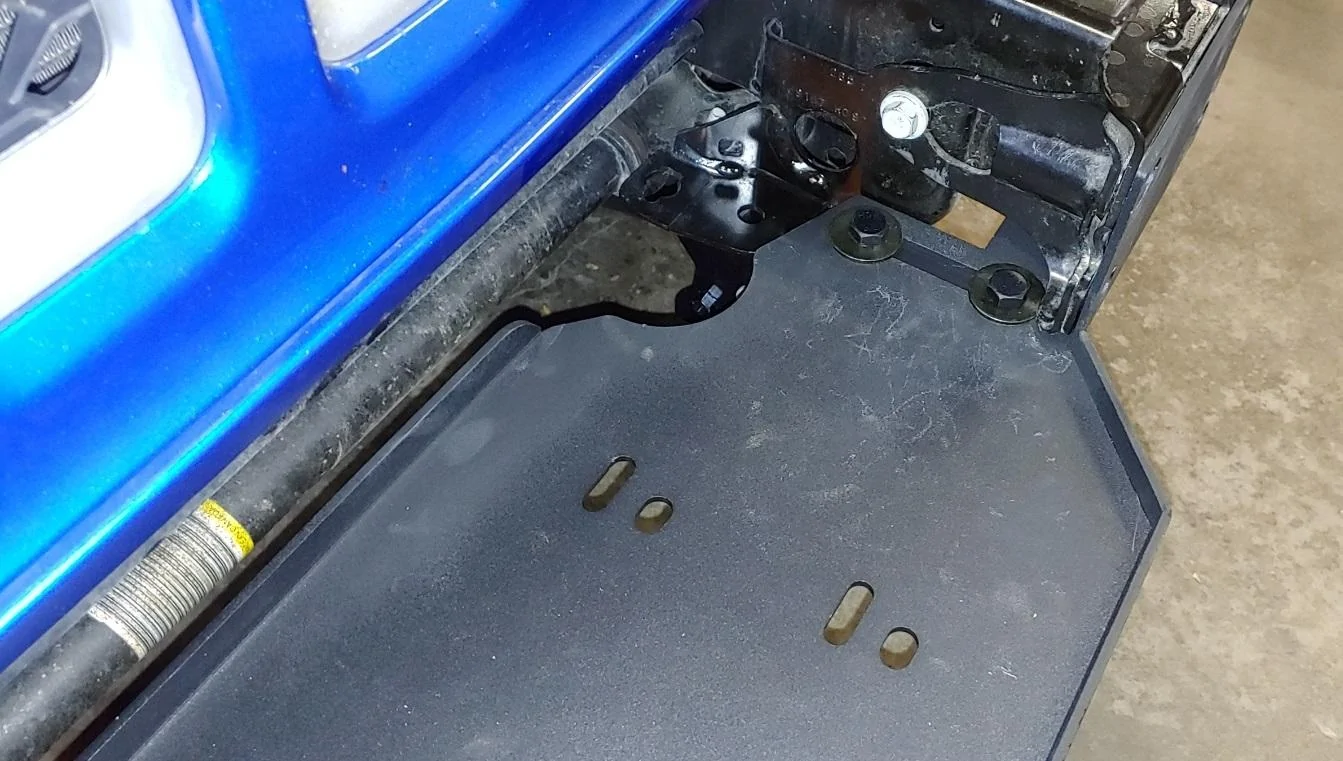

I bought the MOPAR skid plate for the steel bumper. I wanted a front receiver and it just made it easier to trim the skid plate to fit around the receiver.
I have read, or recall reading, that some have trimmed the bumper, then later I read where someone did some slotting of brackets to tilt the skid plate a bit to clear the bumper so they didn't end up having to trim the bumper.
If someone has pics, I'd love to see that solution. Might help a lot of people here.
Jeep Gladiator Knock off Rubicon metal bumper? 20210516_163211_HDR
Jeep Gladiator Knock off Rubicon metal bumper? 20210516_163221_HDR
