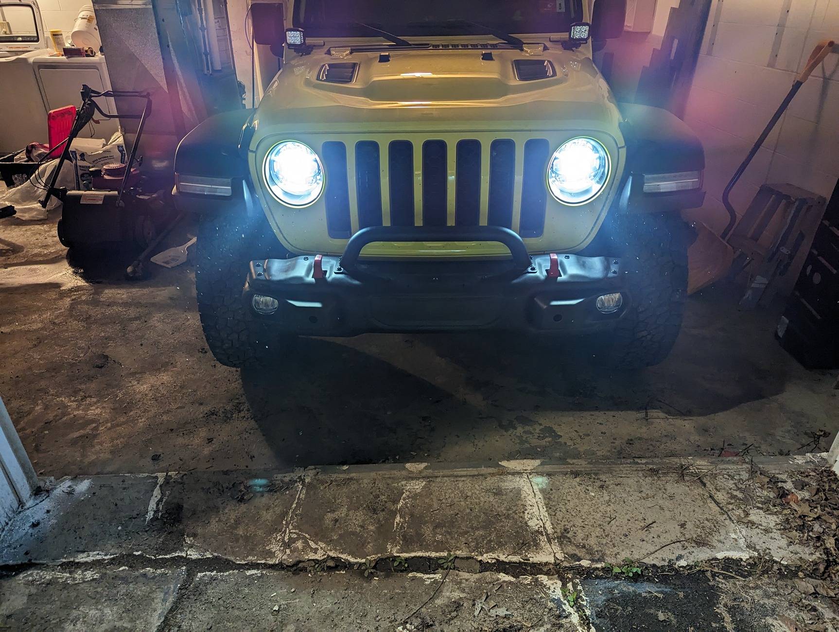

You will also have to cut off the tabs on the opposite side of the fog light, the plastic bumper version has mounting tabs on both sides.
I didn't have to. No messing with the lights themselves at all. The tabs on the other side were not in the way.
I have a pair of the amazon adapters - didn't fit worth a shit. They put the lights too deep. (I have pictures comparing somewhere). So I used the adapters that came with the steel bumper and those worked fine (but they got rusty fast)
Mounting depth is wrong on the Amazon adapters I bought so I tossed them onto a shelf of extra crap I don't know what to do with. May just toss them.

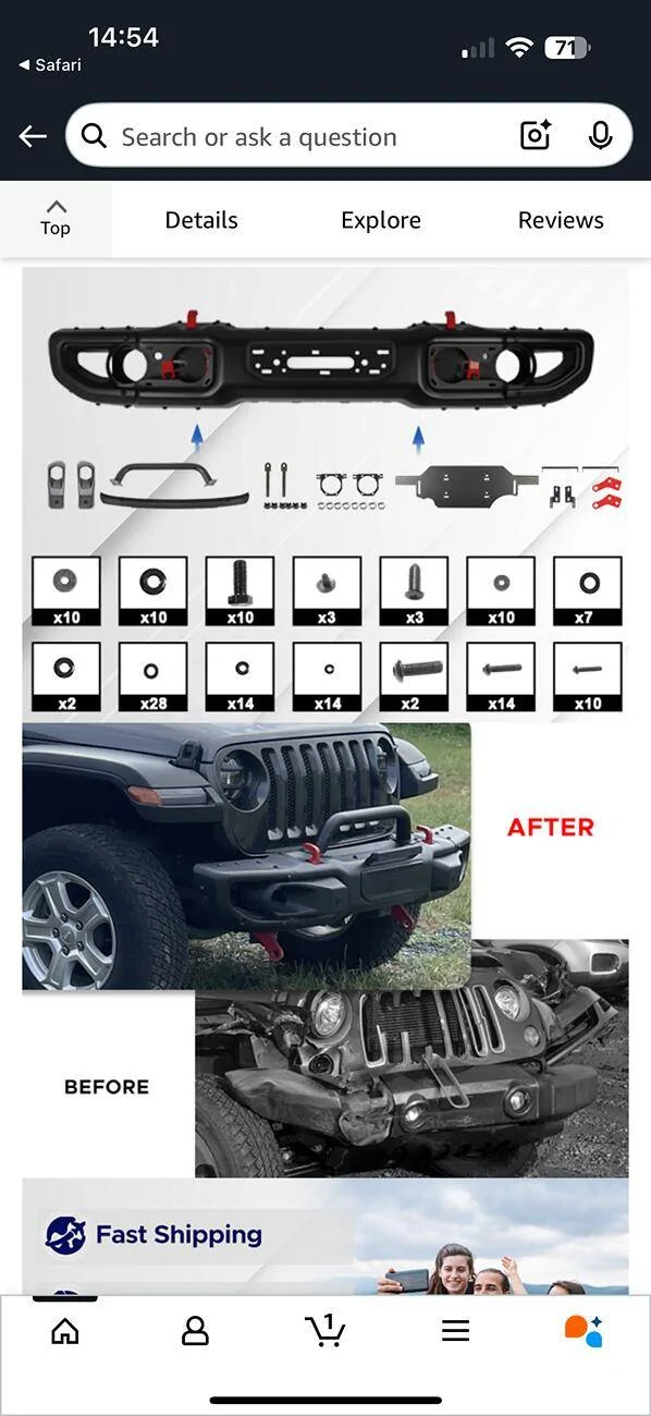

The chinese are getting so good they can turn a wrecked JK into a new JL!
That's the ad of the decade right there.

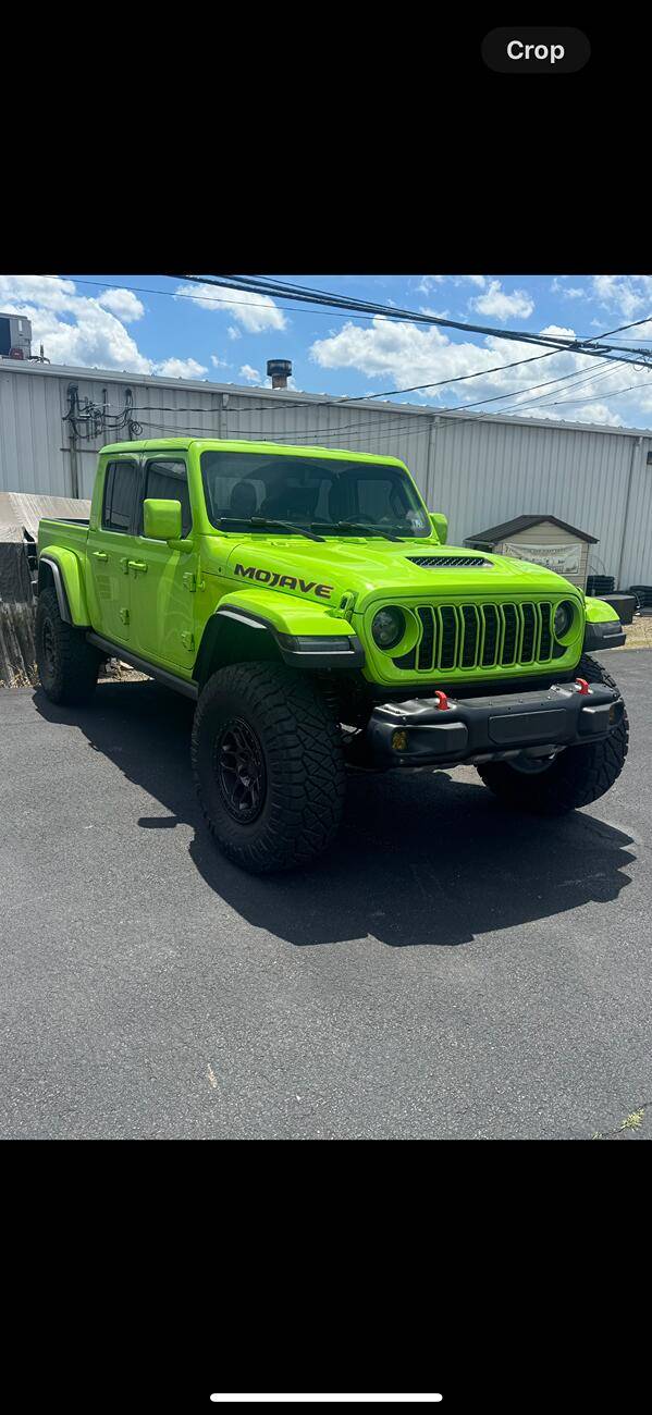

Bought one for my wife’s Jeep, she ended up not liking it so I put it on my Mojave. It’s been about 9 months here in PA and all the bolts lost their paint and there’s rust starting to come through the finish. I know they’re cheap but I figured I’d get a least a year out of it. Currently shopping for something to change up the look.

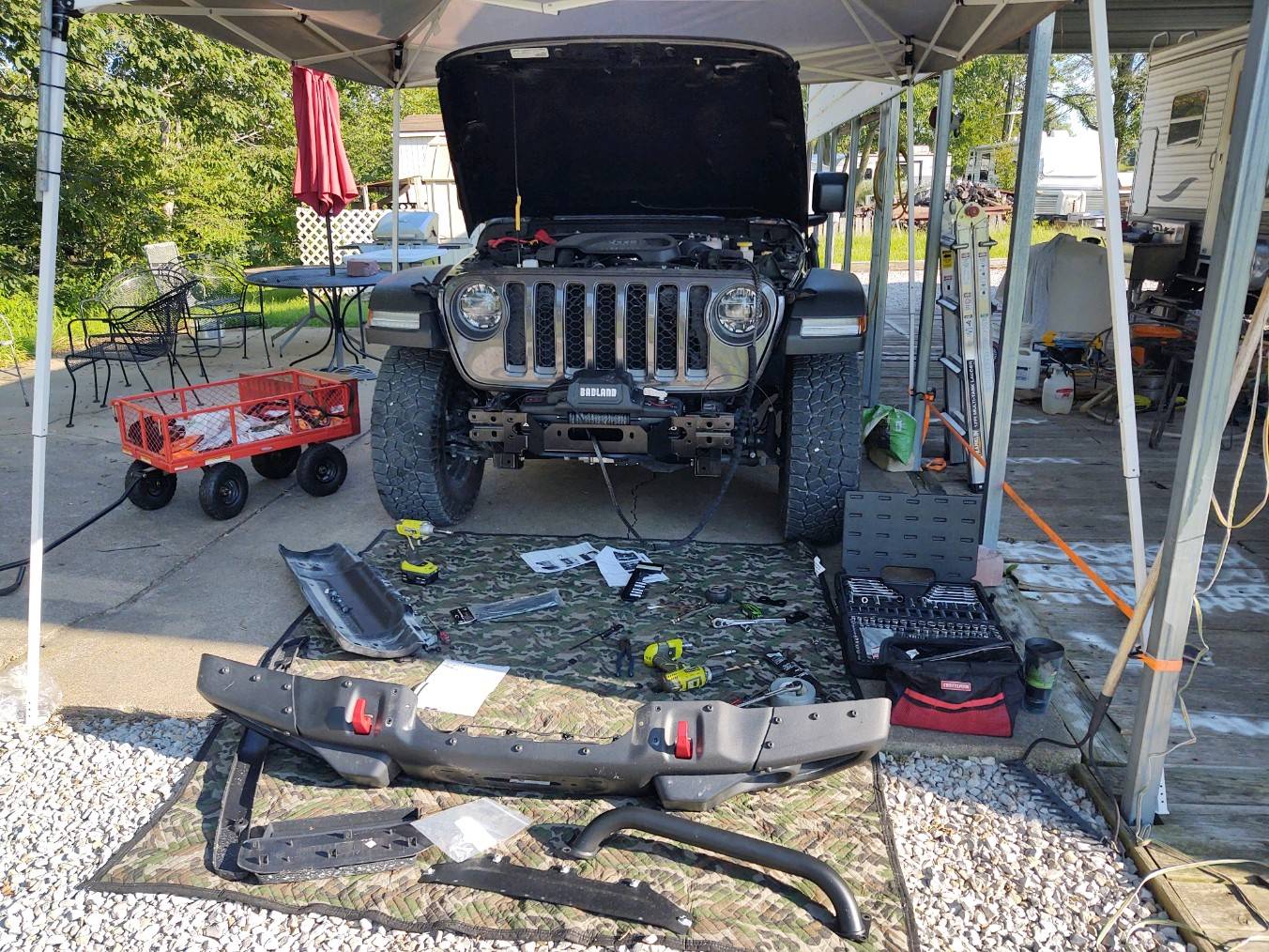

Skid plate needs to be cut up to fit. See earlier post.
She's heavy...we will see how I like it through WV winters. I got the bumper and winch plate mounted by myself.

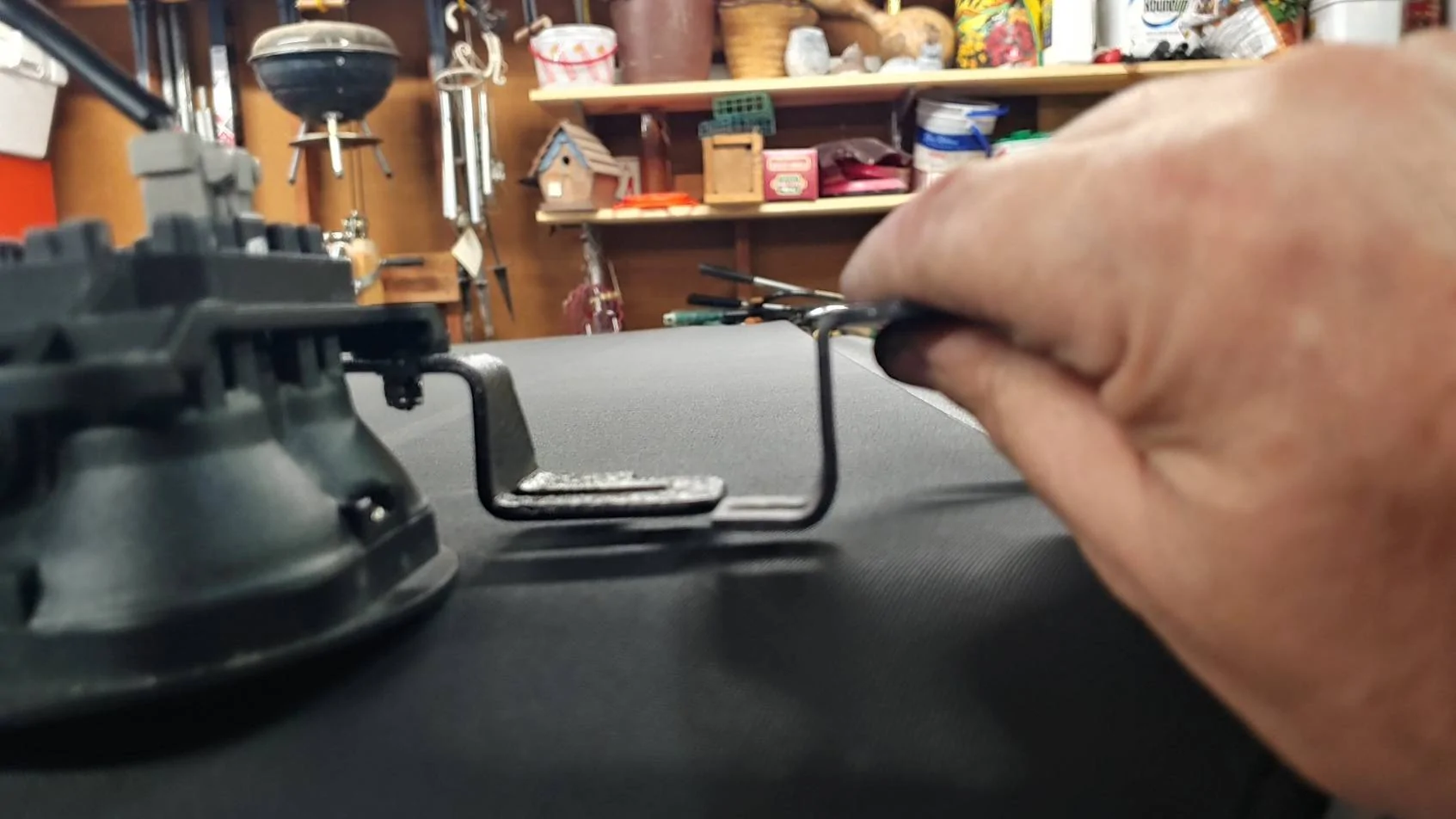

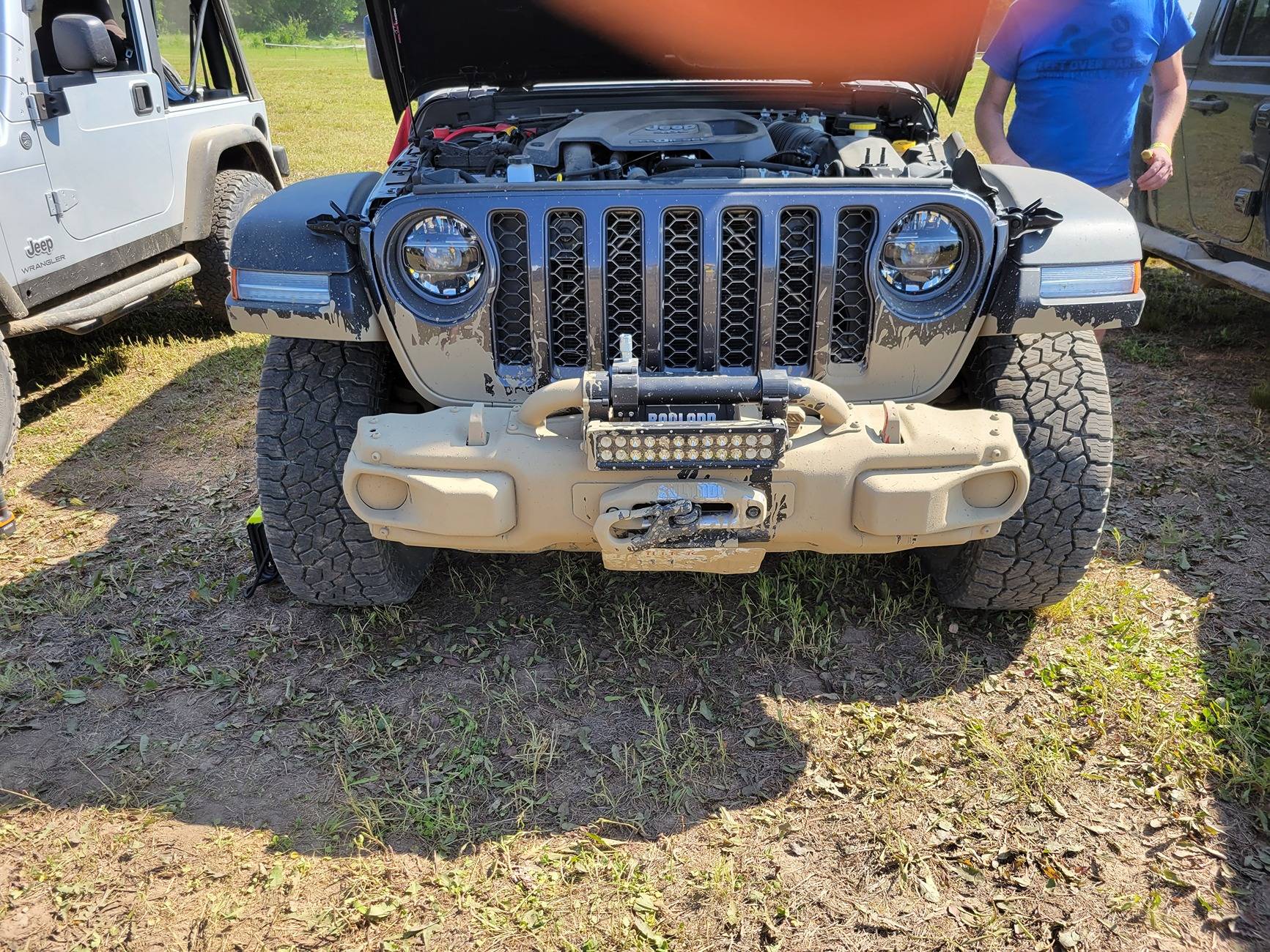

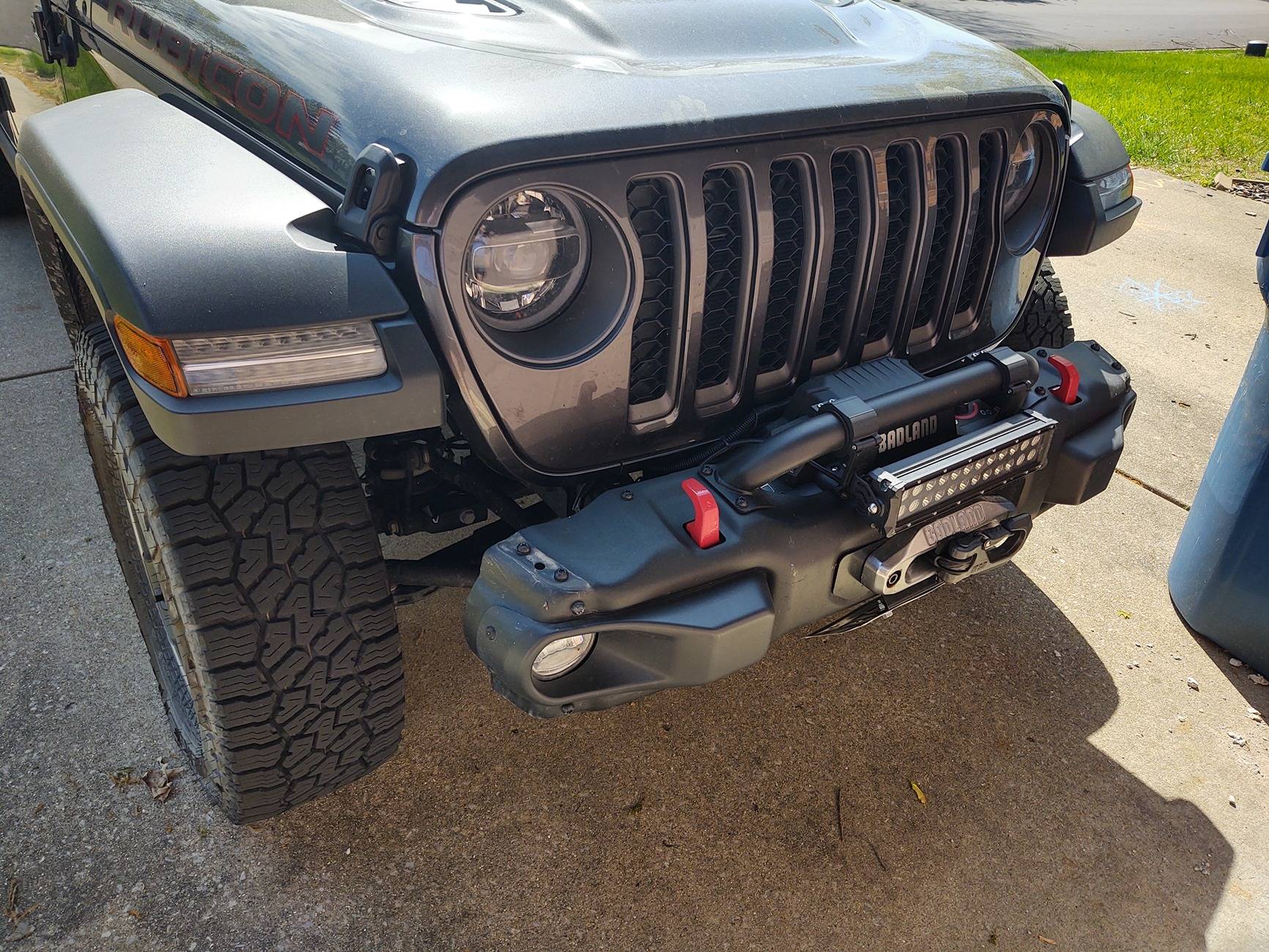

'22 gladiator, with the factory steel bumper and Badlands winch, I did have to take about an inch off the engagement handle. It was the bumper cutout, I've got a bar too. Adding the winch plate took some persuasion....... The factory steel bumpers aren't very thick metal, I bumped a wood power pole turning around and got a bend, it came out really easy with a rubber hammer.
