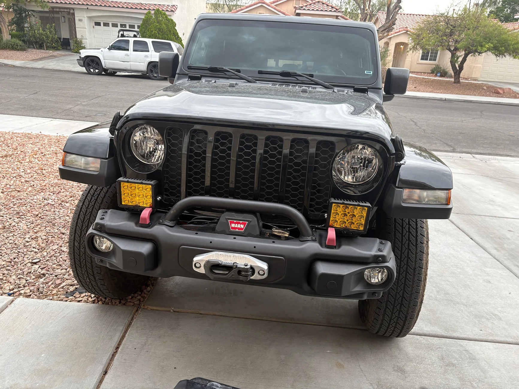

hello, bumping an old thread. Just recently installed this, wondering what you guys are using to cover the exposed holes surrounding the fairlead? ( I have a badlands) mine only came with a plastic cover piece that covers the entire section, I thought about trimming it around the fairlead but not sure.
also anyone using this with a warn evo winch ? Can’t get my winch mounted to the four smaller holes as one side is just ever so slightly off, the four larger holes my winch won’t slide far enough back without hitting the grill. Thinking about drilling out the smaller holes some
Don’t be afraid to drill the holes out just a tad bigger. A step bit works wonders. I also used that same trim piece and but a hole in it after tracing the fairlead hole onto it. Make sure you smooth out the edges because even the slightest burr on the plastic will eventually dig into your winch line if it’s synthetic.
I have a crappy winch but the one time I needed it, it worked for me. I don’t plan on putting myself in a position to winch all the time so I went cheap.
Did you just cut around the fairlead or the bolt holes rope opening ?
Fairlead. The bolts go through the plastic and help keep it in place.

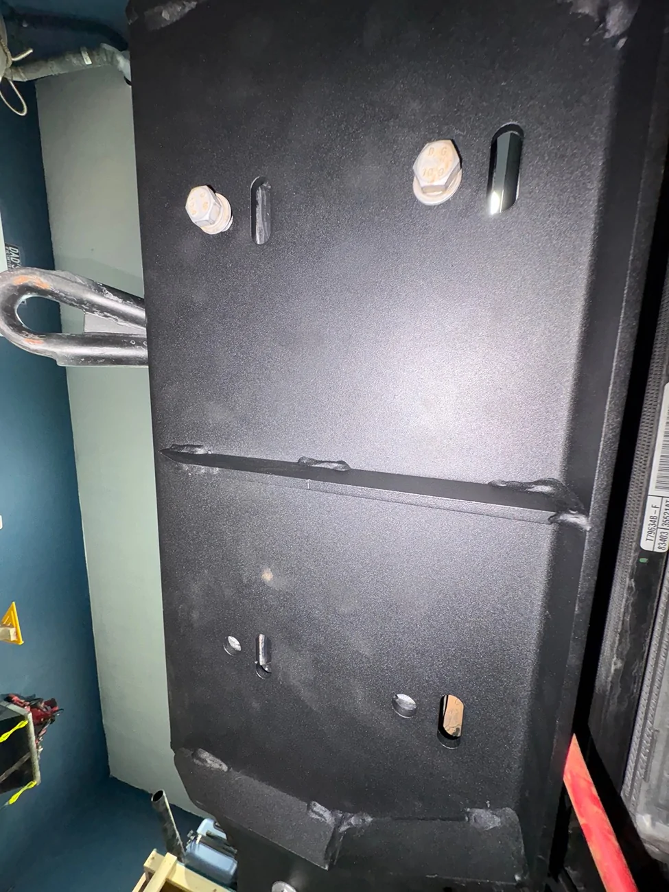

Got everything installed, overall for the 250 I paid for it can’t complain. I did have to drill out the winch plate mounting bolts as they didn’t line up to my warn winch, switched to the factory tow hooks as the included red ones wouldn’t slide into the bumper.
