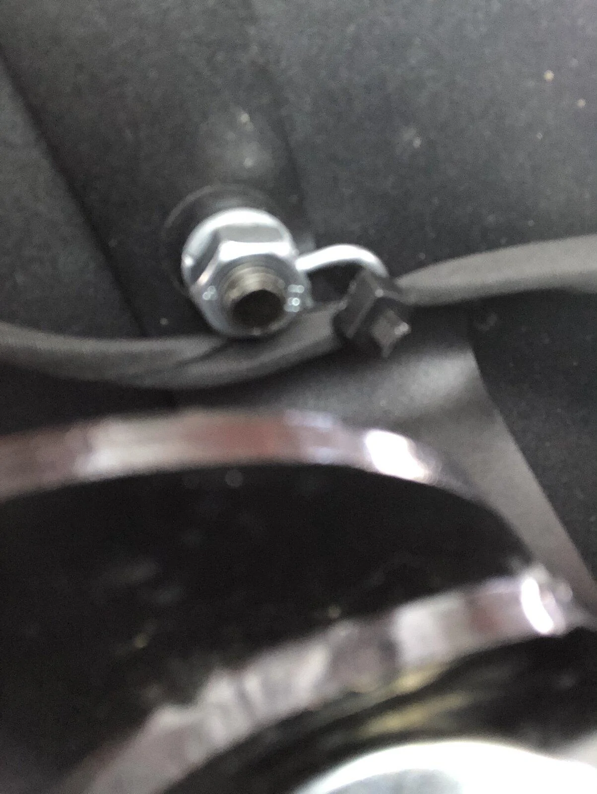

Yes, you must pull the wiring harness from the plastic bumper. There is no provision for securing it behind the bumper. What I did is pick up some of the little light weight “figure 8” shaped chain connectors at Lowe’s in the hardware and fasteners department. I secured 1 end under the washer and nut for any of the many screws in the bumper and used the other as a point to zip tie the wire to. Here is a photo.

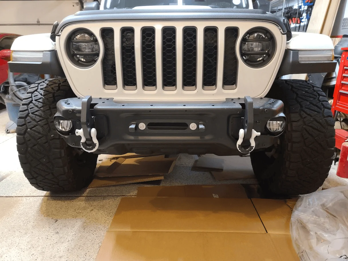

I retrofit the 10A JK copy bumper on mine and found a guy selling Arcus hooks for $60 that I swapped on instead. Some quality short socket head fasteners from McMaster Carr, a heavy coating of PlastiDip and some tinkering to mount my factory LED's and I was in business. My wife especially likes the Rhino USA white "earrings" I added.

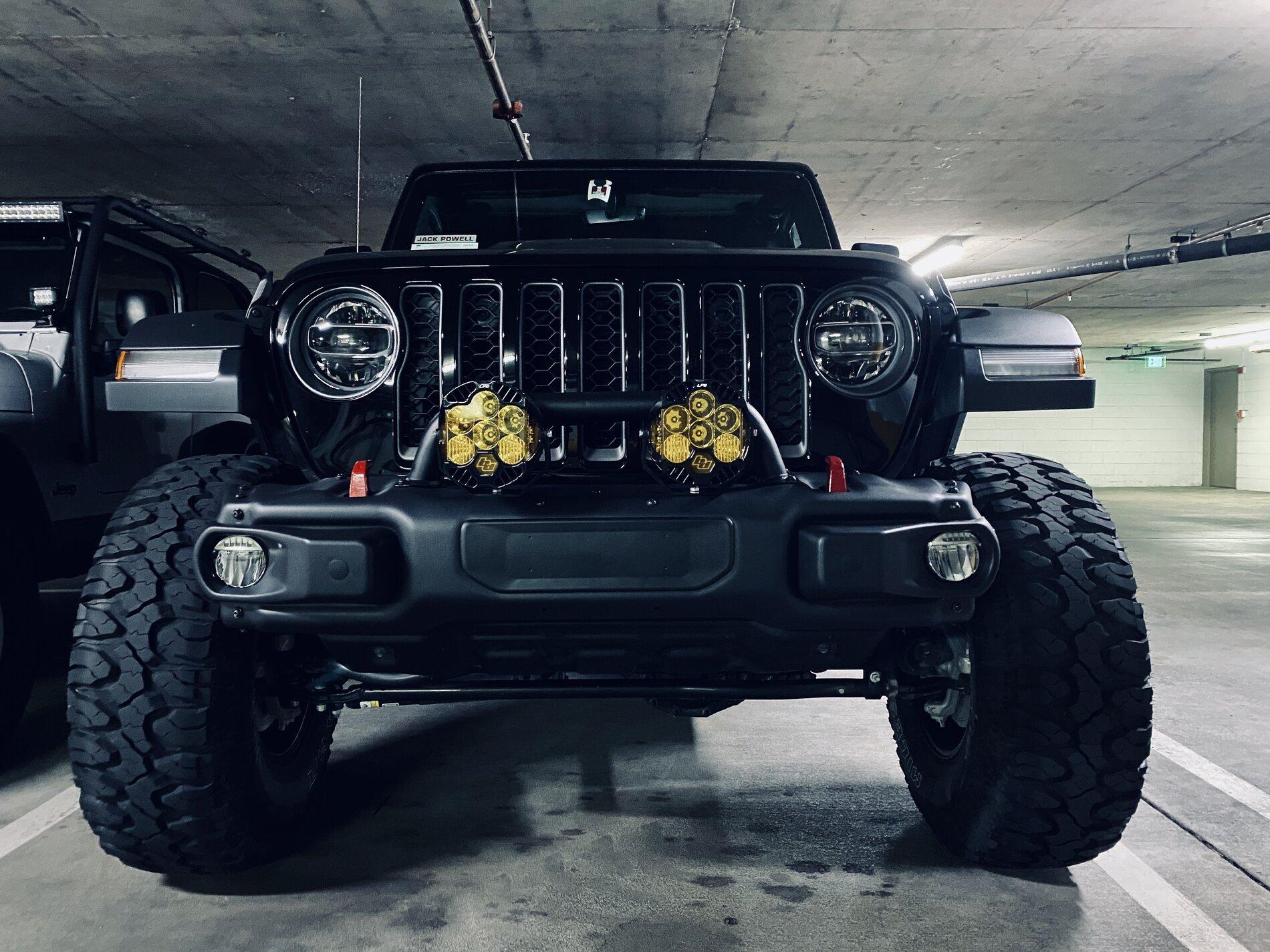

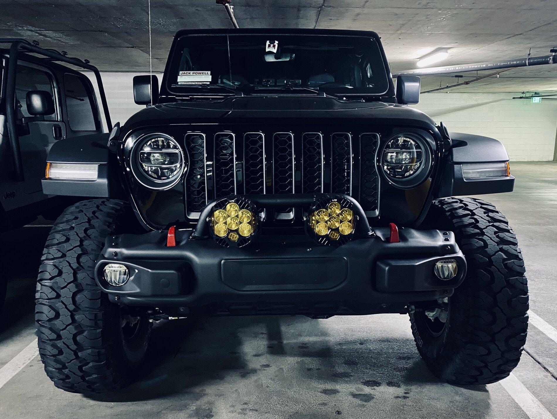

I have it and looks pretty good , bolted right on to the factory Rubicon skid plate from my plastic bumper . Kept it stubby mode with winch plate installed but now winch . The back side of the bumper is a little to exposed to the elements so something to keep in mind . Paid like $460 from amazon
