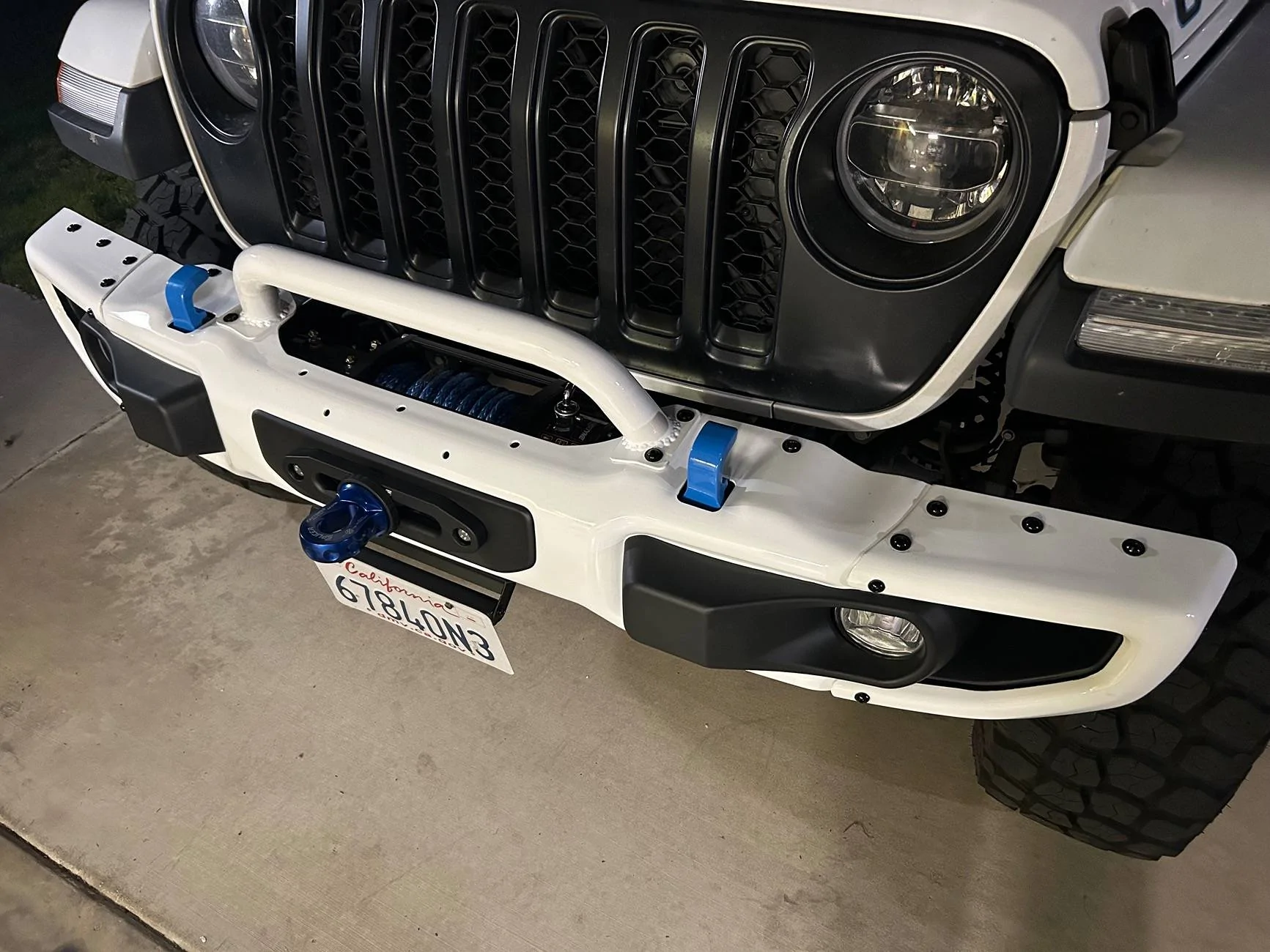

…. @Camaroboi13. Mind sharing cost of powder coat?

It’s been a minute but I want to say it was around $225 for the white bumper and blue tow hooks. I completely disassembled the bumper and gave them everything in pieces, then sorted out new hardware for contrast when I put it back together. I plan to do the same with my steel rear bumper but not before tearing up the stock one in Moab next month 😂

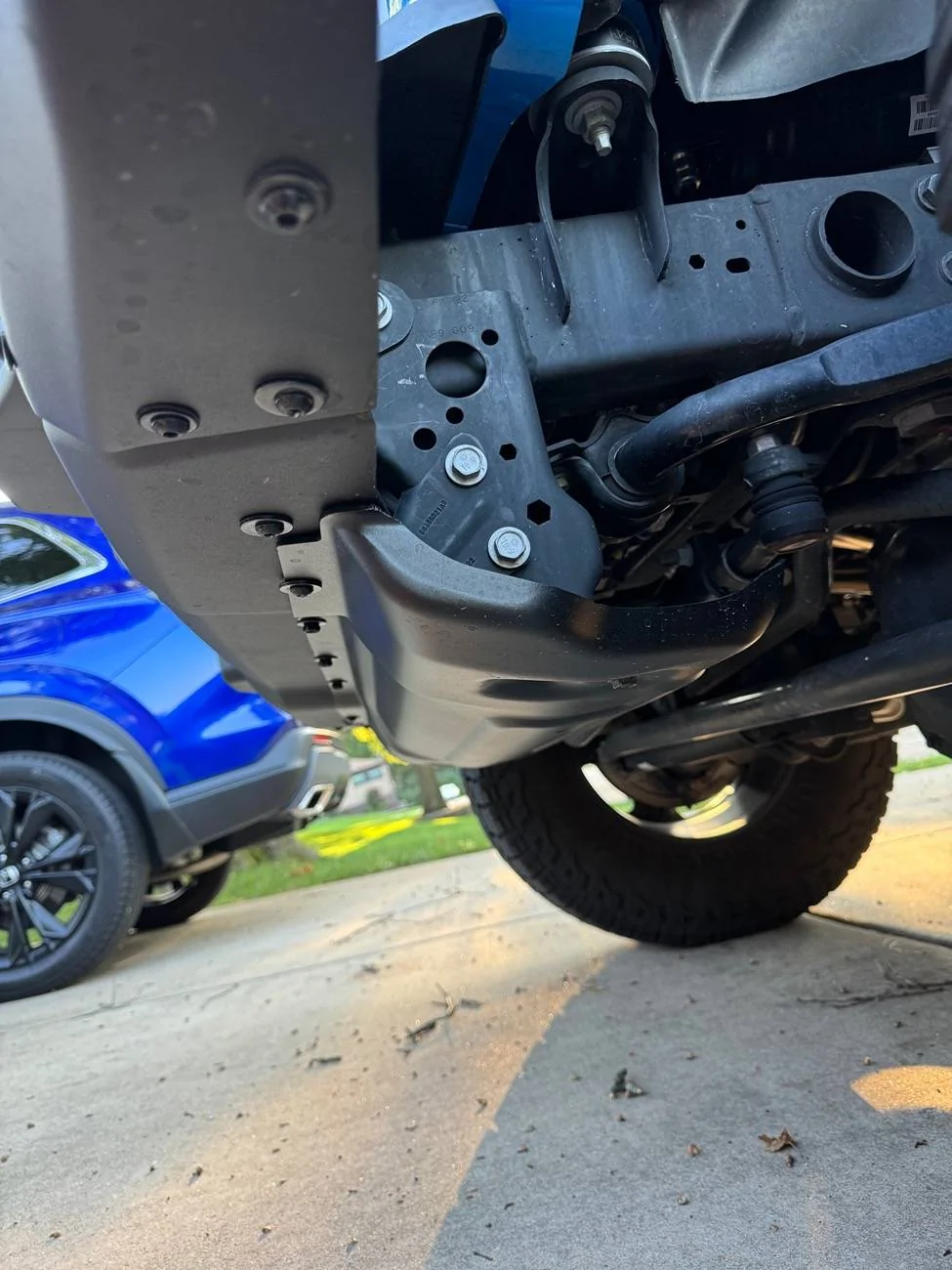

Here is how the steel bumper skid plate mounts.
Yeah, that whole extra bit bolted the underside of the bumper is just not present on my steel skid. Have a big gap there, which is why I initially thought it might fit. But then I suppose the skid isn't really doing skid plate things at that point.

The stock plate will bolt up on the bottom bolts only, but it hits the bumper….and with only two bolts it probably wouldn’t hold up too long off road.
That's a good price. I also disassembled mine and took it to a powder coating shop and they gave me a quote of about $800 for black. I took my parts (bumper) back and used bed liner spray. It's coming on 2 years and it's been holding up well.

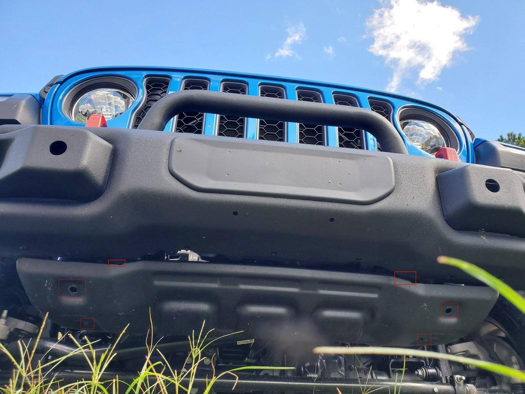

I've had mine almost 4 years now. I posted in this thread https://www.jeepgladiatorforum.com/forum/threads/mopar-steel-front-bumper-ebay.35220/post-587103 how I stripped it and applied bedliner to it when I got it. It still looks as good as the day I installed it.
Someone on page 1 was worried about using it to winch from. The winch plate is attached to the frame rails, so the bumper is taken out of the equation.
It looks like we have the same skid plate (plastic OEM bumper)? If so, you will need to do a little bit of trimming to the bumper to be able to use the skid plate. There's a post in the above linked thread about it.

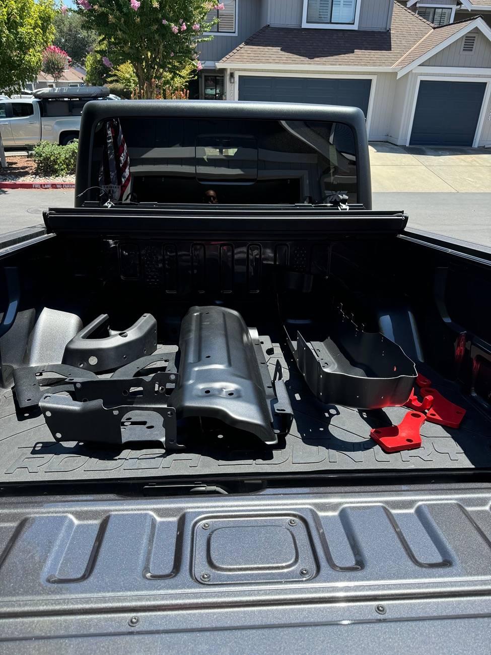

Took everything apart today. Ready for powder coat 👍🏽. Wholly cow… Tons pieces. Hope I can remember how everything goes back together! Took lots of pics! 👍🏽
