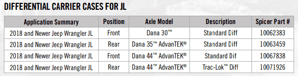

Building short quick reference sheet to cut and carry and cut and paste. Question , Sport w Max Tow. Manual on Page 232 has 2 different options for rear 44. M200 Sales code (DRZ) and M220 Sales Code (DRE/DRF). I can't find these sales codes anywhere.
Is the M220 the 4.10 rear I have? How can I identify between the M200 and M220. Does the M220 have a trac-Loc, which Max Tow does not and the M200 just the plain 44?

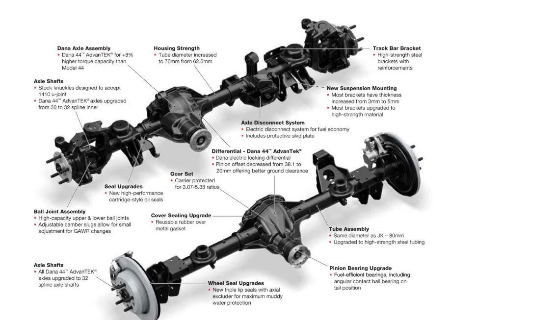

Dana- Spice AdvaTec. Did you know we have a front axle disconnect?

Dana- Spice AdvaTec brochure attached.

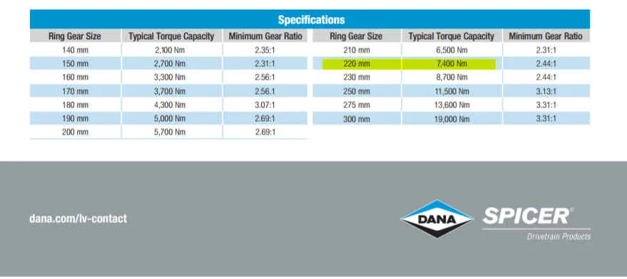

Interestingly, even though the JL/JT ring and pinion is smaller, Dana said it is 8% stronger.
