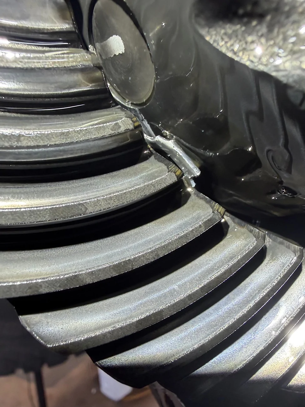

So I have a 2020 Max Tow with just over 80K miles. Of those miles, most are highway, perhaps 7.5K of them towing trailers ranging up to 3600 lbs. I had the diff gear oil changed by a dealer at 40K, and after seeing the price, changed them myself last week at a bit over 80K. There were stamped metal fragments clustered at the magnet, maybe 5-6 of them, the largest maybe 2 cm by 1 cm. My truck has an open differential, runs 34" tires, and these looked like pieces of a bearing cage. The truck is currently exhibiting no weird noises or any other symptoms of rear differential trouble.
I'm relatively new to the town I'm presently in, but there's a Jeep dealer less than a mile away that came recommended by an acquaintance. So I dropped it off a week ago, poured the metal fragments into the service advisor's hand, and asked that they have a look and offer some options. I also asked that they reuse the gear oil if it wasn't contaminated, but was told that that wasn't an option.
After seven days on the lot and several calls from me, I finally got a voice message. "There are metal fragments in your rear differential. We recommend replacing the unit. Cost for a refurbished unit and install is $6031 plus tax. Let us know if this is something you want to do."
So I already told them there were metal fragments in the differential. Not sure why it took 7 days and a $392 bill ($150 for 2 quarts of brand new Mopar fluid going into a differential they recommended replacing b/c they wouldn't reuse my "old" fluid) to provide me with this single option, the simplest and most expensive solution.
I've located a shop nearby that specializes in regearing trucks close to me, Outlaw Offroad in Madison, Alabama, that is willing to have a look at it. Anyone here have any experience with them?

I have been told that the cages can come apart and some people are recommending changing to old style roller bearings instead of the ball and cage stuff... if you have it rebuilt, check into it. I think the bearings that fit are the same that they put in the Ford bronco rear end. I would thing the whole thing could be rebuilt for around 2500.

It is always easy to say you should have pulled the cover off and inspected it yourself but of course you had no way to know until afterwards. The dealers near me are just as bad best thing about most offroad shops they usually do a lot of differentials probably are better at it than a dealer who would rarely do anything but a basic gear oil change and the brakes. It would be good to find someone upgrading axles but that rarely happens when you need it. That does suck you never know the real cause of some failures a defect in the bearing, lubrication issue or foreign debris that broke loose or floated from somewhere. The biggest part of the job will be getting all the debris out.

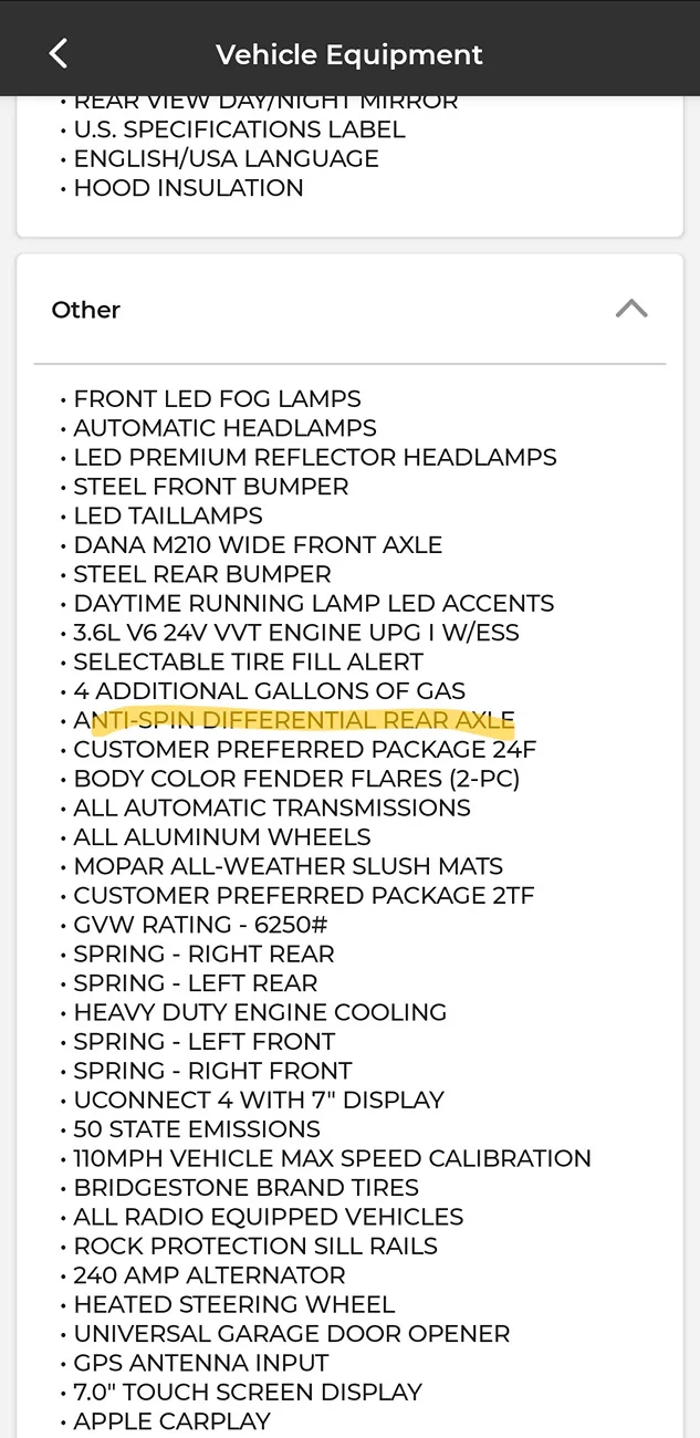

If you have a MaxTow, that rear diff is NOT open/unlocked. It's the "Anti-spin" diff aka a clutched LSD (fails open though).
The LSD rear diff was not standard in a 2020 MaxTow, mine didn't come with an LSD.
ALT2870

I think there was some 21's as well that don't have a rear LSD. If you have the Jeep app you can see what you have, the LSD has been great for me. I'm sitting on an Eaton locker for the front. Might just wait till the 5 year ends here in the Fall.

Just take it to a non dealer shop and have them pull the carrier and pinion, It's likely the bearings in the pinion have gone bad, but in doing so they damaged the carrier bearings too. The gears are likely fine. Cars cost money, shit happens. I would think replacing bearings would be less $1500 if no other damage is found. If you are happy with how the jeep works for you, then ignore all the folks telling you swap to a limited slip carrier or swap in rubicon axles. All those things are going to cost money too and if you are not willing or able to do it yourself then it's going to exceed the cost of a bearing replacement job.
Here is the rear pinon bearing upgrade kit to go back to a standard tapered bearing instead of the weird new ball bearing design. Talk to the shop doing the repair first to get their take on using this bearing, some shops might not want to deviate from OEM design.
https://trailforged.com/product/jl-jt-rear-m220-axle-bearing-upgrade-kit/
