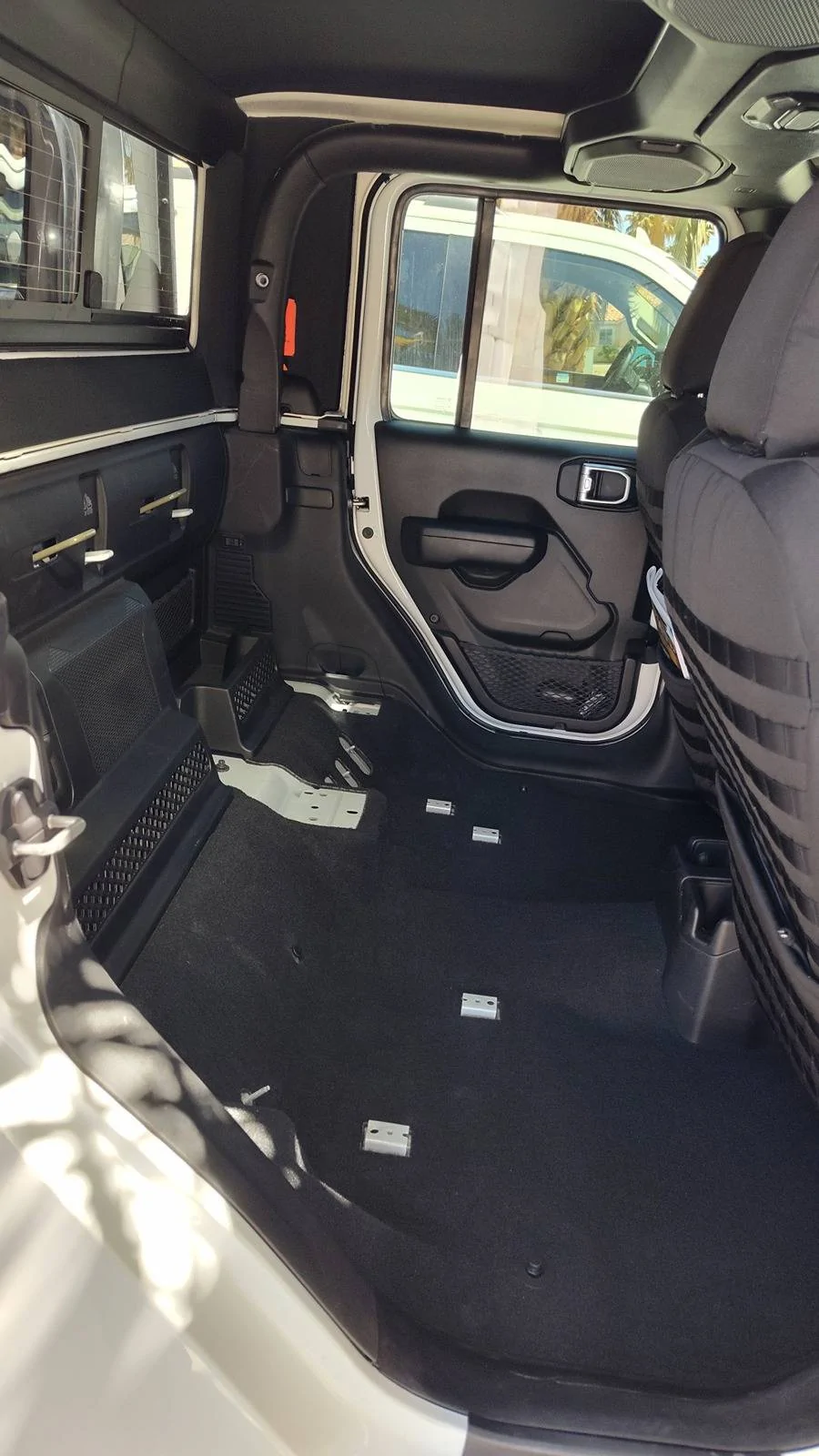

I have a SHW Offroad rear seat delete kit arriving this week, so I figured I'd get a jump start with removing the seats and belt retractors. Also since I'm trying to keep my build under the max load rating, I'm keeping track of the weight of all things I add or remove from the Gladiator. I haven't seen weights of the seats posted elsewhere, so figured I'd share for anyone else that may find this information useful. I have the cloth interior. I reinstalled many of the bolts to keep holes plugged - someone that was VERY serious about weight savings could probably save an additional pound or so by plugging the holes with sealant rather than reinstalling bolts.
Here's the weight of the various components I removed, as weighed on a digital bathroom scale.
60% Seat - 50.2 lb
40% Seat - 35.4 lb
Belt Retractors (total) - 4.8 lb
Rear Floor Mats (total) - 4.8 lb
Removed Misc Hardware - 1.0 lb
Under-seat Tray - 4.6lb
Total - 100.8 lb
The seat retractors were probably more work than the seats themselves. They're lighter than I'd expected, so maybe not worth the effort.

Smart thinking! I had a thought of a fire extinguisher mount, but I think eye bolts would end up being more useful, since there are plentiful options for mounting a fire extinguisher anyway.

I took some notes when I had mine out, might as well share here too:
Left 40% seat 36.08 lbs
Right 60% seat 57.68 lbs
Locking under seat box 16.52 lbs
(Total 110.28 lbs)
Cloth Rubicon seats (no idea if trim matters)

I started to remove my 60% rear seat today using a breaker bar on the four bolts and started stripping the bolts. Did you have any trouble with the bolts?
The bolts have an "inverted Torx" head, size E14. A 12pt 11mm socket might also work in a pinch, but with all the threadlocker on those, you're probably best off picking up a set of the inverted torx sockets to get them out. I used a 1/2" drive ratcheting breaker bar that's about 20" long for leverage on the first few turns.
Edit: that's not the only place the inverted torx bolts are used on the truck, so you'll probably be happy you have a set if you get into other projects as well.
