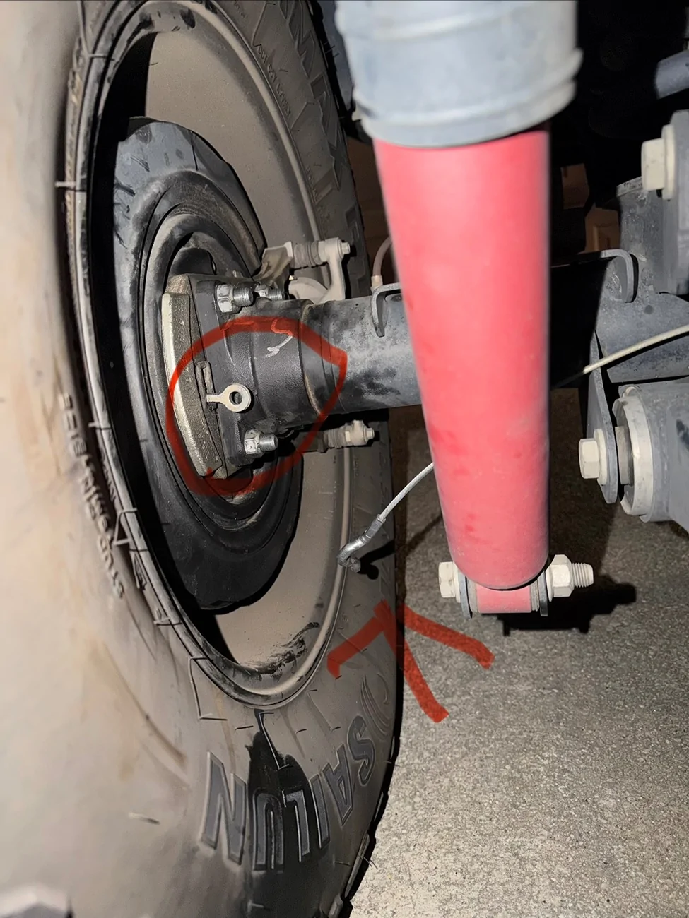

Got my axle seal replaced at my local dealer and upon inspection when I got home, found the rear ebrake cable unattached. Any tips on getting it reattached without removing the wheel? I don’t want to drive to the shop on my day off but I can’t seem to get it reattached while on the ground. I have access to a lift for free, it’s just at my job and I’m trying to avoid that place today.

Loosen the backet that holds the cable that may give you some slck

That’s what it took. I couldn’t commit to the force it would take to get it out. The bracket is welded to the frame so you have to push the brake cable out of it while holding the retaining clip. That gave me enough slack. Giant screwdriver later and it was back in the bracket.
