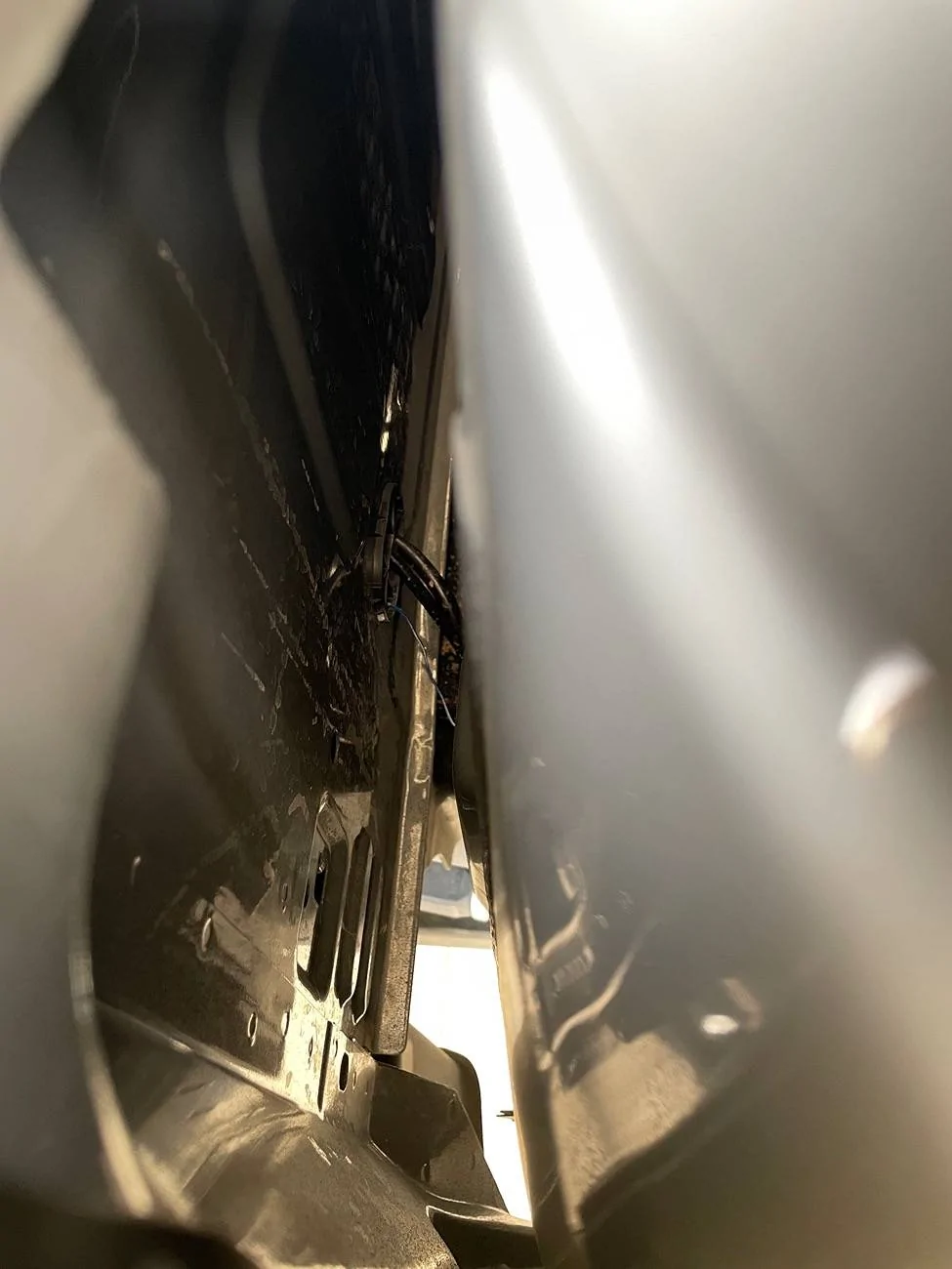

Where/how did you get your main power from the front into your bed? I'm doing a similar setup and am wondering how others are running the main leads into the bed. Thanks!
I ran them into the truck bed thru one of the holes in the lower corner passenger side of the bed. The attached photo is of between the cab and truck bed.
Jeep Gladiator Redarc house Battery setup IMG_8330

interesting, i think those are covered by my bedliner...
Might be … I have a factory spray in liner and they did a great job of keeping all bed penetrations

it was! thank you again. I just had to use a knife to cut around it. perfect!
