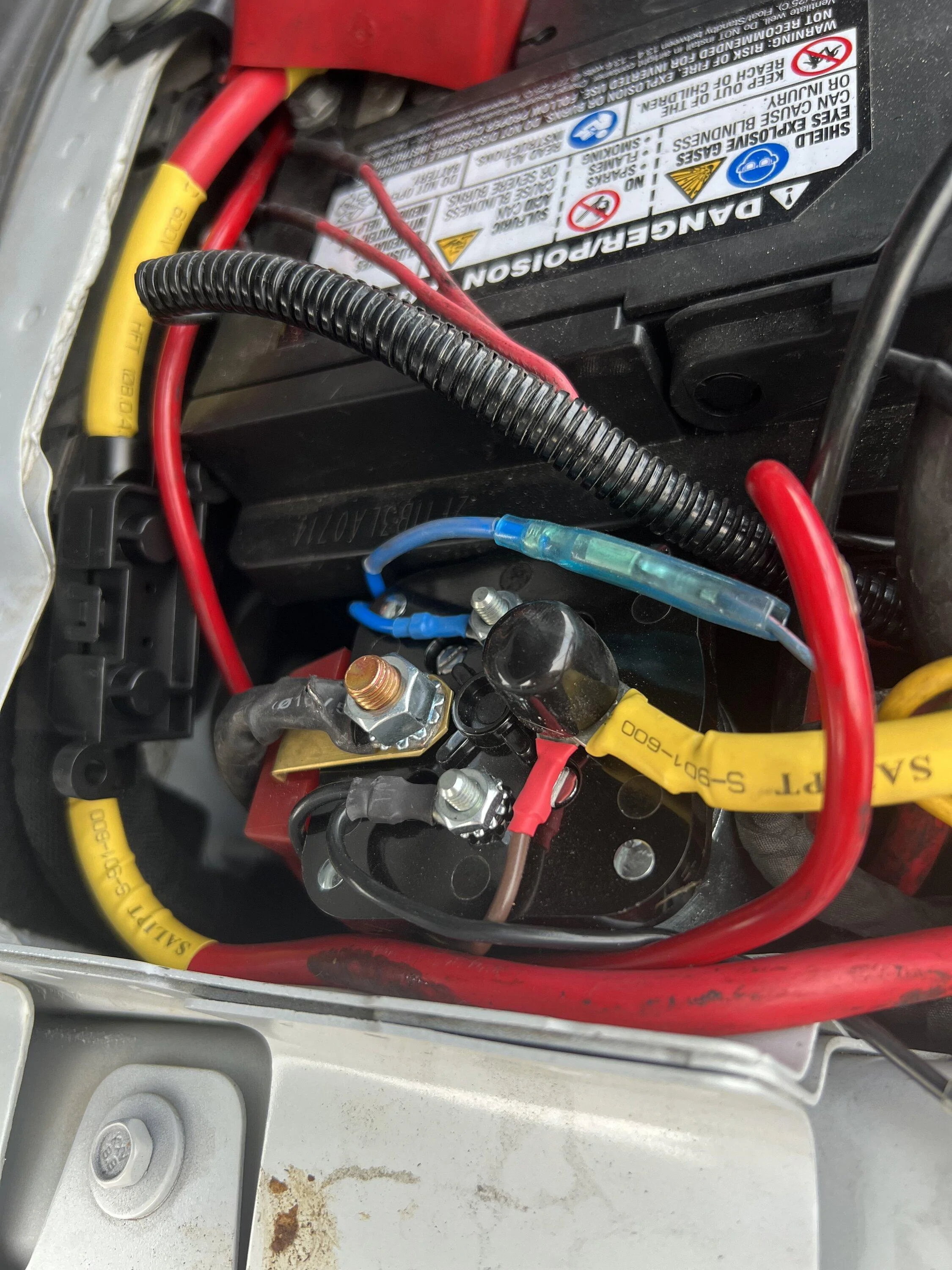

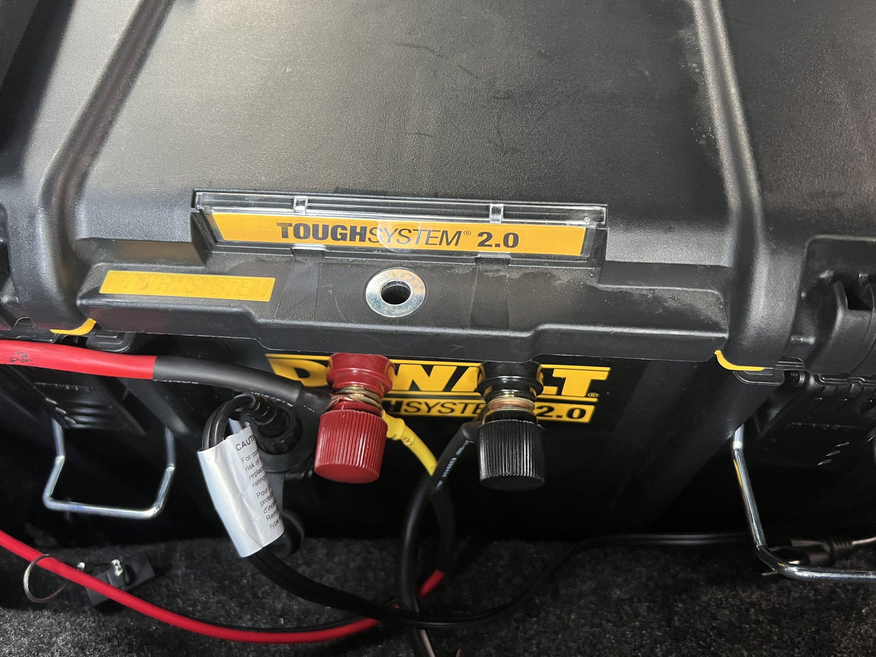

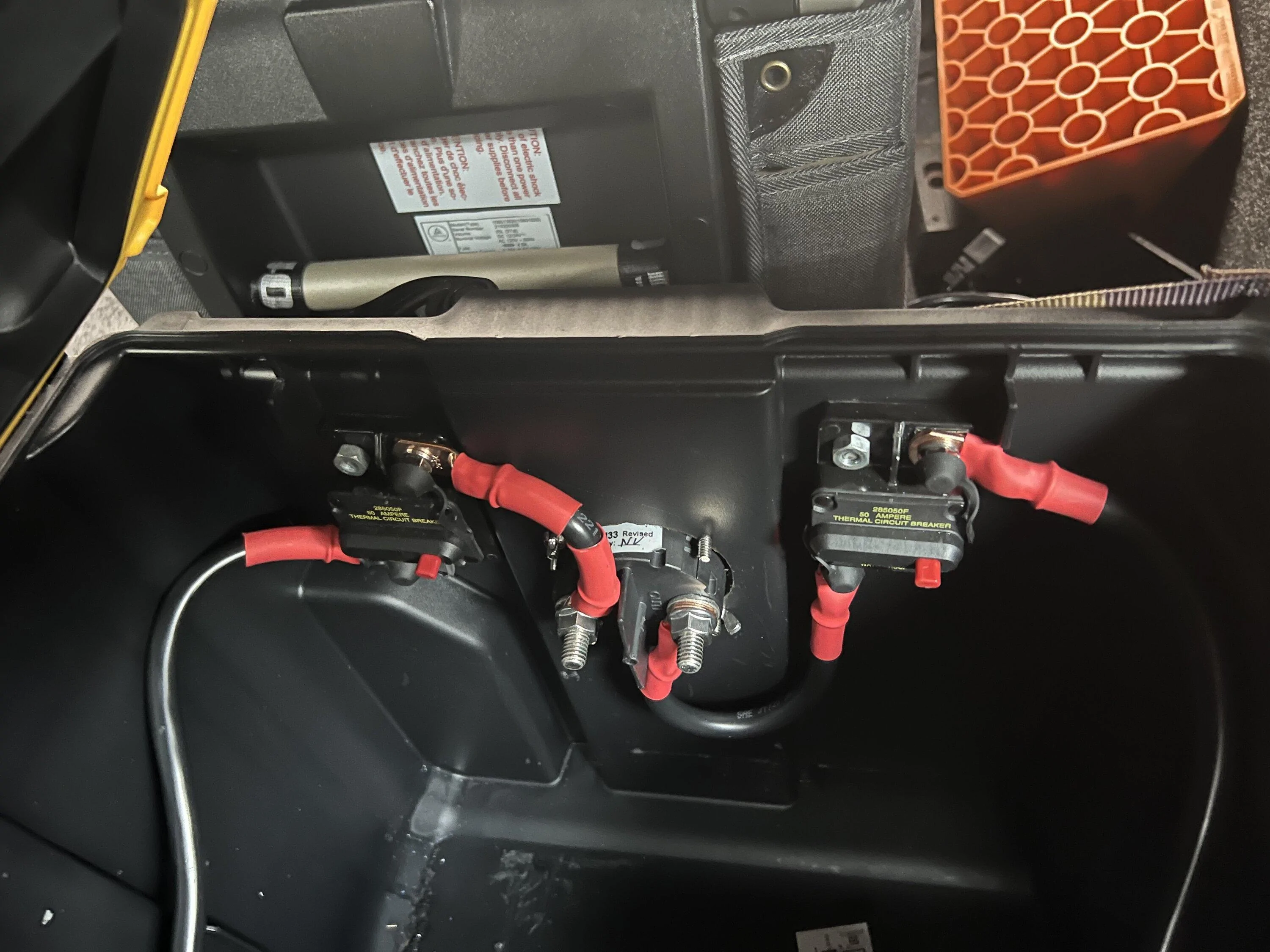

As the subject says, I have an REDARC SBI212 (not the D - dual sensing version). I bought it several months ago, but procrastinated on the install until last weekend. I followed the installation instructions and put the 40 amp fuse in-line between the starter battery and the SBI. The SBI is then connected to a custom made battery box with a 100 AH Battle Born 12v battery (with two circuit breakers and a main switch between the SBI and the battery)
Here’s the issue, our gladiators have a computer controlled alternator that ramps up and down output depending on engine load and starter battery voltage. I very rarely see the voltage above 13.8v which is the minimum connecting voltage for the SBI. As a result, my Battle Born battery rarely gets charged.
Am I missing something? Does everyone deal with this? Is there a way to force the alternator to produce peak power? Currently, I have the SBI Force-connect wire (blue wire) connected to AUX-4 switch and I use to activate the SBI if I want the battery charged. But the alternator still only produces excess power (I.e. more than 12.8v) if the computer tells it to.
The only consistently connected power draw is an ARB 37qt fridge that I have set at mid-battery protection and 36*F.
Do any of y’all have any ideas about how to make the SBI/alternator work better? Or are my expectations too lofty for this setup and I just need to go to a battery to battery charger?

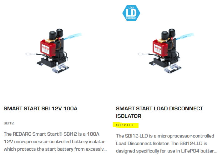

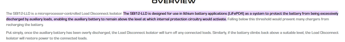

So I am just taking a stab at this for you and I can delete this post if it's false, but the SBI12 is NOT designed to work with Lithium batteries (which I ASSUME is your Battle Born)
I think you'd either need the SBI12-LLD or a designated charger like the BCDC1225. It doesn't seem that the SBI12D supports lithium either... but at least it's designed for true dual battery heavy duty application.

you’re right. It’s not intended for lithium.
“1. Only use the Battery Isolator for charging Standard Automotive Lead Acid, Calcium Content, Gel, AGM, SLI or Deep Cycle type batteries.”
