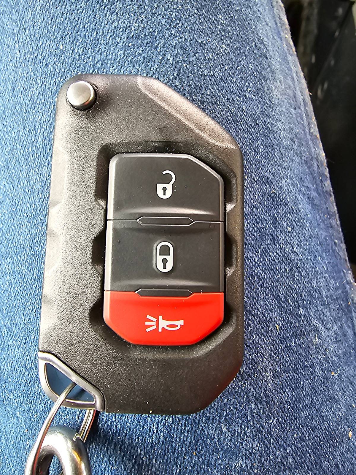

Mine on the Gladiator uses the LOCK button x3 presses on the OEM fob to start it. Wife has the actual button on her FOB that she has to press x2. I didn't install mine but my understanding was there was just one unit/harness that splices info factory connectors. Plug and play.

Mine will do the three lock thing as well, and the factory remote start still works with its normal button. But I always do it from the app on my phone.
