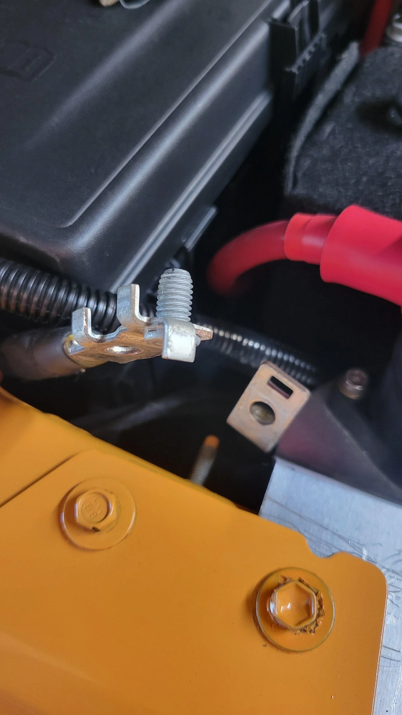

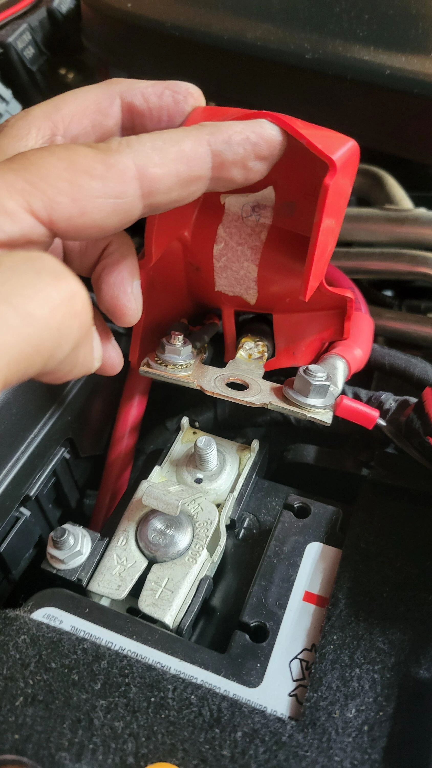

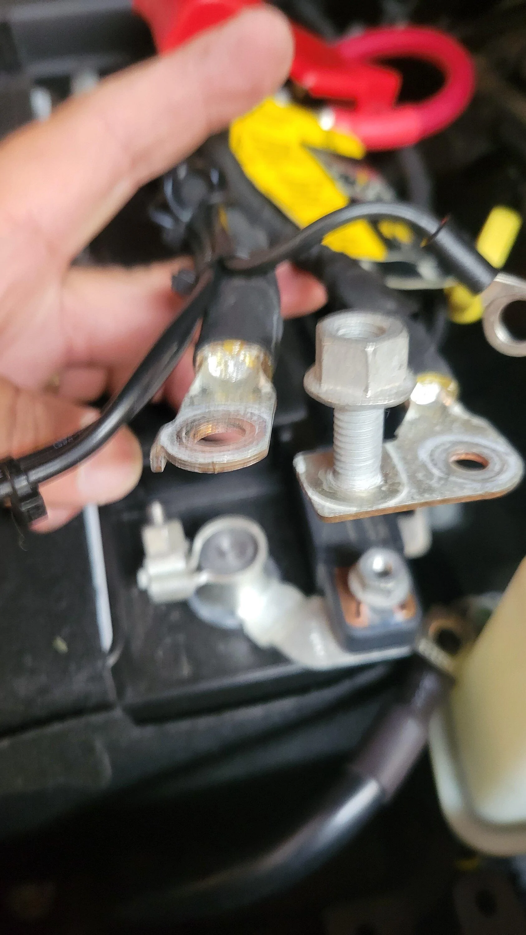

With the help of Shadowpapa figured out how to remove power to the jeep so electrical mods can be done safely without something going off in your face or shorting something out. When removing the positive cables you do not have to remove the battery post connection just remove the buss bar. Then the same thing with the ground but in order to kill all power to the unit you must also separate the two ground wires on the buss bar " ignore the smaller wire with the loop that go's to my battery tender "and remove the ground on the fender well that located next to the battery. Now a word of caution when reconnecting the battery be prepared when resetting the ground you will get a large spark ! Scared the crap out of me I was not ready for that ! Pics below.
