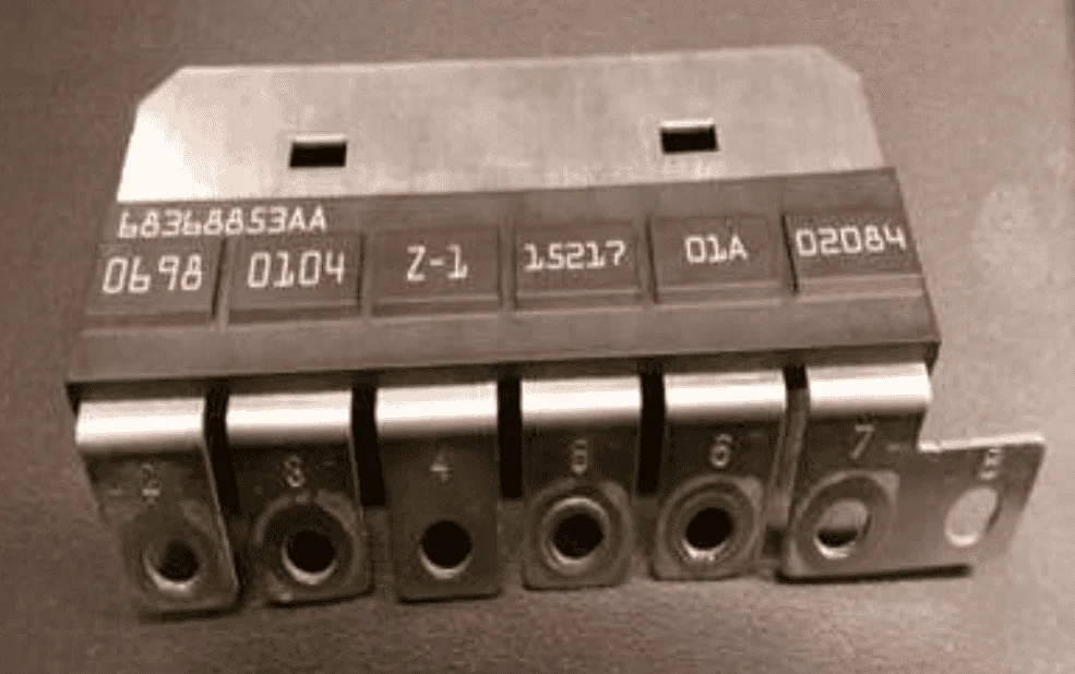

It's a more common story than you might think. Even Jeep has warnings about the fact there are two batteries and so on.
I bet you could easily find 3 or 4 who have had similar issues without searching for hours.
For those wondering - this is one example of that fuse, and what it powers, etc. ->
Jeep Gladiator No Power to my 2020 Jeep Gladiator - (Z Case Fuse Array 68368853AA) fuse-array-3
Jeep Gladiator No Power to my 2020 Jeep Gladiator - (Z Case Fuse Array 68368853AA) fuse-array-6
I had some work done on my Jeep by a local and at some point this fuse was blown (guessing when they disconnected or reconnected the battery). They couldn't figure it out and all I knew is that my Jeep was a brick. Had to get it towed to the dealer and they replaced the fuse within a day (after diagnosing). I don't fault the shop that did it, they did a great job with all the other work but point is, this fuse is apparently susceptible to blowing.
Thank you for posting those pictures.
I have learnt a lot from your posts on electricals.
For the gladiators with tow package, the part # is different right? Can't seem to find the info but here is my hypothesis.
68368854AA is for tow package with bigger alternator and battery
68368853AA is for non-tow package with regular alternator and battery.
