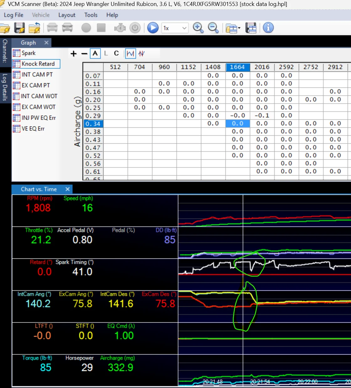

Here is a quick screenshot from a datalog I did showing the same hiccup:
Jeep Gladiator Repeatable Stutter/Judder During Light Acceleration Screenshot 2026-02-27 205136

There is what appears to be a ā€œlearnā€ area within the tuning for this same VVL system, so maybe it’s adapted to you a bit. It’s there, just not as noticeable. Running 87 octane also makes it less noticeable because the default spark timing is less so it takes less of a dip.
