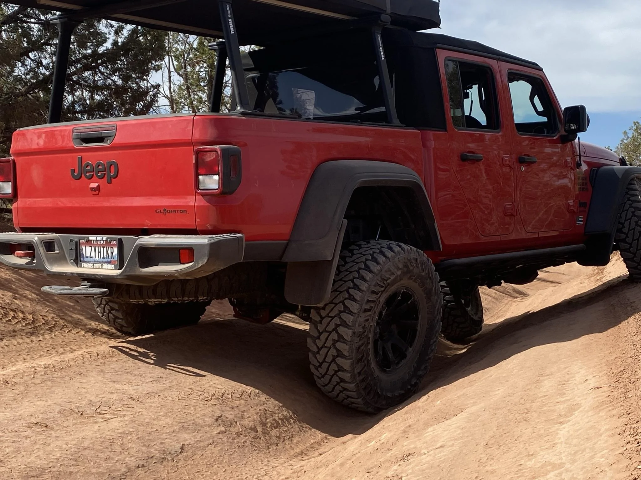

Not the best pic, but you can kind of see my front passenger front tire tucked in the fender, with 4.5" of lift. I have a Sport, so the Fenders are a little bit lower than a JTR. I would love to see some flex pics, to see how that lift does, if you ever get around to it
Jeep Gladiator Rock krawler 3” pro-x NL lift and cat back exhaust IMG_1485
I'm hoping the additional 1.5" of lift, adds the space I needed for the flex. I'll add larger bump stops if it doesn't. Off to the forklift tomorrow to test.

Nice build! Good luck with the fork testing
