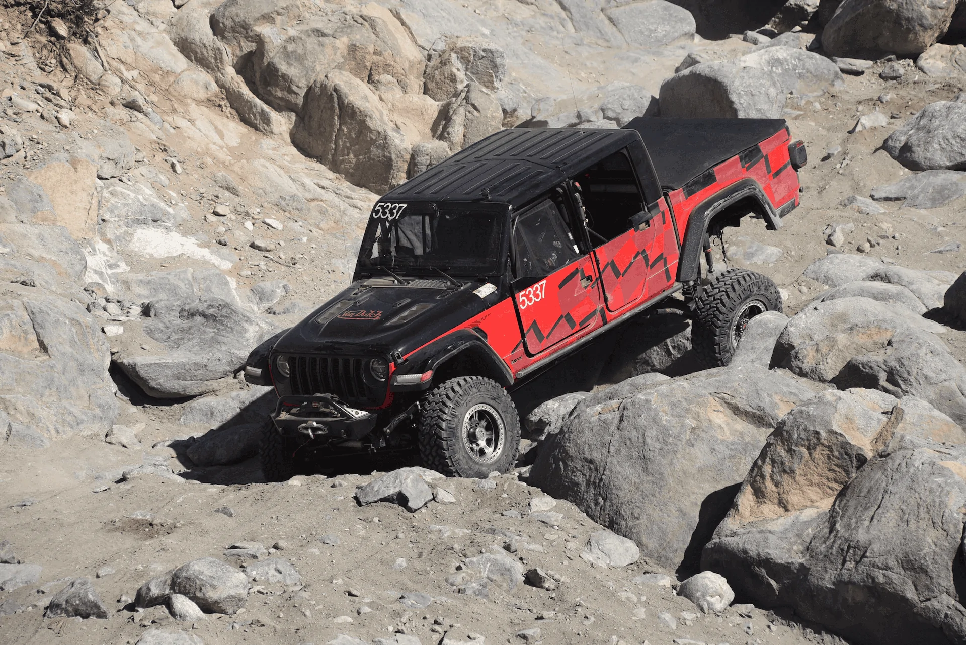

If you remember that Gladiator getting the everloving piss beat out of it at the King of the Hammers in 2019... that was Savvy:

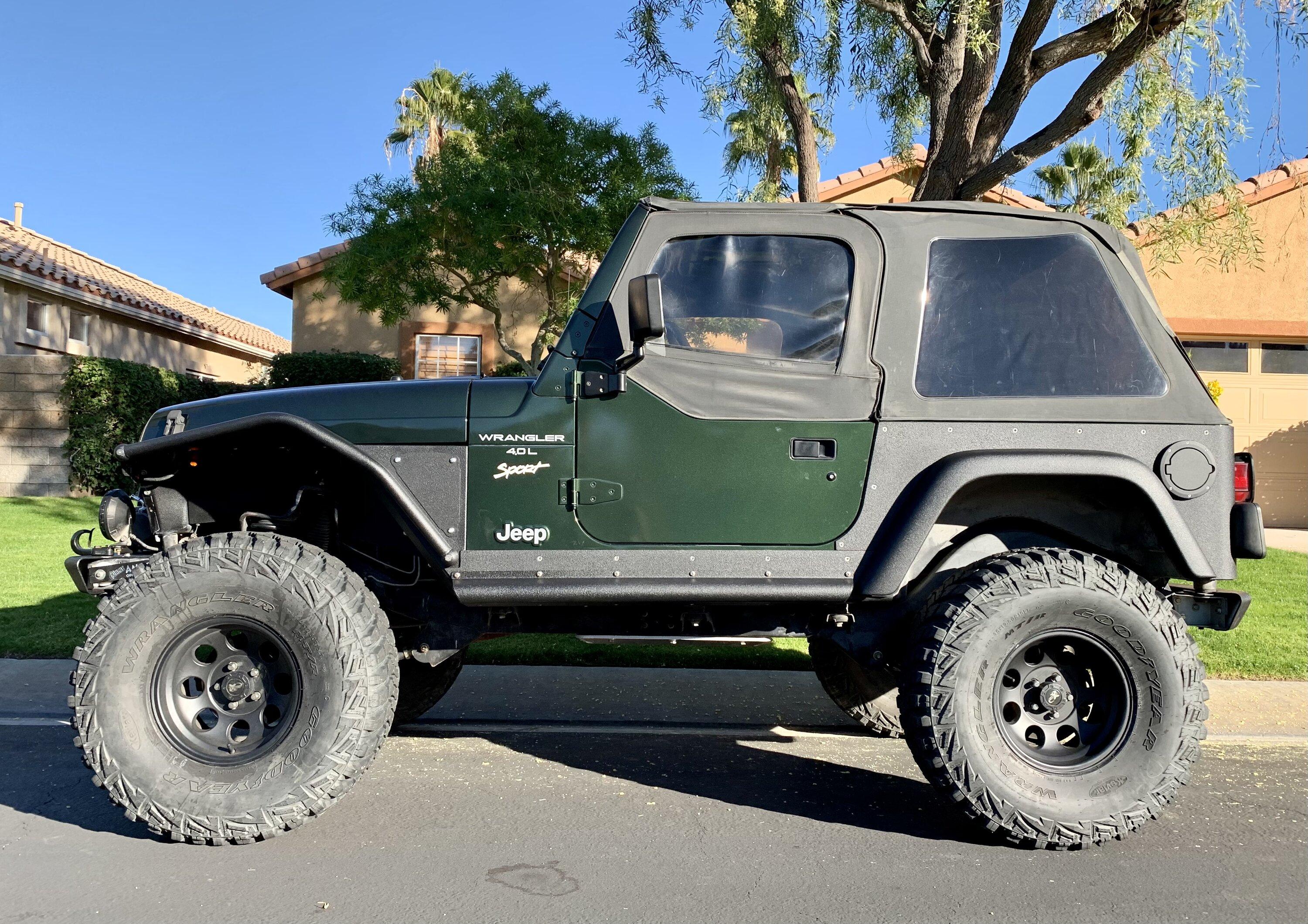

Back in the TJ generation the Currie 4" kit was considered top dog. I installed the 4" Savvy Off Road variant on my TJ, which was the Currie kit but with aluminum arms.
Nothing beats the Currie Johnny Joints they use at the ends of the arms. They're rebuild-able cartridge joints. People sometimes caution to stay away because they can transmit vibration into the frame but I think that's mostly hogwash. What they do thanks to their smooth unrestricted movement is allow the forces to go directly into the suspension where they belong. There's none of that reverberating feeling you get with rubber bushings when you hit a bump. I put over 50k miles across probably 8 years of all season driving on mine before they started to squeak a bit, and a quick pump of grease took care of that.

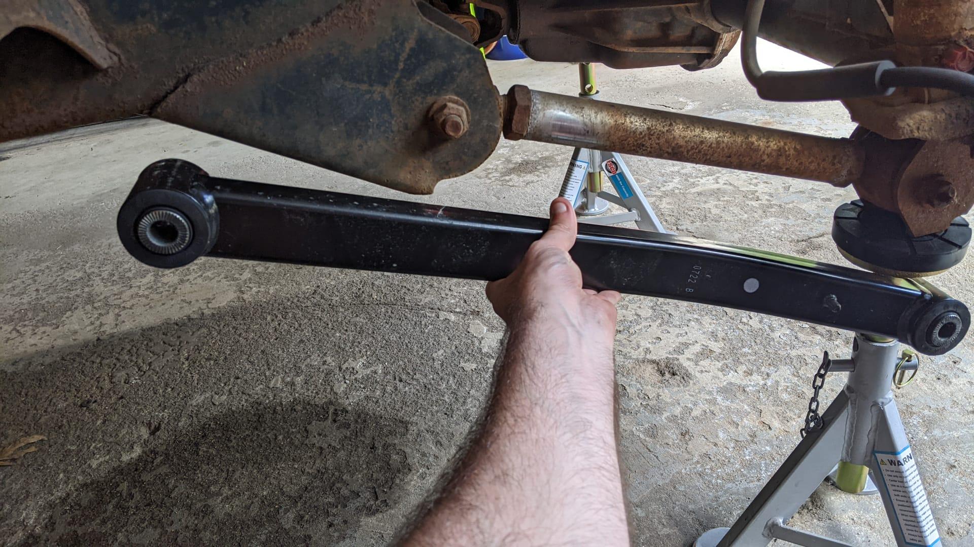

Here's a pic I took of the stock front lower arm on the Gladiator beside the arms on my well traveled TJ. Just to show the difference in length between short arms on a TJ and modern geometry. And the angle it sits at...

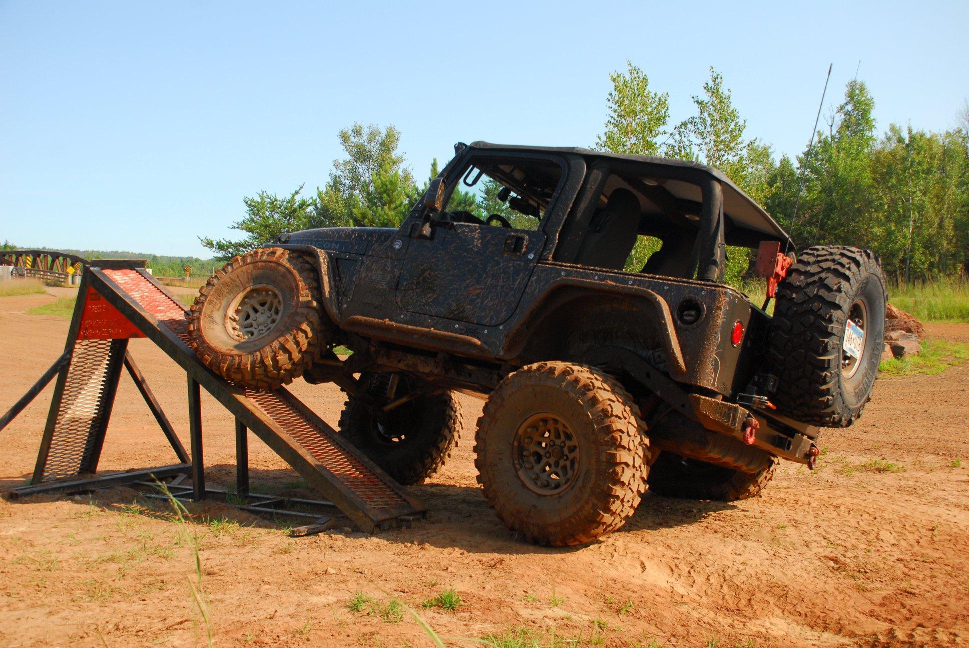

And the articulation that I was able to achieve with the stubby arms in the Currie kit, thanks to those Johnny Joints. This is with an Antirock front sway bar and stock rear sway bar connected:
^ note those little t-rex arms doing work. The point I'm trying to drive home here, is extrapolate those arms out to twice the length. Your control arms will far and away be the last thing limiting your travel on the Gladiator with the JJs. If you want the most precise feeling arms, and the most free articulating arms on the market without changing suspension mounting points, those are what you want.

and to add to that, when I did the lift on my TJ it made the ride so much smoother and got rid of all that reverb I was talking about, but there was still a tiny bit there. It was the stock upper bushings on the front axle. It looks like it's still the same way today, those bushings are pressed into the axle for the upper arms and the kit doesn't come with them. Once I finally got around to swapping out those two upper bushings to JJs, it got rid of the last bit of fluttery feeling.

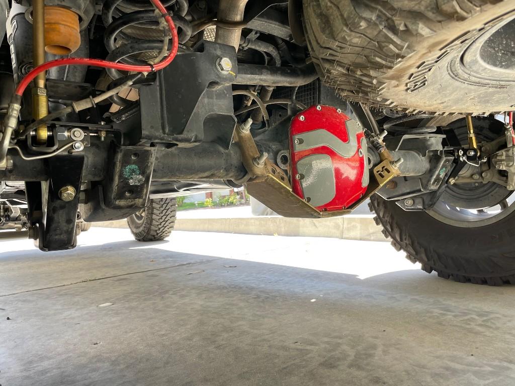

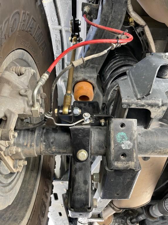

Note: Geometry correction brackets for the rear control arms is for "on-road" handling. Off-road, it will cause you to loose 2" or 3" of clearance. I do not run them.
Note2: Track bar relocation brackets will not fit with the Metalcloak rear diff skid.... which for me is required... My rear diff skid is quite scraped up...

The RJ geometry brackets will allow for more droop, they keep the pinion angle pointed closer to the front of the driveshaft. Without them, the driveshaft was the limiting factor for droop on my truck, the Rzeppa joint would bind at the pumpkin (this bind occurred VERY close to full extension). The geometry brackets eliminate that bind and I get full droop and no bad driveshaft angles. The brackets raise the upper control arm axle mounts and don't limit my up-travel either.
I know the front brackets drop the frame side mounts - and I agree - I won't run those.
This is my understanding on the rear brackets geometry as well. The fronts were not recommended because rock crawling was going to be in my future…

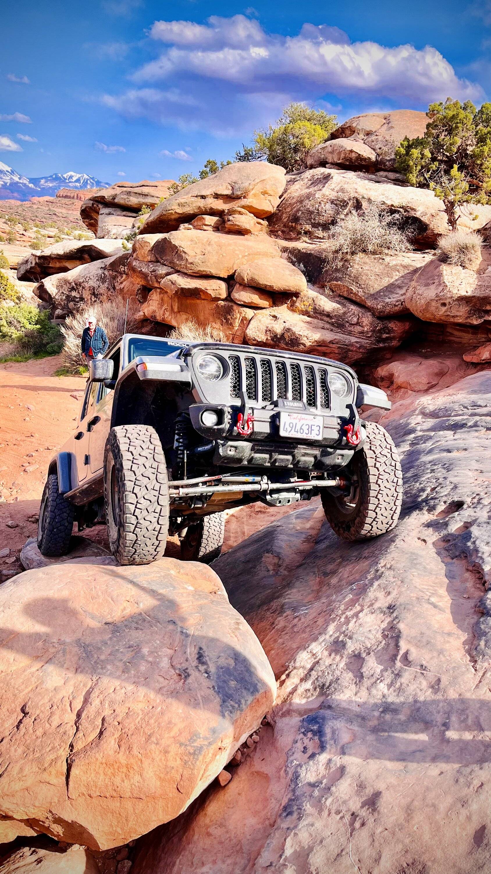

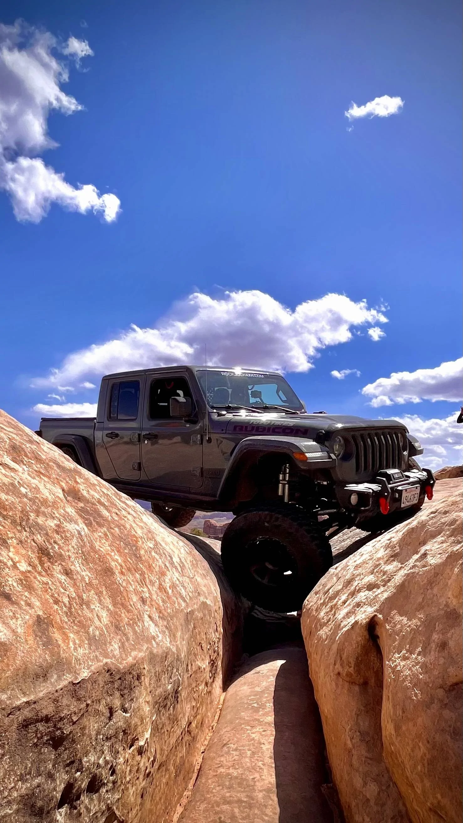

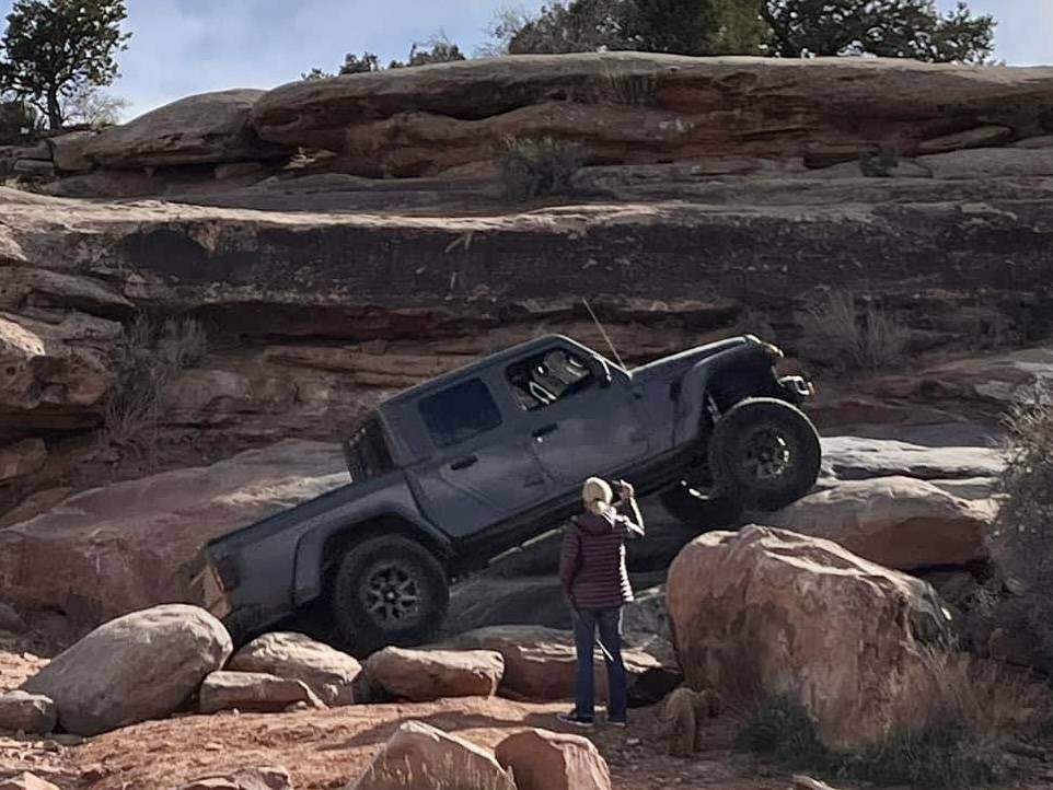

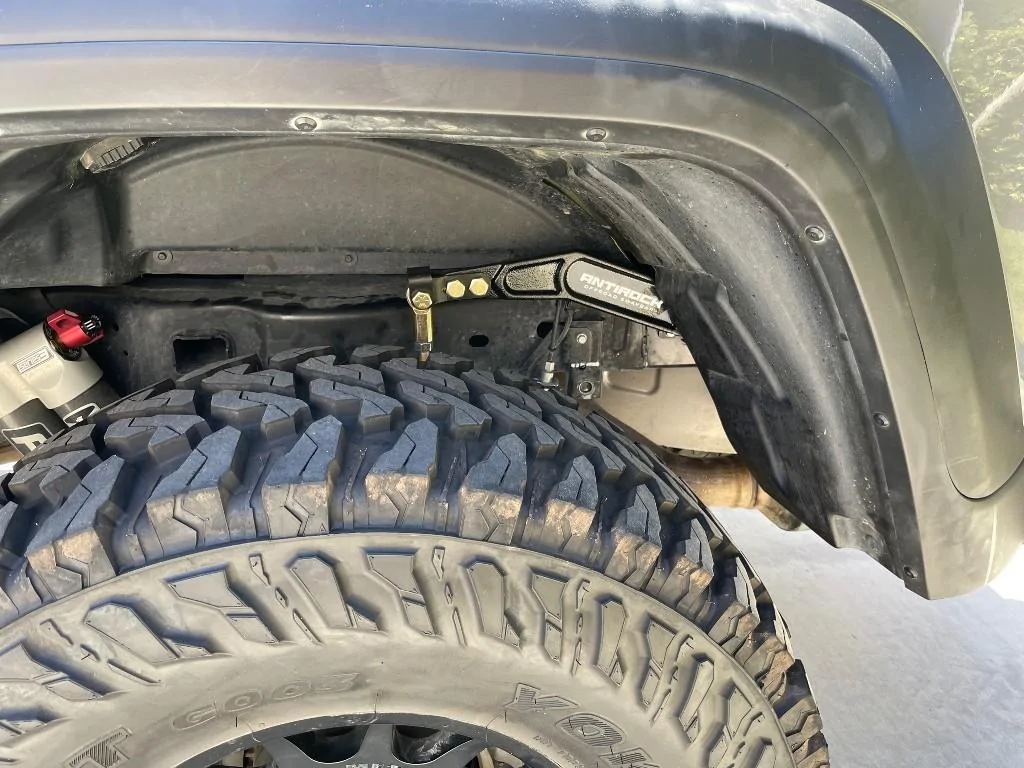

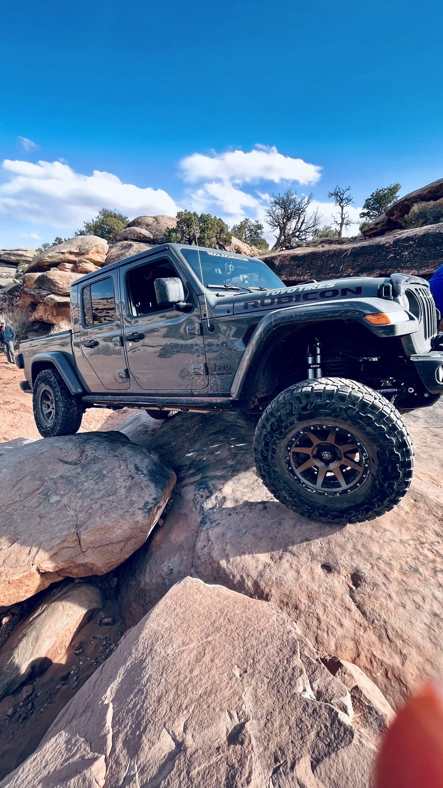

It’s a great kit! I have tackled some of the toughest trails in Big Bear as well as Cougar Buttes and Moab. This lift remains uncompromised. Install is a bit time consuming. I added the rear geometry relaxation brackets, new front driveshaft, Bilstein 5160 shocks, and Johnny Joint front axle kit. It’s solid and have nothing negative to say. Nothing has broken or let me down. Street and off road drivability is great. Tows a 20 foot trailer as well.
Jeep Gladiator Rock Jock Pro 3.5 Lift? 7427E87F-FA97-41C9-BD1C-0B1041D96961
Jeep Gladiator Rock Jock Pro 3.5 Lift? 4B518373-31FF-4611-9535-A714DDE4A632
Jeep Gladiator Rock Jock Pro 3.5 Lift? F7480EAB-9666-4DFF-B1DC-F9787925E8DF
Great to hear! Looks good! Did you get all 8 control arms? Is the currectlynk steering holding up well?
Yes, currectlync has no issues as well. You really can’t go wrong with anything RockJock

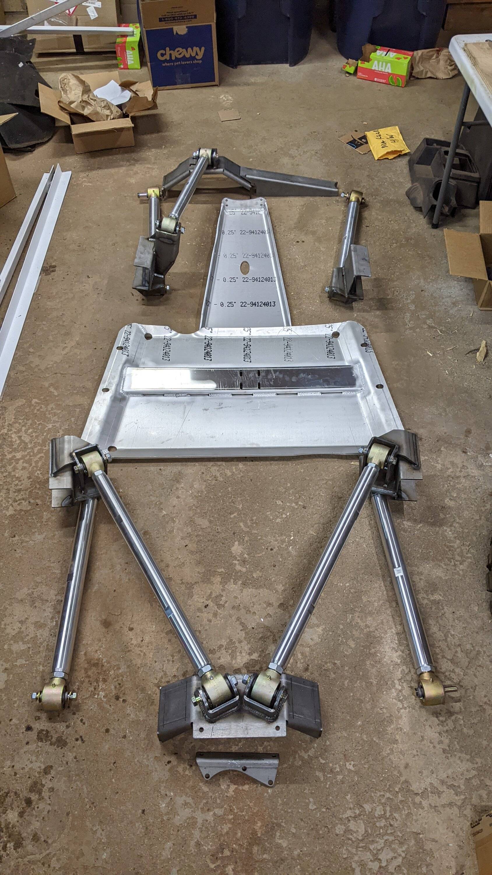

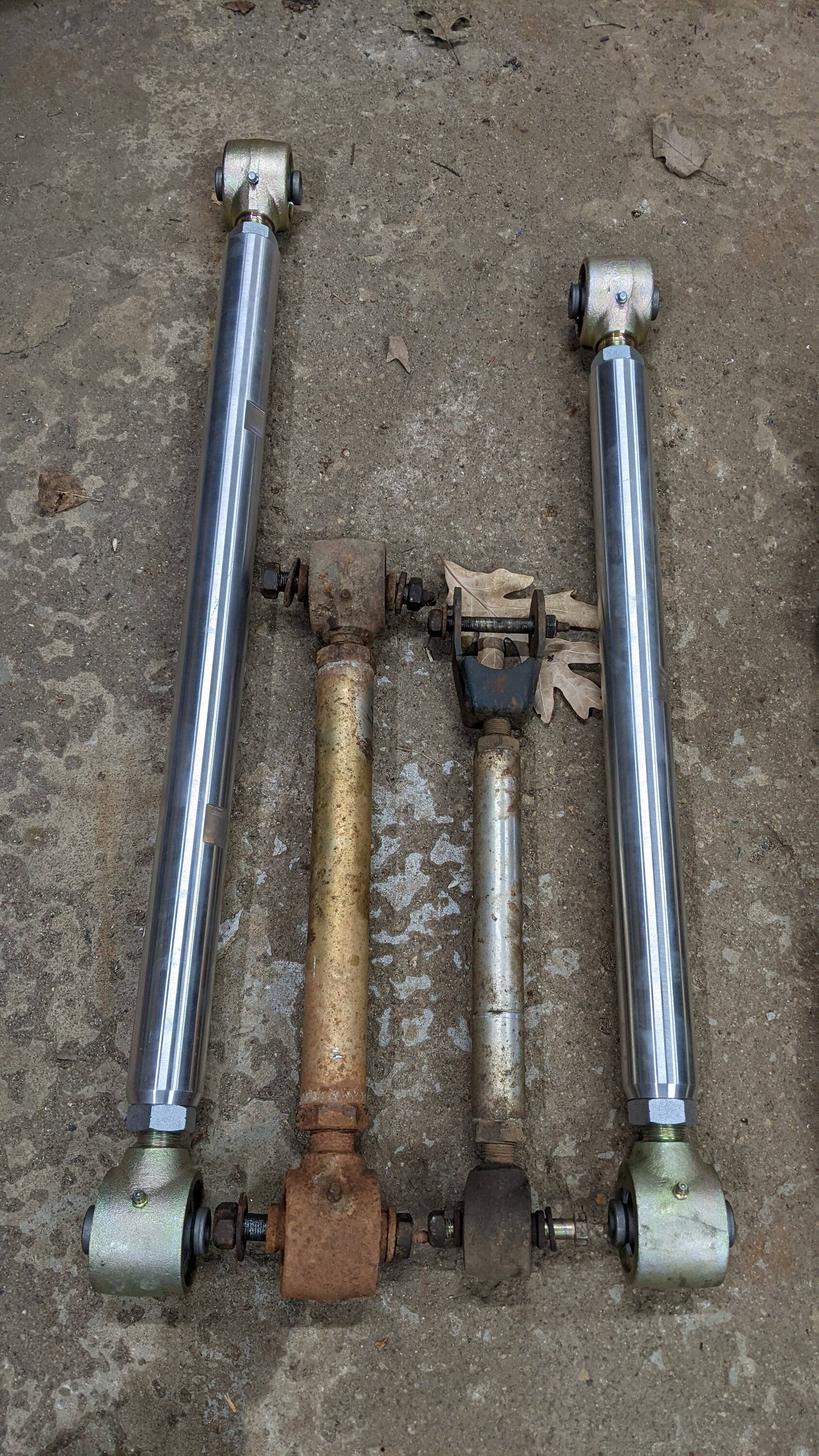

I was considering getting the RockJock arms for the JT then got the itch and decided to upgrade the TJ instead from the Savvy short arm to the full Savvy mid arm kit. Love me some Johnny Joints and double adjustable aluminum arms. I'll get to the JT eventually but the TJ does the real wheeling and the two just serve different purposes.
Jeep Gladiator Rock Jock Pro 3.5 Lift? PXL_20230330_180346405
These are the old upper vs new upper arms. The Johnny Joints here have never been greased, and were daily driven and regularly wheeled in a salty climate for 10 years and are still totally tight. Can't say enough about them.

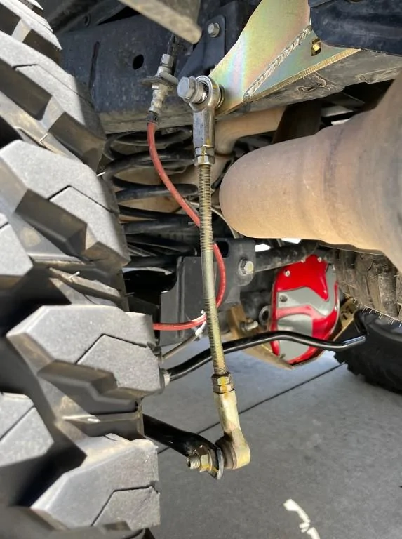

Nice! I have a TJ as well, with the Savvy short arm kit. Figured I’d upgrade the JT instead. Best of both worlds.
