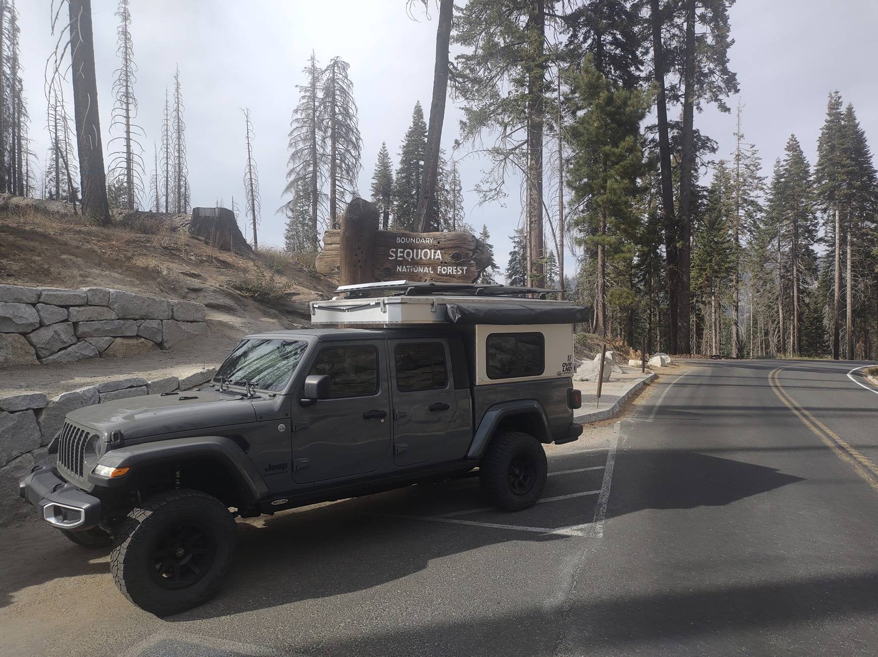

Hi all, hope everyone is well. I have a 21 gladiator with a 2” level in the front right now. I have a rack and tent in the bed that makes the back squat just a little. I am debating on going with a 2.5” lift or 3.5” lift. From photos I’ve seen the 2.5” doesn’t look much different than what I have and the 3.5” looks just a little too tall. I do kinda like the big wheel gap look so I’m leaning towards the 3.5”. I have 35’s also and do not really want to jump to 37’s. The truck isnt a rock crawler, it’s a fire roads and dirt trail kinda truck just to get me and the wife to camping spots. Any suggestions or advice would help, and if you have any pics you could post that would be super helpful. I appreciate all of you! I posted a pic of the truck as it sits now for reference.
Jeep Gladiator 3.5” or 2.5” lift IMG_3966

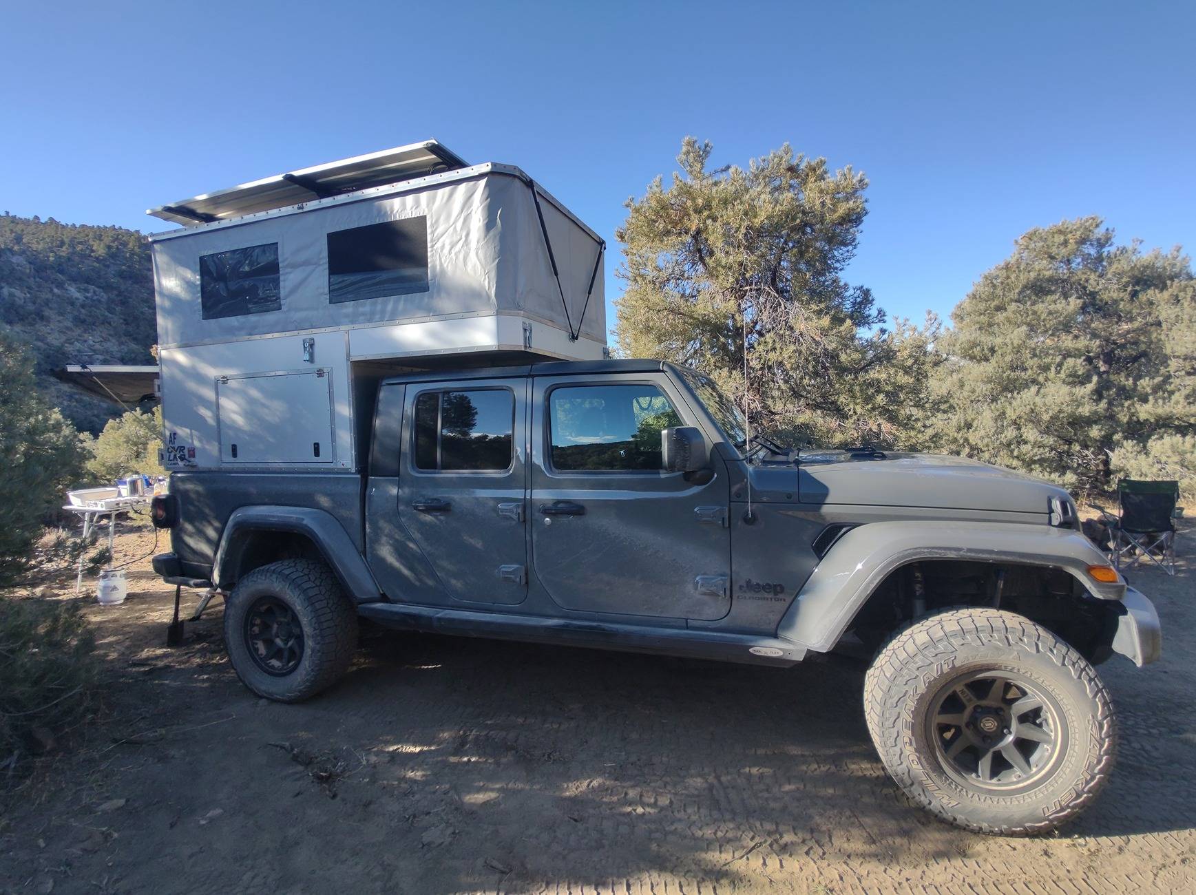

Taller side walls might help on the tires as well. I have a Clayton Overland 2.5 lift on 33's it's the gray one.
Jeep Gladiator 3.5” or 2.5” lift IMG_20241228_092006170_HDR

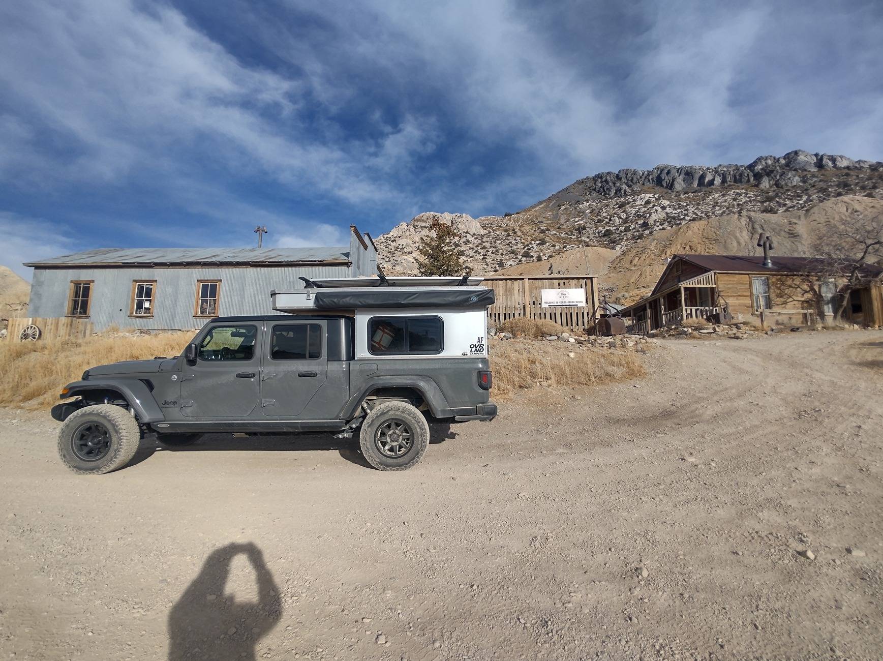

2.5 will be better for your use case. Pictures here with 35 inch tires in a 2.5 vs a 3.5 before I put the 37's on it. At a 3.5 MetalCloak I had to start considering front drive shaft changes, etc.

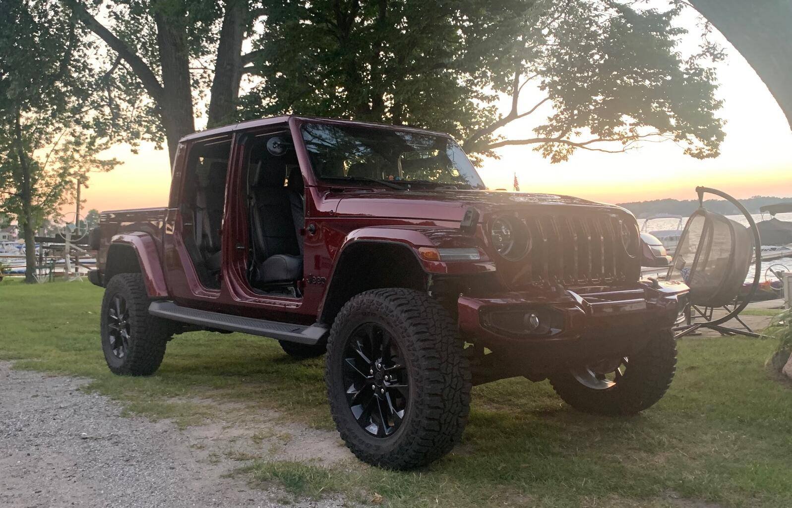

2.5 overland plus lift from Clayton. I’m riding 37s with plenty of space. It’s supposed to settle a bit more but 2.5 lift was over 3inches if measured. That’s with a heavy steel bed cap, steel bumpers and winch.

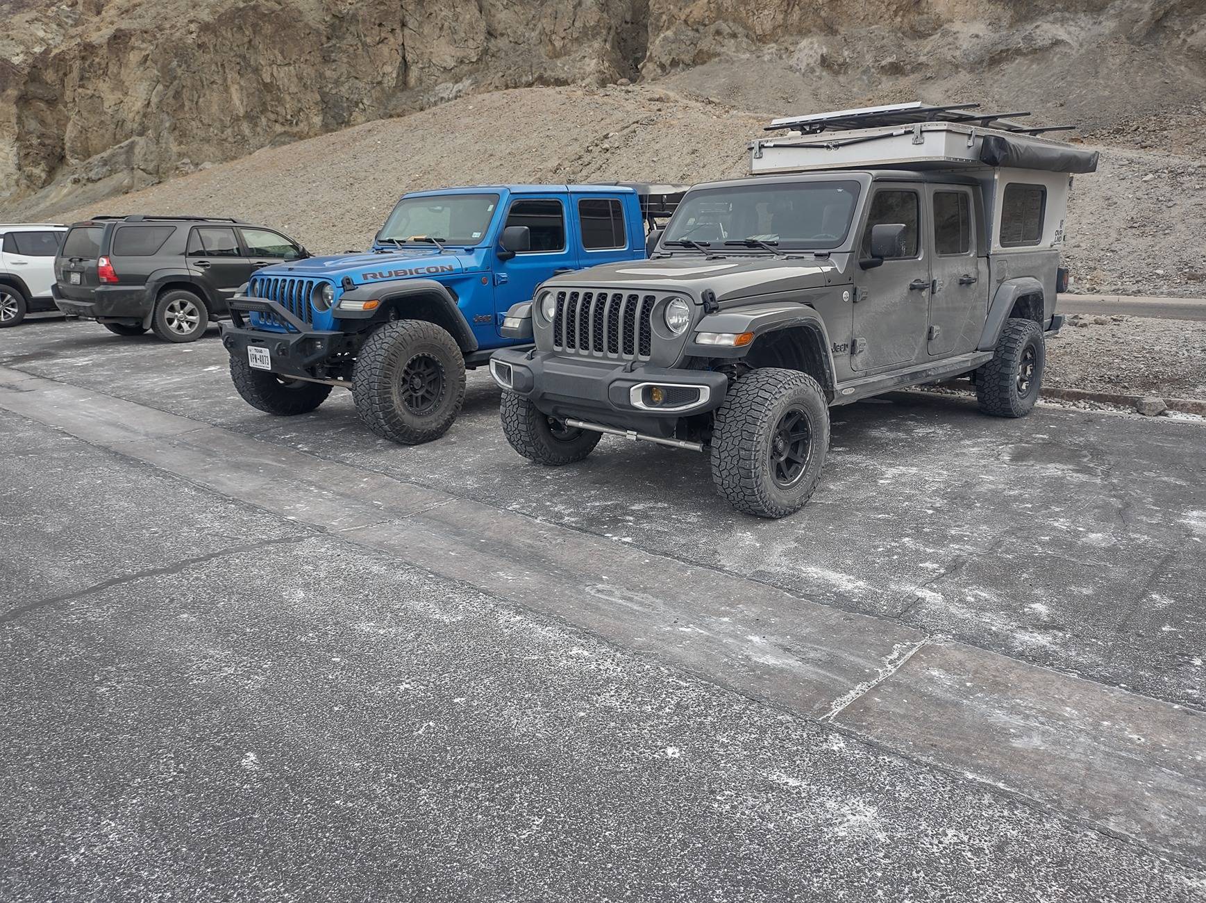

Don't forget that not all 2.5" and 3.5" lifts sit at the same height.
This is mine with a 2.5" Clayton lift and 35" tires.

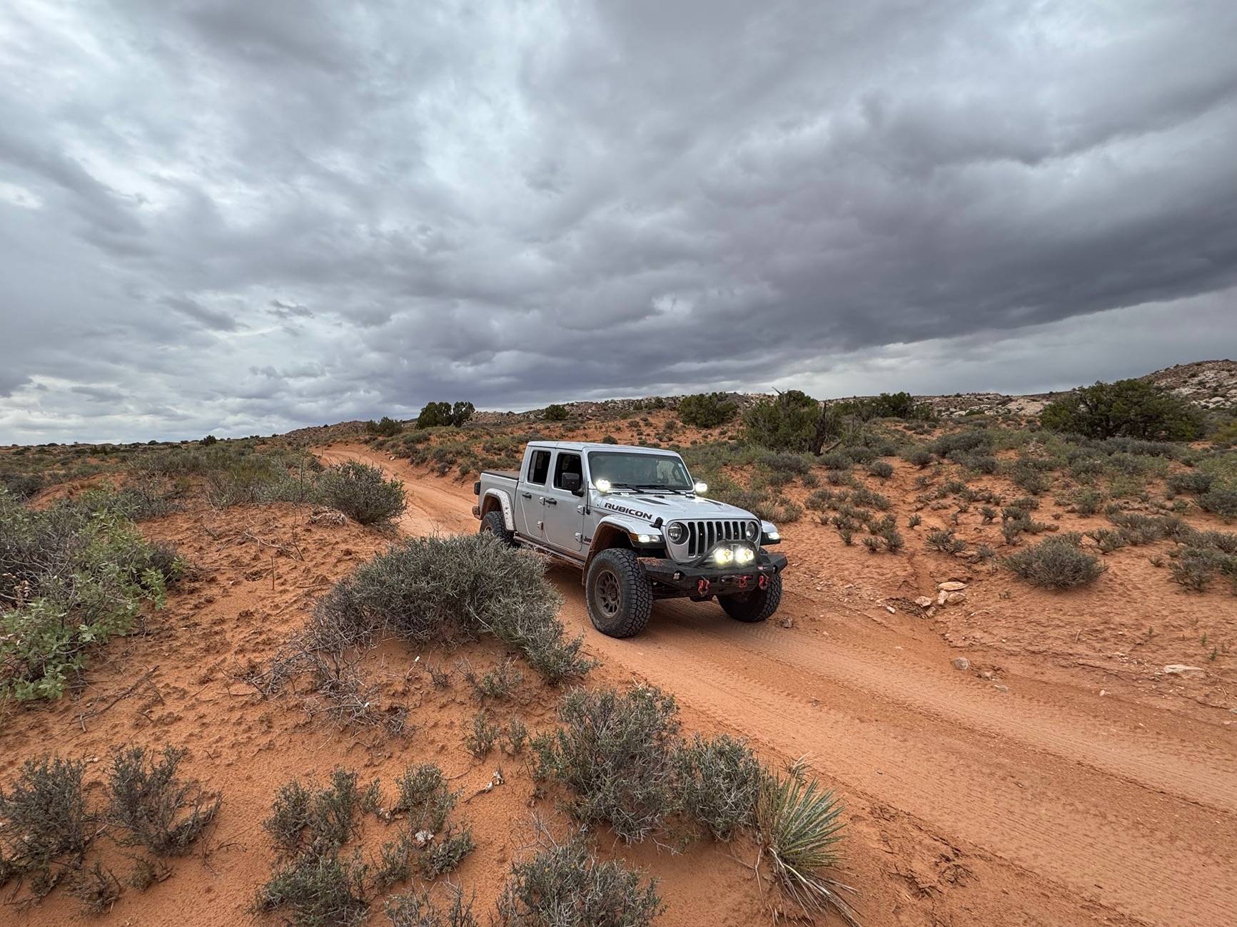

Clayton Overland + 2.5" on 35's. Perfect for me. I keep waiting to scrape the crap out of the underside, and aside from the hitch skid - it's not really happening yet. Just finished a week in Moab, and very, very minimal scraping. As mentioned, the Clayton nets out at a little over 3" with steel bumper winch, gear, etc..

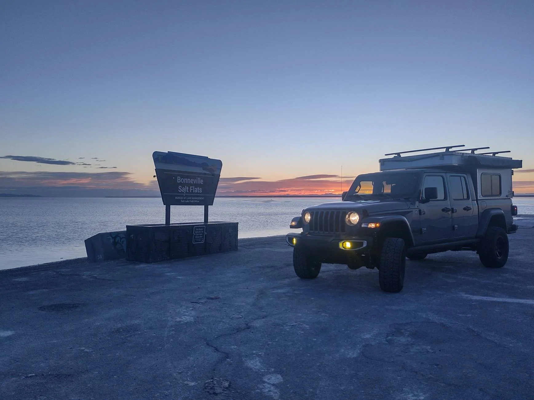

I plan on a 2.5 lift and sticking with the 33 also One because there new and the other is i like the look . do you have any more pictures of you rig with 2.5 lift and 33 ??
