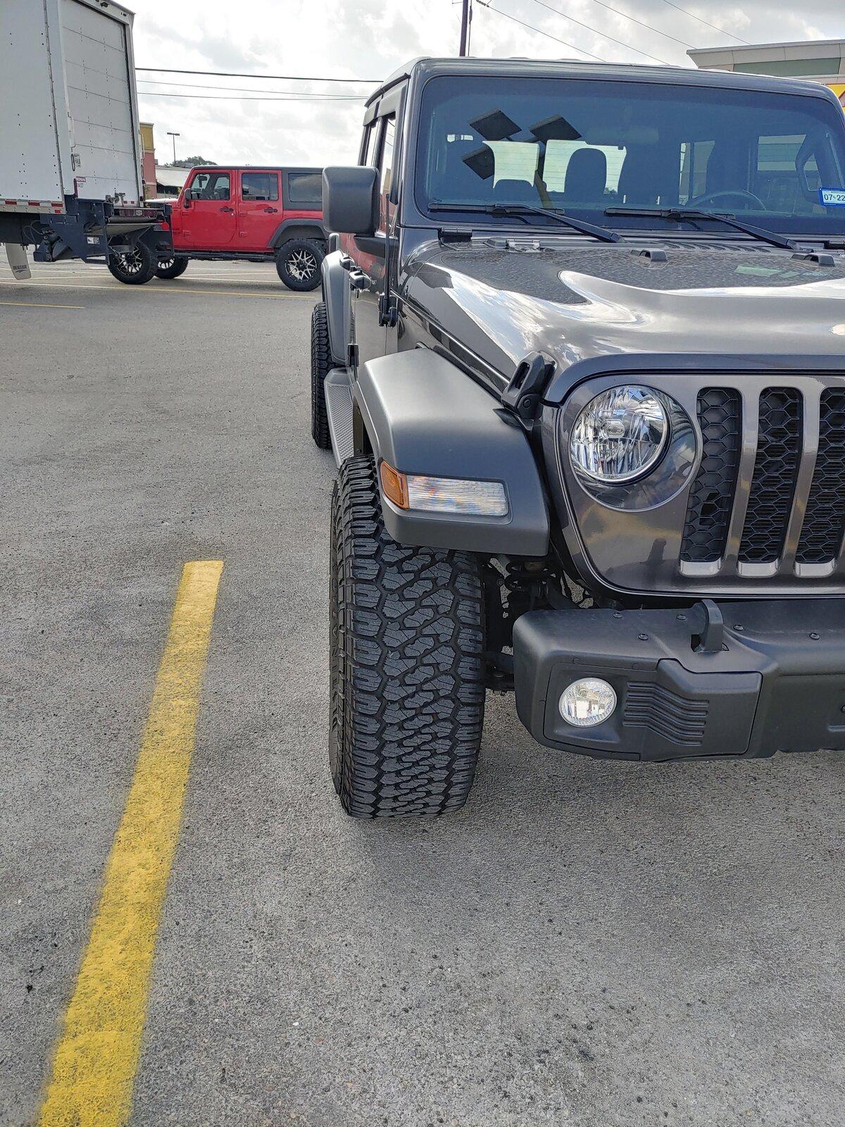

Anyone got pictures or thoughts on 2.5” lift with 33” tires?

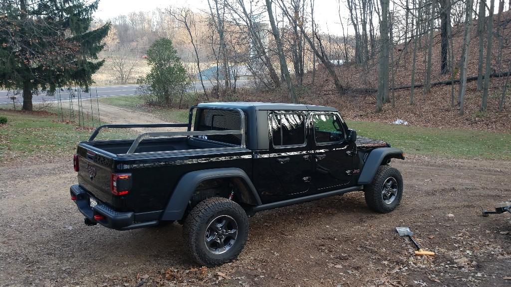

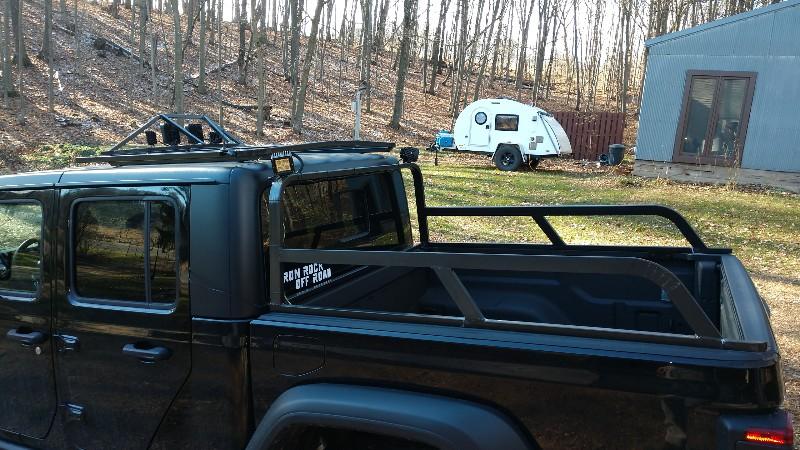

My JTR with 2" front and rear lift (Iron Rock Offroad). Love the lift! Stock Rubicon wheels and (stock) Falcon at tires. I like the combo and have no designs to go larger. When I need tires, I'll go up to a 285/75/17. I've never been a fan of Tonka truck sized tires. Looks silly to me, not to mention like taking a jackhammer to suspension components. Just my personal opinion. I value reliability over parking lot bragging rights. If I can't get there and back, it's worth nothing to me. It's not my daily driver. It's my ONLY driver...

Where you find those bed rails and rack

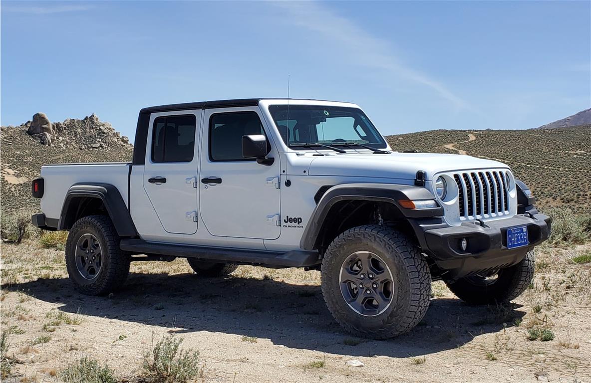

Which is one of the reasons I went with 33". Didn't want to effect the effective final gear ratio any more than I had to. Not to mention take-off Rubicon wheels and tires can be had for less than someone would pay for just tires.
Pictured is my Sport with Rubicon take-offs and the Mopar 2" lift. Lift actually ended up with just over 3" in front and 2.5" in the rear. I think it looks fine with the Sport fenders.

Ain’t nothing wrong with that 👍🏻
