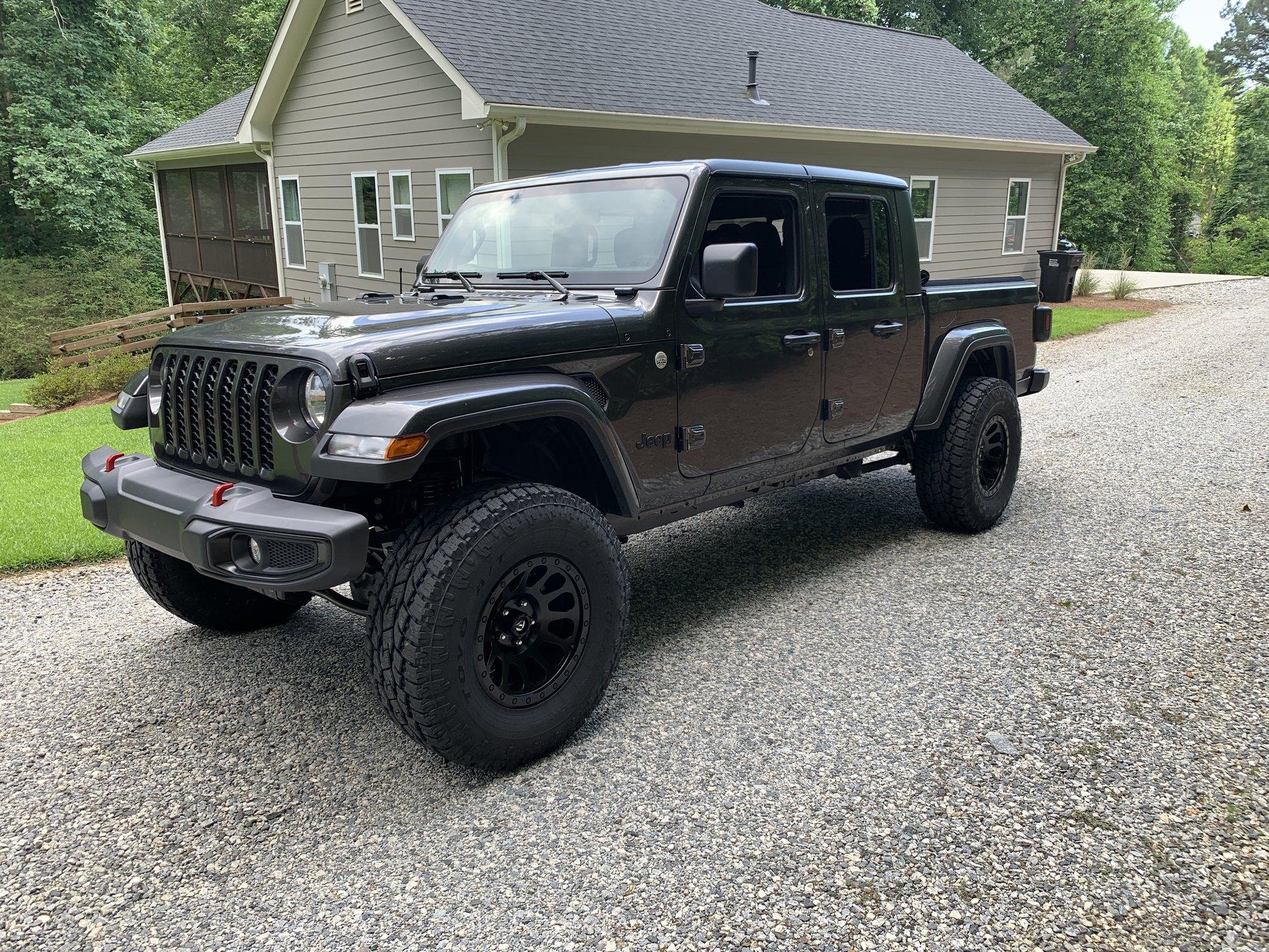

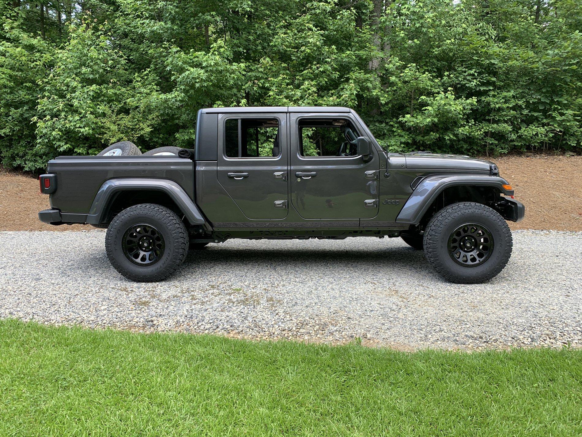

Here are some photos to throw around for lift ideas. JKS 3.5 lift (3.5 front and 2 rear) with the same tire (35x12.5x17) and wheel (17x9 w/ -12 offset) size combo as yours except with Toyo AT2s. I’m not a big fan of stuffed fenders or I would have went with 37s. Plenty of room for them. This lift put the rear about 1/4 inch higher than the front.
As far as ride, the JKS is more stiff. I like it though compared to the bounciness of the factory suspension. It handles corners much better. Each kit will vary in ride depending on coils and shocks.
Jeep Gladiator Sport S, no lift w/ 34.4 x 12.7 Nitto Ridge Grappler -- thoughts on aesthetic and ride 54C442EC-6FFF-4947-912A-D506033BD89D
Jeep Gladiator Sport S, no lift w/ 34.4 x 12.7 Nitto Ridge Grappler -- thoughts on aesthetic and ride F8647D74-869B-45A4-81CD-14D90C8E848C

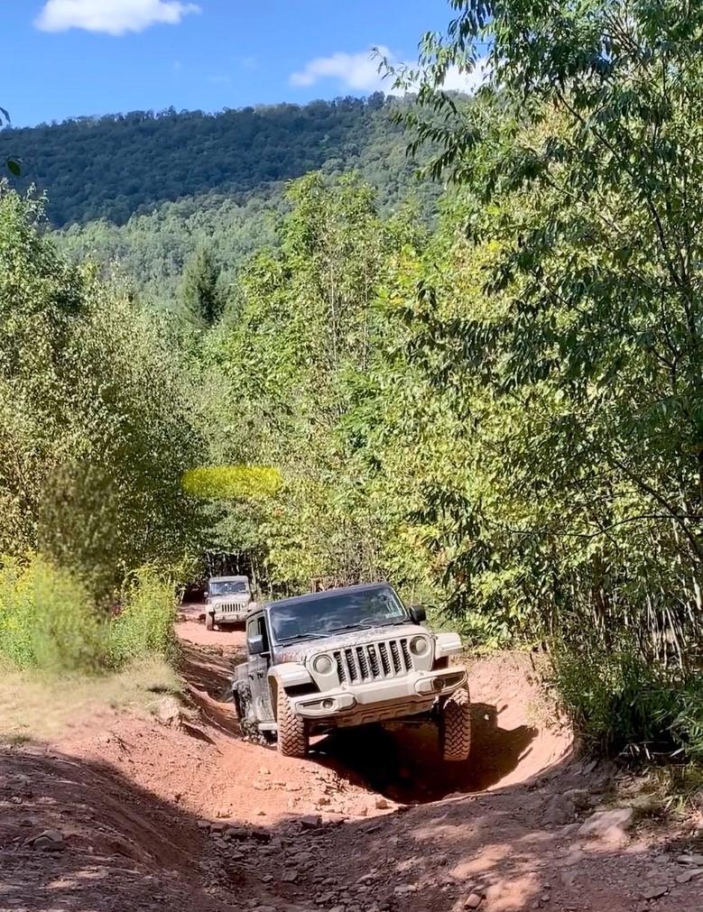

For on road, you should be good. Off road might have some rubbing problems, search the forums and there will be answers about 35"s on stock suspension. Remember that most 35"s are only 34+ tall. A lot of Rubicon suspensions pop up in the Members Marketplace if that is the avenue you are going. I think mine rides good as a stock Rubi.
Look at this picture from last weekend, your 34.4"s might have taken out the right front fender. Maybe not, there are better experts here than me.
great picture and thanks for the tips. Not sure about direction of suspension just yet but will deff. keep my eyes peeled in the members marketplace.

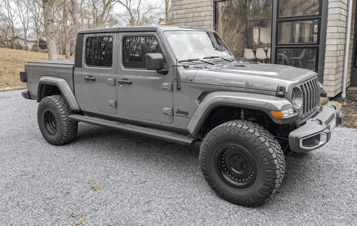

Closing the loop here. Decided to go w/ the MOPAR 2" lift. Very happy, much improved ride quality. Ultimately, I wanted to preserve the warranty.
