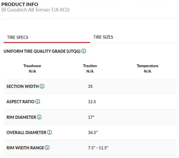

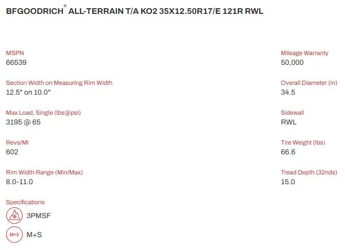

Ok, you seeing those specs on Discount Tire makes sense. Discount Tire contradicts some of the tire manufacturer recommendations when they say 7.5" wide is ok for 12.50 wide tires. Discount Tire says a 7.5" wide wheel is ok for a BFG 35x12.50, but BFG says 8".
Per Discount Tire:
Jeep Gladiator 35 x 12.5 tires on factory Willy's wheels - Costco says NO... BFG KO2 35x12.50x17 per Discount Tir
Per BFG:
Jeep Gladiator 35 x 12.5 tires on factory Willy's wheels - Costco says NO... BFG KO2 35x12.50x17 per BFG
