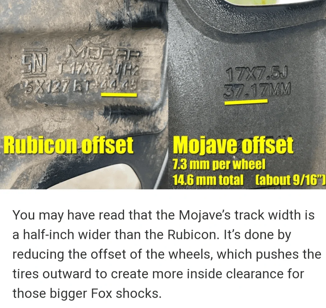

I thought the Mojave had a different offset to clear the larger steering knuckles? IDK, but I don't see Jeep making a special offset wheel for one option package if the standard offset worked.
zxd9
Mark
Apr 7, 2020
197
249
Athens, GA
2021 Mojave Granite Crystal
Software Engineer
Mojave offset is 37.17mm and all other wheels are 44mm. It ain't much but it was done for a reason I'm sure.
IamPro2A
Apr 25, 2021
1,102
1,572
New Hampshire - Live Free Or Die!
'95 YJ, '07 Ram, '25 JTR, '26 JLU (sold '16 JK, '21 JT, '25 JLU)
Retired-ish
Actually, a quick forum search says that offset is needed to clear the larger Fox shocks on the Mojave.
