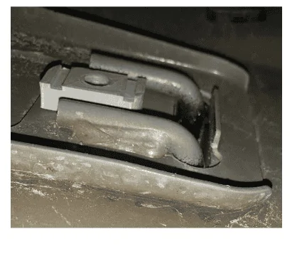

i wonder if i used self tapping bolt heads instead of riv nuts would it hold as well? if i drill im planning to use touch up paint on the holes prior to installing a riv nut if i go that way. Saw this video today.
I have the same panels and went with the Riv Nut option, just a warning.
Had no issues drilling the front and center sides of the bed. Where I had a problem was the rear most drill point next to the tail gate.
The way the L-brackets are shaped, you naturally want to place them horizontally, and that's what causes the following issue. There's a hardened steel support brace about halfway up from your marked drill point for a horizontally placed bracket. This ends up causing the drill bit to walk while you're drilling and you end up with a horrible oblong hole where your rivnut should be.
Jeep Gladiator Rough county molle system question Captur
I got lucky and was still able to install the rivnut, but I recommend that for anyone else who is marking the drill points is to angle that rear most L-bracket about 30 or 45 degrees pointed downwards to avoid the brace so that the drill stays true.
