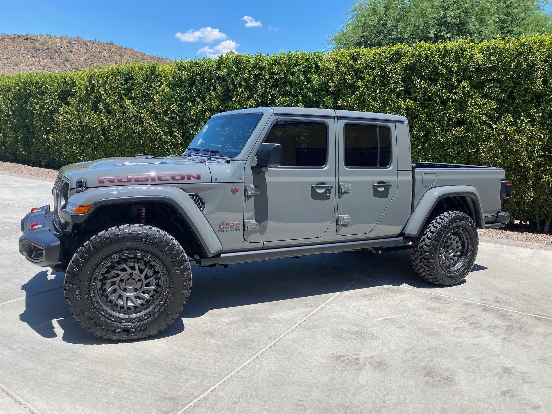

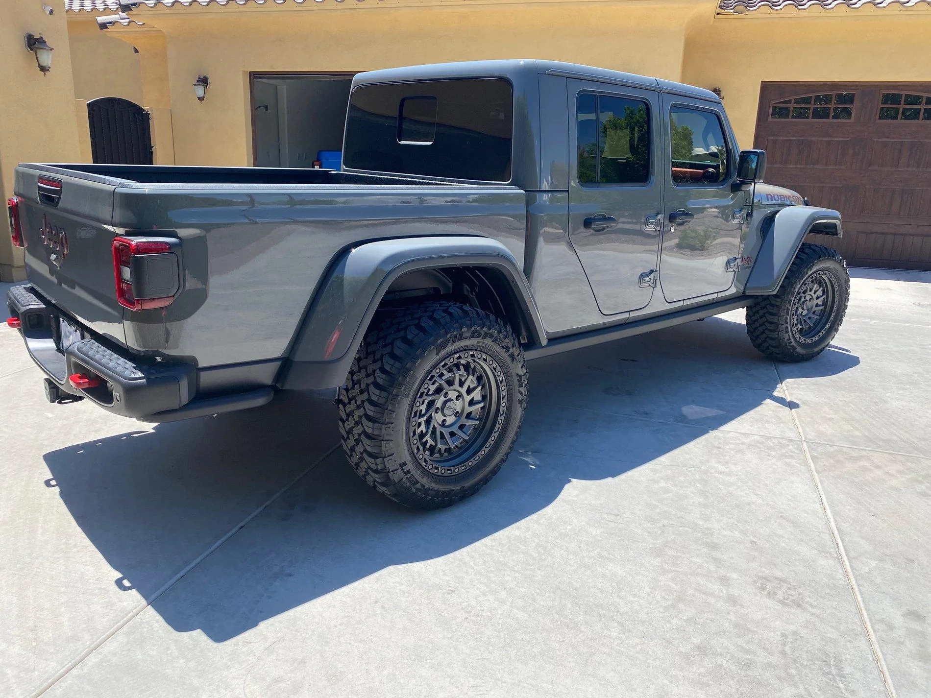

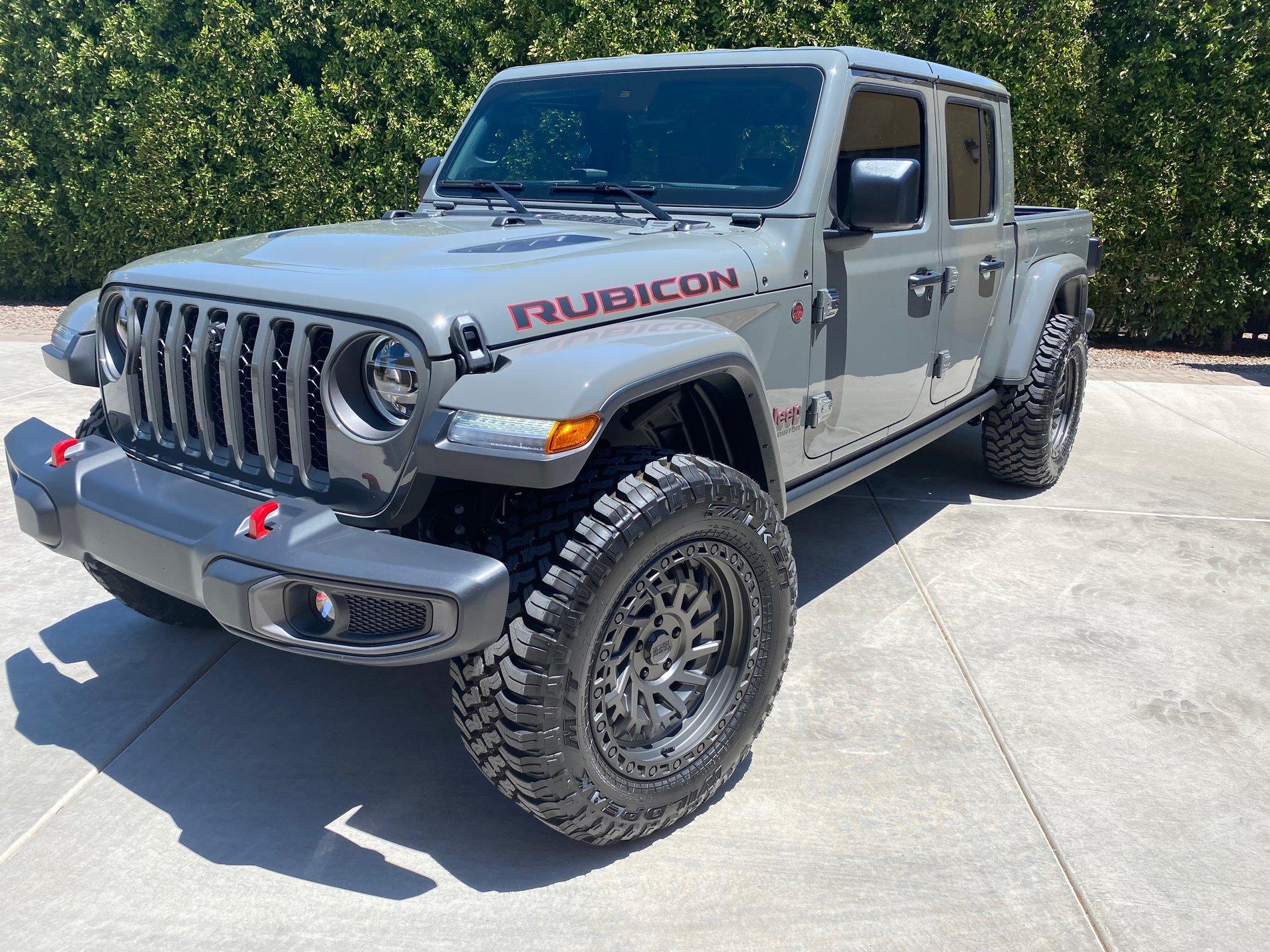

Did this LITERALLY yesterday Friday 7/24.......I did both the wheels and tires and I went with 35" x 12.5 x 20 Falken Wildpeak M/T.
No rubbing with full steering, lock to lock, and appear to probably have full suspension travel ability.
No Lift everything stock, 2 weeks old and just about 300 miles..... already has a rock chip on the windshield.
Hope this helps.

Also probably important is the new wheel info... as it might be different than what you have.
From the receipt it says - 20 x 9.5 5-127 +0
So my package of these wheel numbers, and the tire numbers above work perfectly in my situation.
