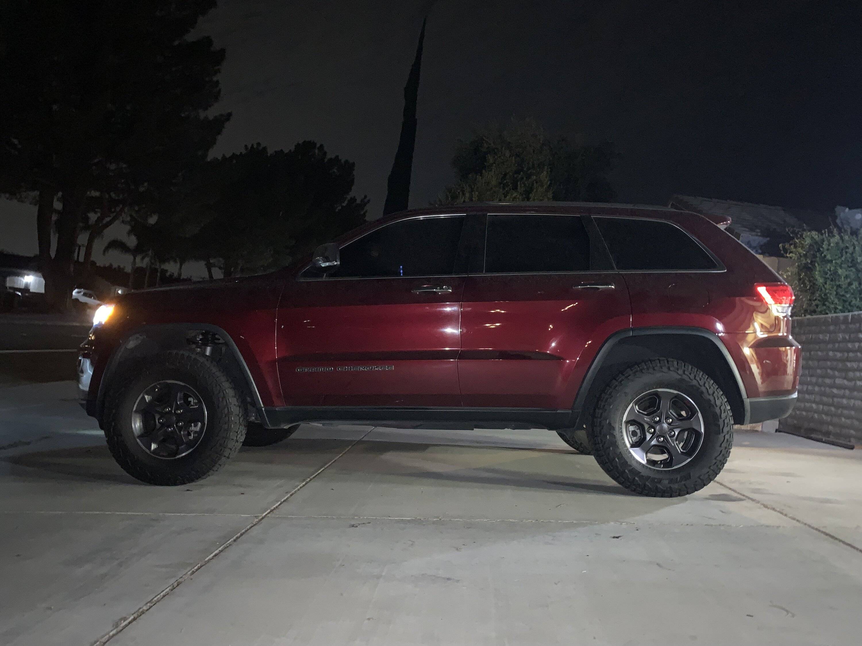

Might need spacers to cover the wheel offset for the calipers. Mine rubbed on the calipers just a hair so universal 5mm spacers solved the problem. I went down to 17s on mine.
Jeep Gladiator Tire swap IMG_9849

Kevin, I had 18's on the 2015 GC Overland so it's the shorter sidewall that makes it ride like crap. The reason they put 20" wheels on the GC High Altitude was for looks only. I heard 1/4" spacers were needed for the caliper issue. Just needed to reaffirm that thread. Thanks for everyone's imput. I have the spacers in my garage already. Good looking GC. Love that color and the wheels look great.
