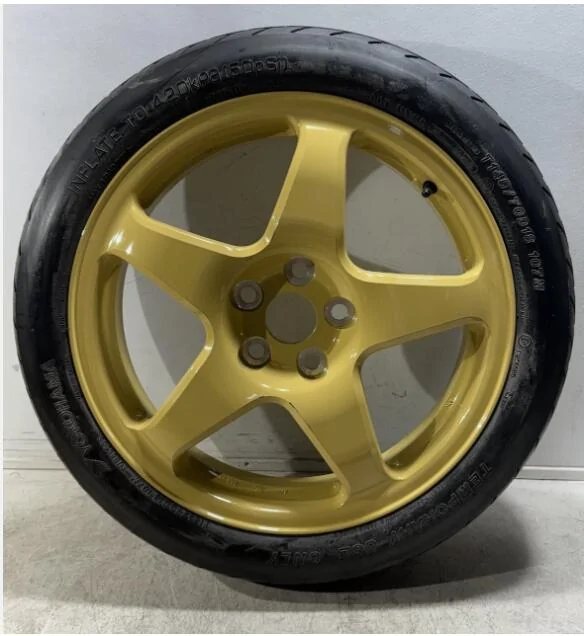

Have you seen the companies that put a bright yellow spare wheel on their vehicles? I think they want to deter the owner from leaving that sucker on there. This is a Lexus spare.
