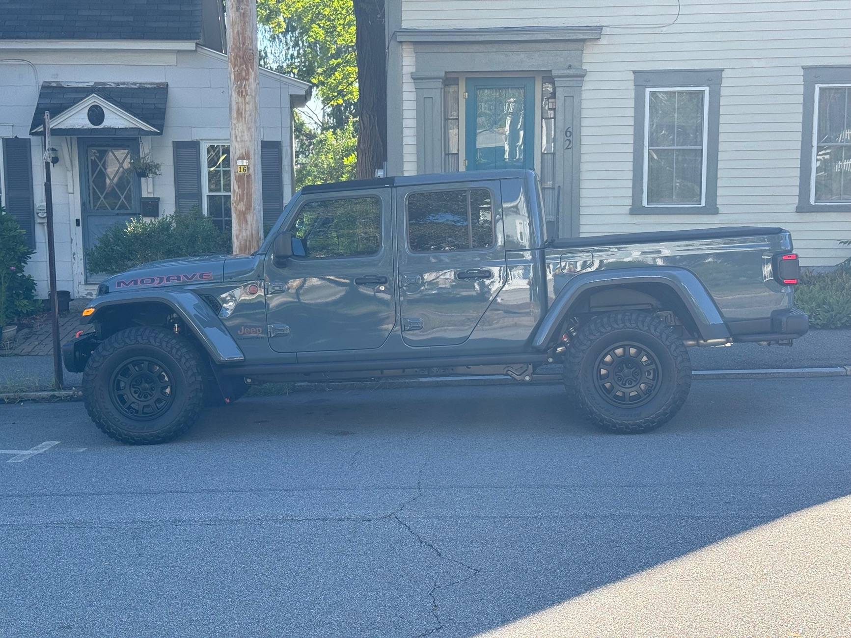

Hi All,
Had my new set mounted over the weekend on my 2024, and I’m getting nothing from the aftermarket sensors I ordered from ExtremeTerrain. I did search past forum posts, and I have tried the pressure down and drive approach to initialize the connection, but still nothing. I simply get “Tire Pressure Unavailable” and a solid dash light. Is a visit to the dealer my best bet at this point?
