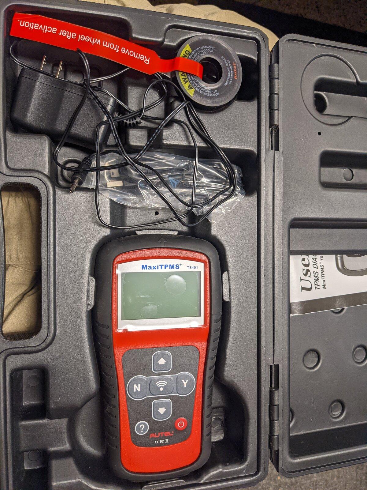

Bought a set of Mohave take offs for my Max Tow. The seller, a member here and bought from here, said that they came with the sensors. My JT hasn't read them yet after a couple hundred miles. I have increased the pressure, pulled the valve stem and deflated and reinflate to 40 psi and still nothing. I even shoved a thin piece of zip tie in the valve stem when the core was out and it came to a stop where I figured the sensor should be. I have not broken the beads and actually looked for the sensor yet. Even borrowed a tpms programer from a buddy but it doesn't have a JL or JT in it's available vehicle. Anything else I can do to get them to read?
Jeep Gladiator TPMS not reading PXL_20210713_195127957
