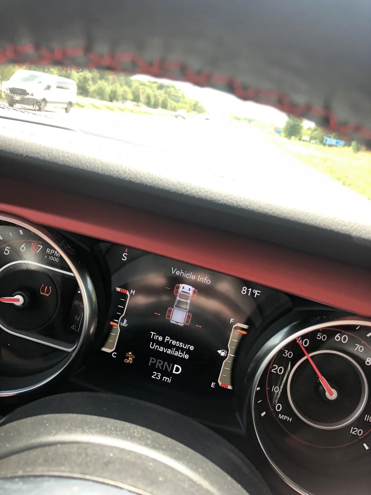

TPMS not working

I’m having a similar issue myself. New wheels, tires & sensors from Discount Tire and no reading on any tires. They can’t even get the sensors to pickup on their scanner. They also tried 2 different type of sensors so they are gonna order some OEM sensors. Anyone with suggestions on this
