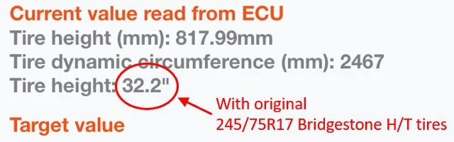

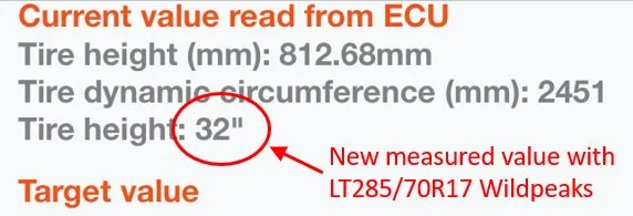

So I finally got around to recalibrating the speedo. I got myself a Veepeak BLE OBD2 and the SGM bypass cable set.
I'm a little perplexed by what I found.
Using Jscan, turns out the original value had the wheels defined as 32.5".
I measured the new rubicon wheelset at 32" and reprogrammed with that value.
Why would there have been a value originally set that's so much larger than what the factory wheels really are?
The factory wheels are visibly smaller diameter than the rubicon with the wildpeaks.
What gives?
What gives?
Because there's ROLLING circumference and rolling diameters. What you measure will get you close - but don't rest on that number.
The system also goes by circumference in mm - so there's some math involved.
The software shows you diameters, then it's changed to the tire's circumference. The system assumes rolling circumference.
A tire that's xx" around doesn't roll down the highway that many inches for one revolution. It squishes as it rolls.
Best thing is with tire INSTALLED and inflated to the pressure you will finally use, measure from the ground up to the top of the tire and use that TO START WITH. Then check it against GPS and go from there - adjust up or down to get your final number.
Don't try to out-think it or over-think it.
This is how the line looks in the BCM -
Dynamic Tire Circumference (All or Rear) (0-65534 mm):
Since that would confuse the hell out of most people, the software shows you choices in easy to understand or determine language.
Note the term "DYNAMIC".
Plug in what it needs and go from there.
