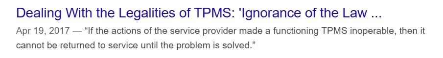

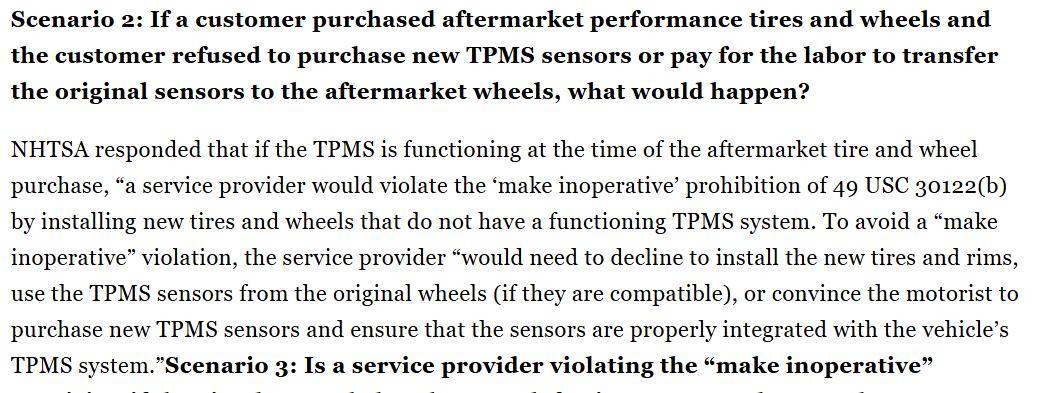

I know this will rub many the wrong way - but Jeep people love the "Lego methods" of Jeeps. and people love their beautiful wheels, even if they aren't exactly right for the vehicle, throwing things off and causing future problems because they were chose for looks, not function or fit into the rest of the suspension and steering geometry.
So - no one thinks of side effects, only "I want this to LOOK good".
But - the selling dealer MUST think of side effects - because it's federal law.
Law states that no dealer/shop can cause a TPMS system to be non-functional.
In other words, whatever they do with that vehicle - the TPMS system must still be operational when it goes out the door. Otherwise, that shop or WHEEL MANUFACTURER, has violated federal law.
The TPMS system is there by law. It's illegal for anyone you pay to work on it, or selling you parts or equipment to cause it to be non-functional.
If you break it, it's on you.
If they cause it to not function, it's on them and they have violated federal law.
There's a lot of "if this, then............" and "not necessarily..........." and "what if this happens.............." in there, it's not totally cut and dried, but bottom line is if it was working when taken into the shop then it needs to be working when it leaves the shop.
(example of an exception - if you were on a trail and busted off the factory valve stem and the TPMS was damaged, and not working, and you took it to a shop - they could technically just put in a plain rubber valve stem because they would not be the cause of the malfunction)
This is from a tire dealer's group -
Jeep Gladiator TPMS unavailable after tire swap 1744813184911-u4
So technically, if the TPMS stopped working due to them putting those wheels on, that vehicle MAY NOT BE RETURNED TO SERVICE until they fix it.
