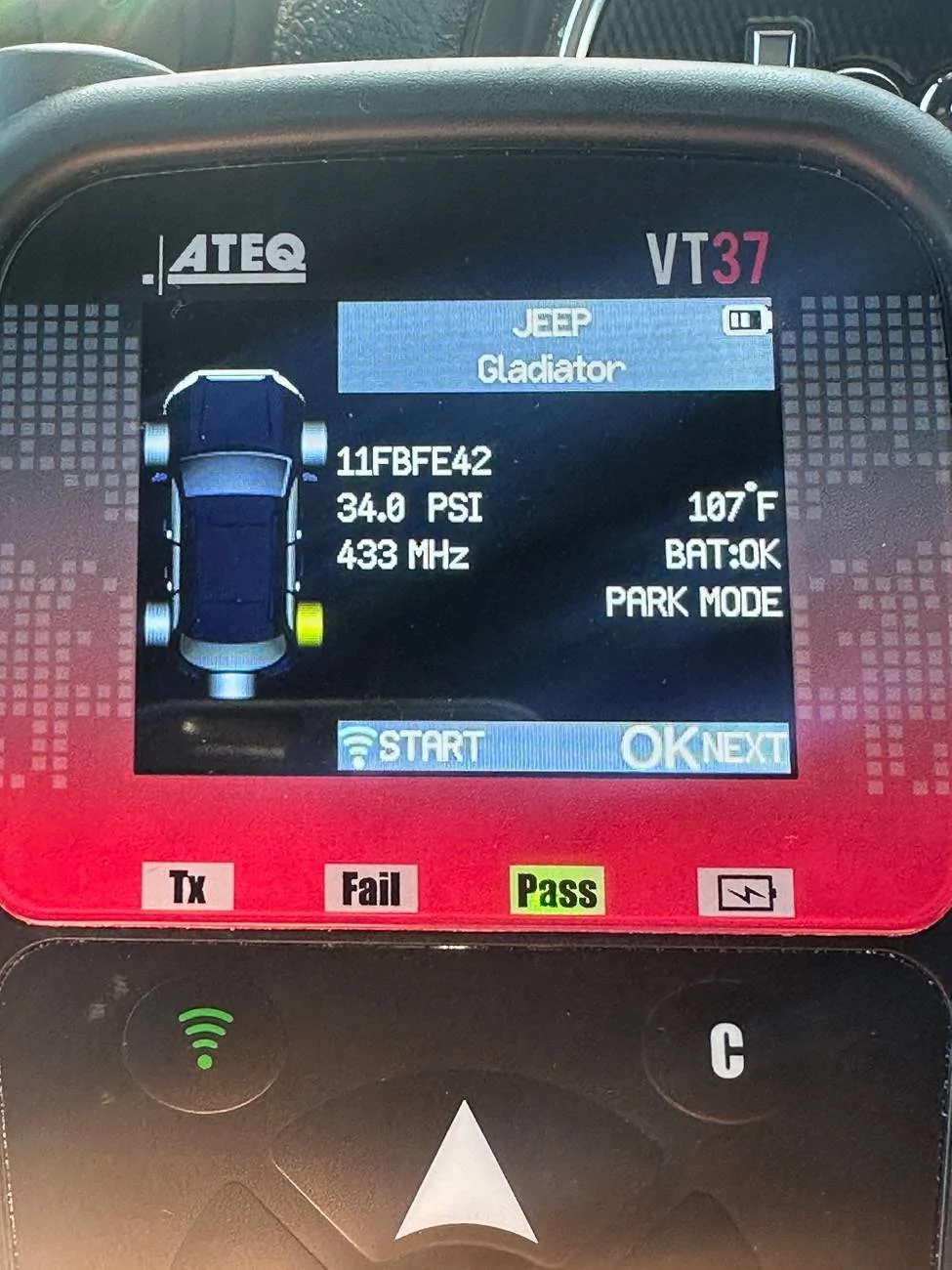

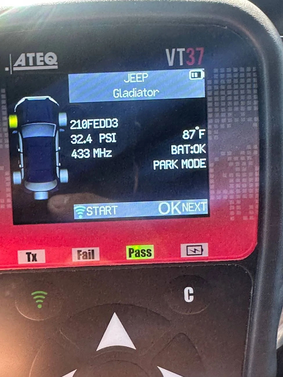

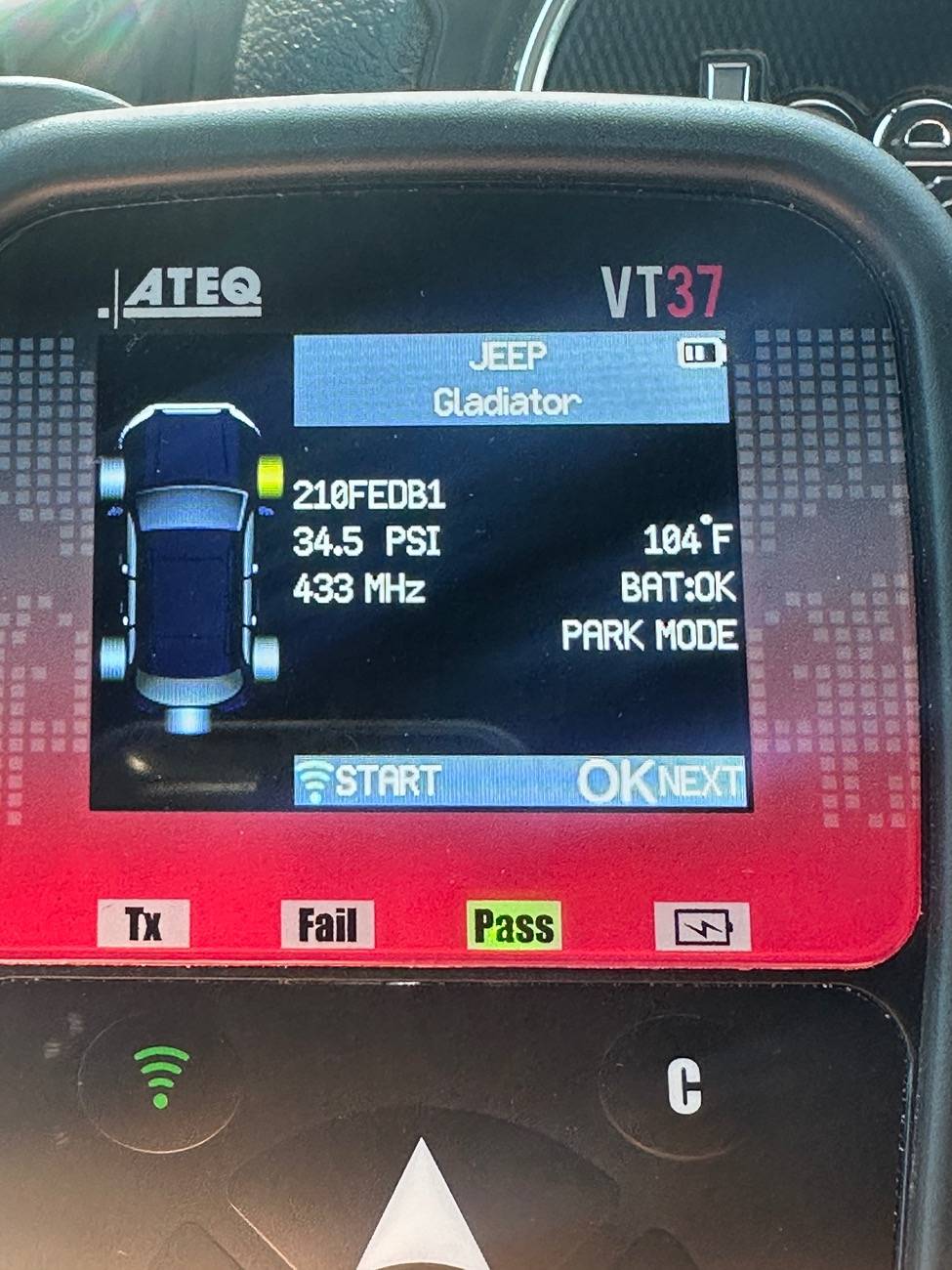

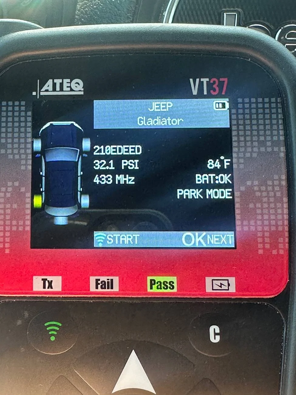

I used the OEM. I transferred the sensor myself. They were working with the stock wheels. Once I put them on the new wheels they stopped working. I’m wondering if it’s because of the offset the wheels have

My wheels are -38 and TPMS works fine. Are your valve stems in the middle of the wheel or out on the edge?
mine are out on the edge, I’m also on 40s. I’m also using the Apex Valve stems

so my wheels have only one valve stem hole, I used the Apex Valve stems with my OEM TPMS. I took of the Torx screw that goes on the OEM Valve stem with the OEM TPMS. And transferred it to the APEX valve stem.

could be, I checked my sensors today with a scanner and they are all reading correctly. On the 2022 gladiators where is the TPMS module located?
