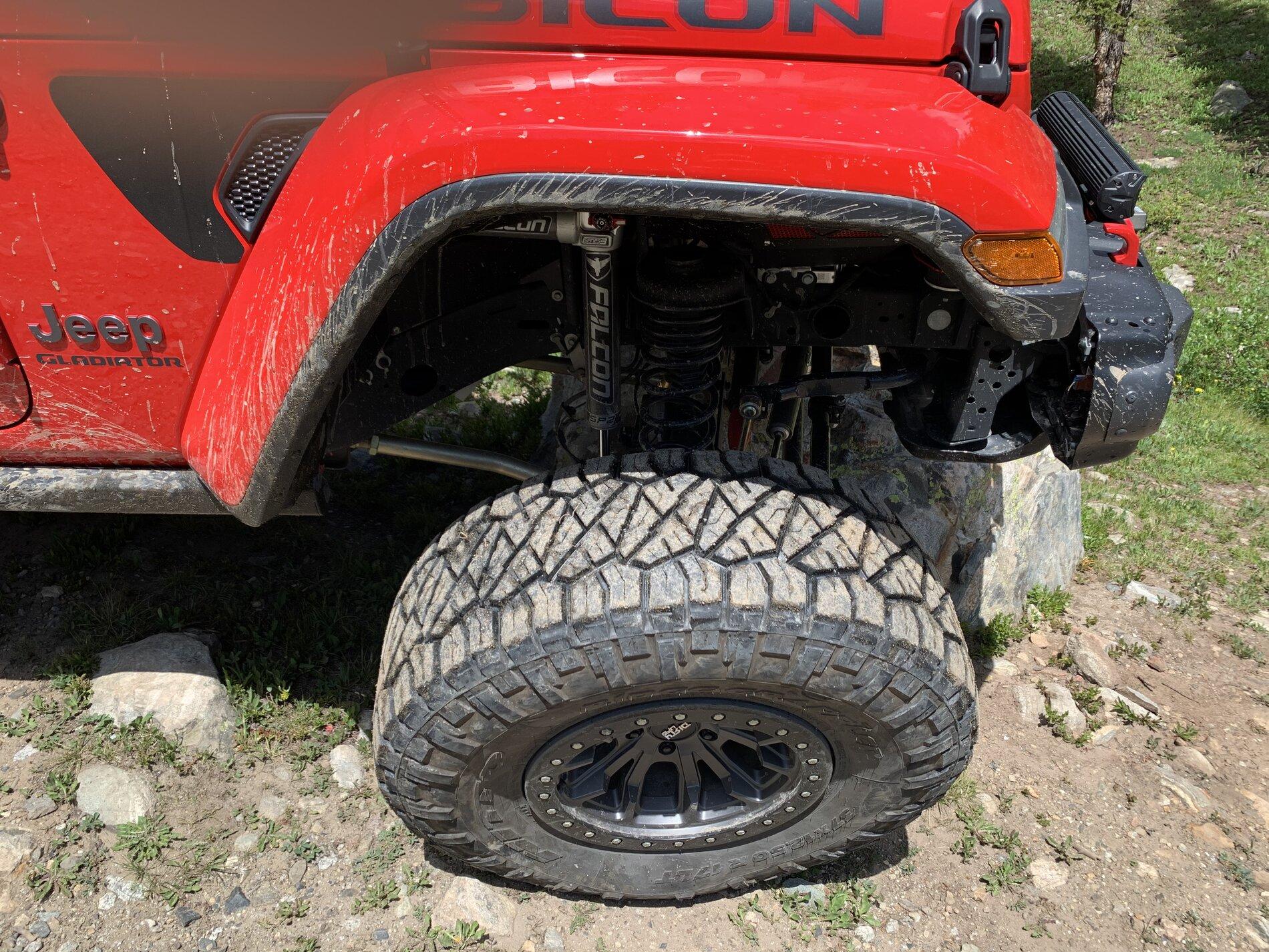

I personally have the falcon 3.3’s and ridden in vehicle’s offroad with the fox shocks. Here’s my personal thoughts…
The falcon 3.3’s are a slightly less comparable than to the fox 2.5’s but better than the standard fox 2.0’s. The falcons do have the the quick adjustment to go from soft to firm (aka 1 or 3 setting) or 8 settings to go from soft to firm (on setting 2). The shocks are a 2.25” with the resi as you know. I’ve ran these shocks on both a JKU build and my current JT, for the money, they are a great shock but are not a shock that you can really set for low speed/high speed offroad.

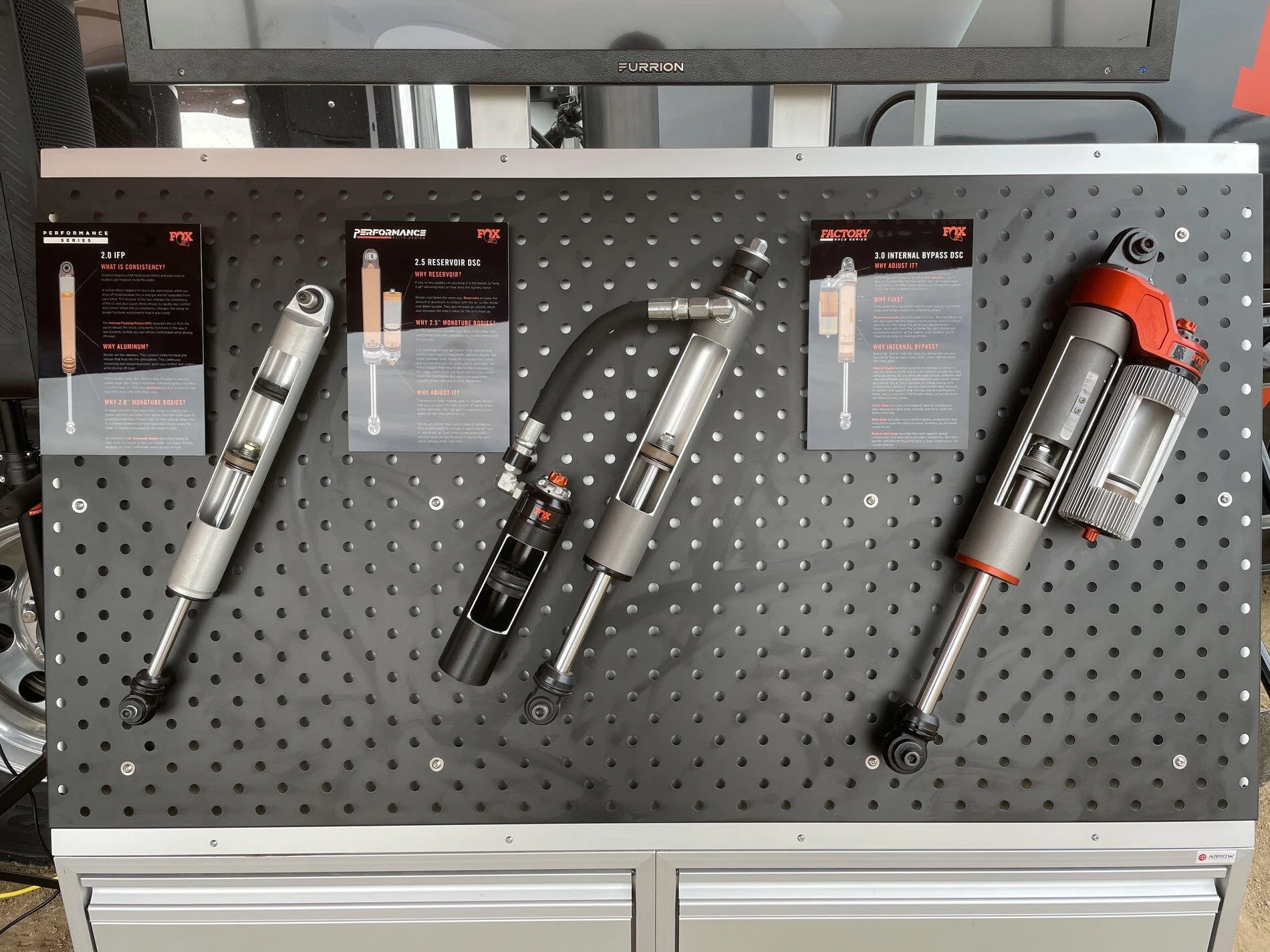

The fox 2.5’s definitely hold more fluid than the falcons but also allow you to control the low speed and high speed valving on the shock… something the Mojave shocks don’t let you do. But with the control you can dial in the ride even more than the falcon 3.3’s so you don’t have to get out and change setting when you want to go offroad or be on road .
I say the fox are definite upgrade from the falcons and are worth every penny. They will be on my list of upgrades later on… maybe even the 3.0’s too
oh and here how I have the shocks in order from good to best. Fox 2.0’s, falcon 3.3’s, fox 2.5’s, fox 3.0’s.
Good luck on your decision.
