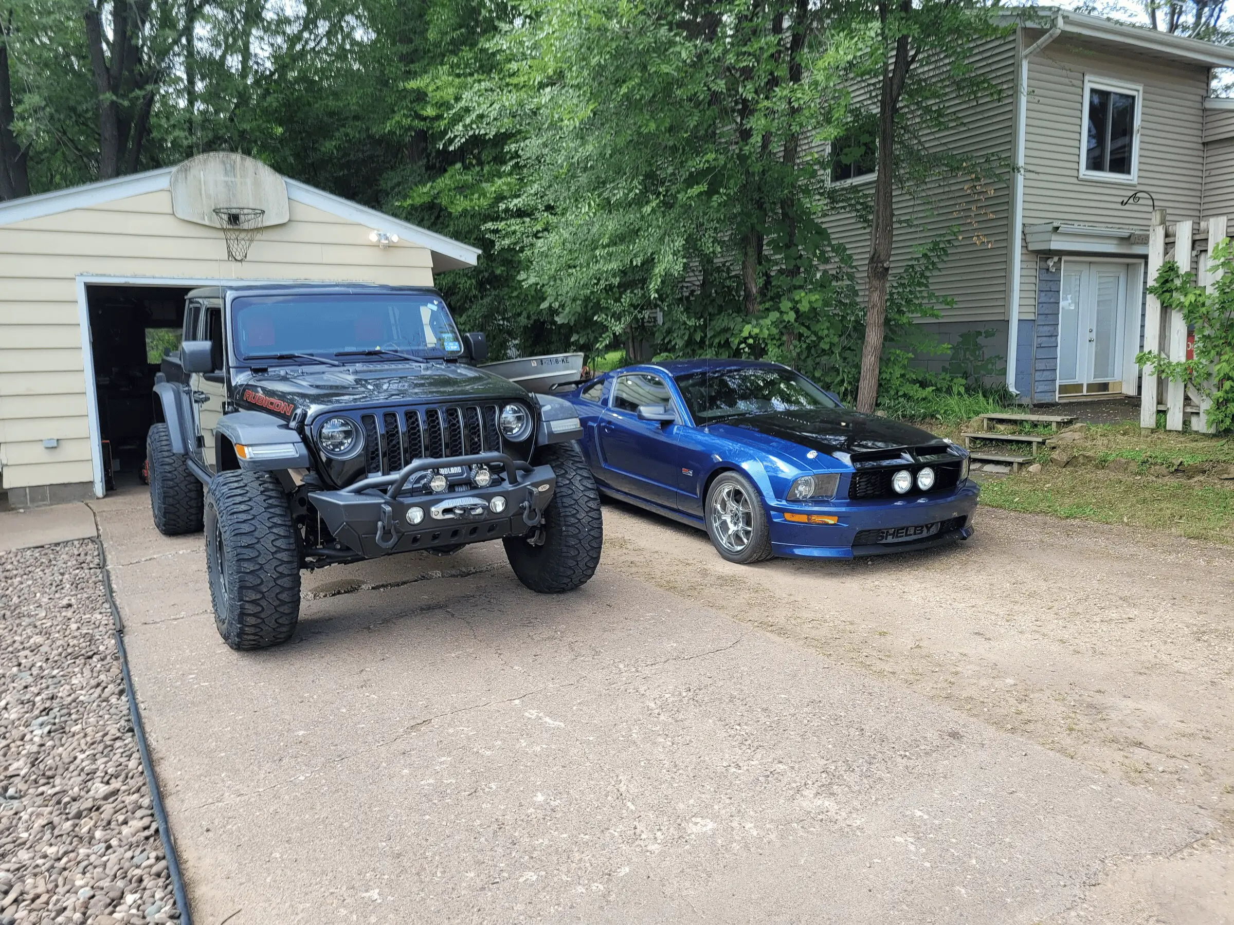

This pic is me on a Mopar lift and 37's TBH I think 2.5" & 35's are the perfect set up for this Jeep.
I see that picture and it confirms I made the right decision at 3½ and 37s. Too pedestrian for me.
I do love your color scheme and those sliders/ beadlocks!

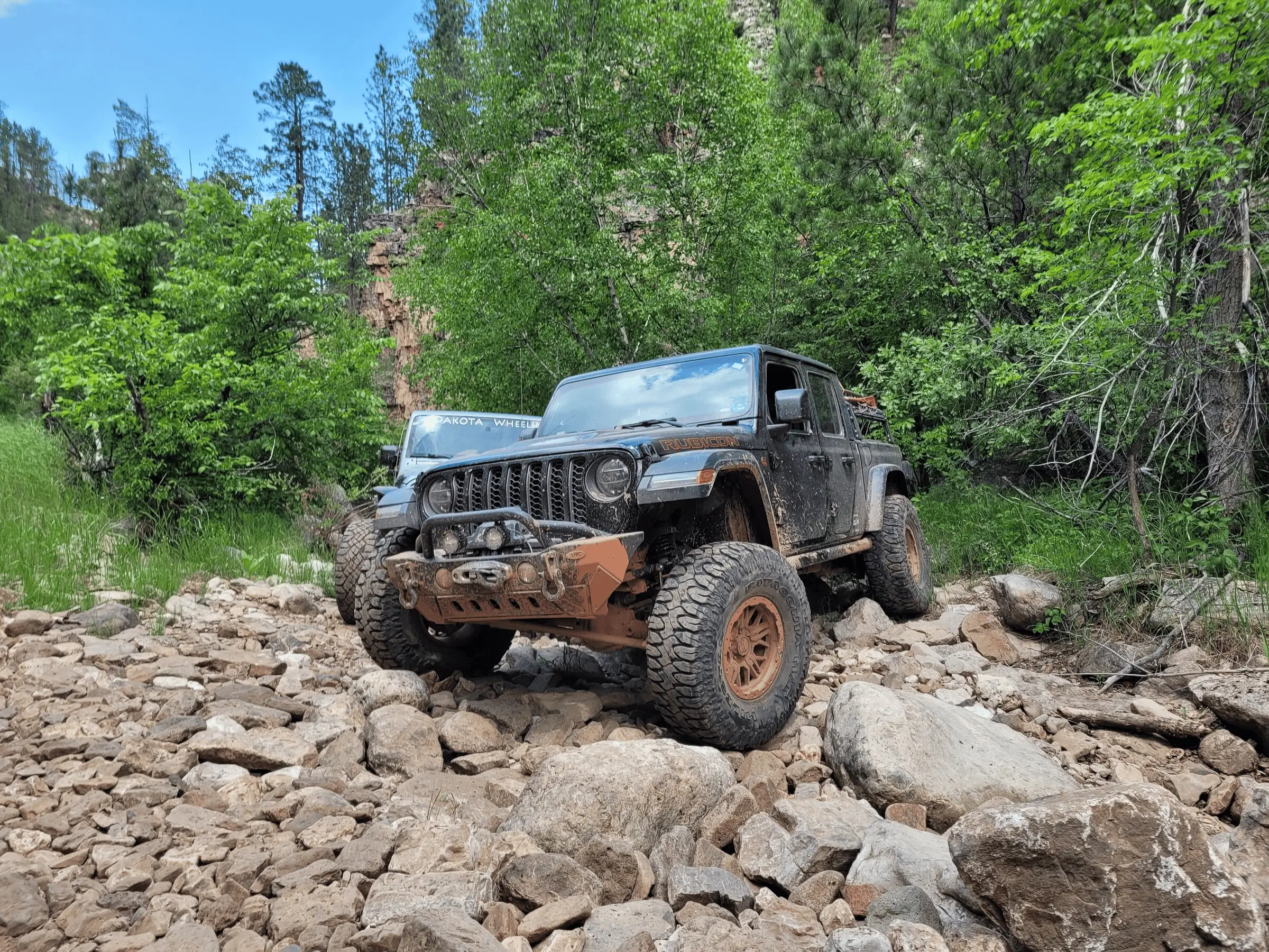

Here is my old one with 3.5 gamechanger and 38's the ride was awesome, I did however change out the rear springs later on because for my purposes the metal cloak springs were too soft when using my trailer or packing it up with gear so I installed Clayton 3.5 inch overlander springs in the rear
I'm liking this pic VERY MUCH because it looks a lot like the build I am in the process of. I will install the MC 3.5 Game Changer, BFG KM3 39x13.5, and a similar bumper style to the XRC 2nf Gen. I will explore spring options, thanks for the heads up. How was the tire clearance, any fender trimming required to avoid rubbing at full turn/tuck?

I did not have to fender trim but I do have aftermarket liners. The only thing I found was to make sure you set the bumpstops because with the gamechanger it will flex until the shocks run out and then you cant turn because your tires are up against your inner fenders when purched on a six foot tower rock. oops LOL. Black Hills jeep Camp 2021 5+ trails

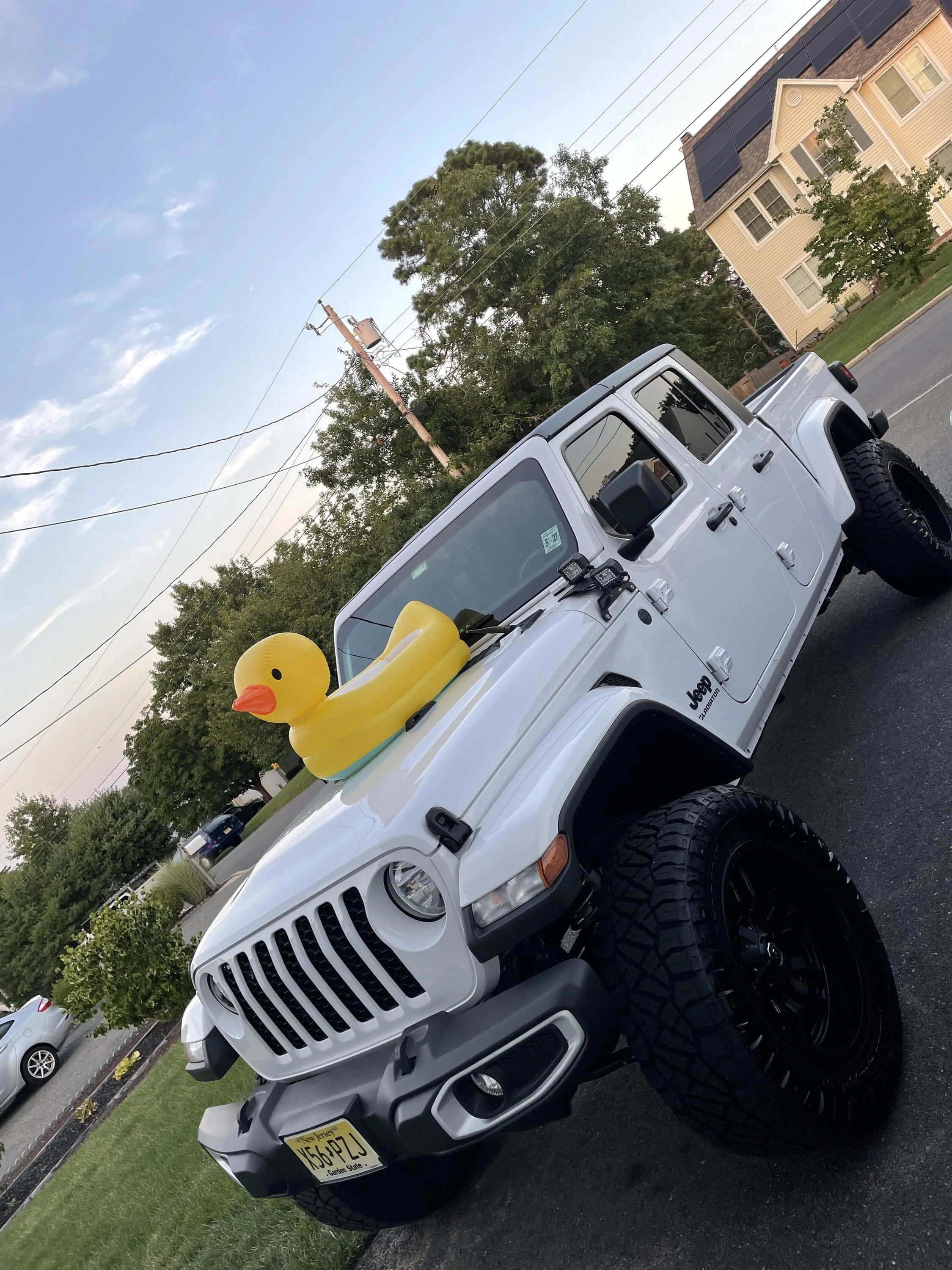

I cant make up mty mind between a 2.5" and a 3.5" lift for my 2022 rubicon diesel gladiator. Ill be running the 37 k02s that are more like 35s I guess. Also in winter Ill prob be running a studded 35. This makes me lean towards the 2.5", but I do like how the 3.5" kits look.
I just moved from sea level to colorado. my house is at 8300' in evergreen with a long triple switchback driveway with southern exposure. Im going to work on the driveway but sometimes it does get iced up. the diesel doesnt have issues in the mountains so far, gets 25+mpg. I plan for this to be my daily right now, going to sell a grand cherokee i have. In a year or so Ill probably get an electric car for a smooth nice ride so the gladiator will be for snow or rain days, or just using the bed. It wont have to get the best ride but I would like as good of ride as possible. Ive heard many say get the steering stabilizer and pedal monster for the bigger tires.

3.5 inch on 35s 20 inch rims

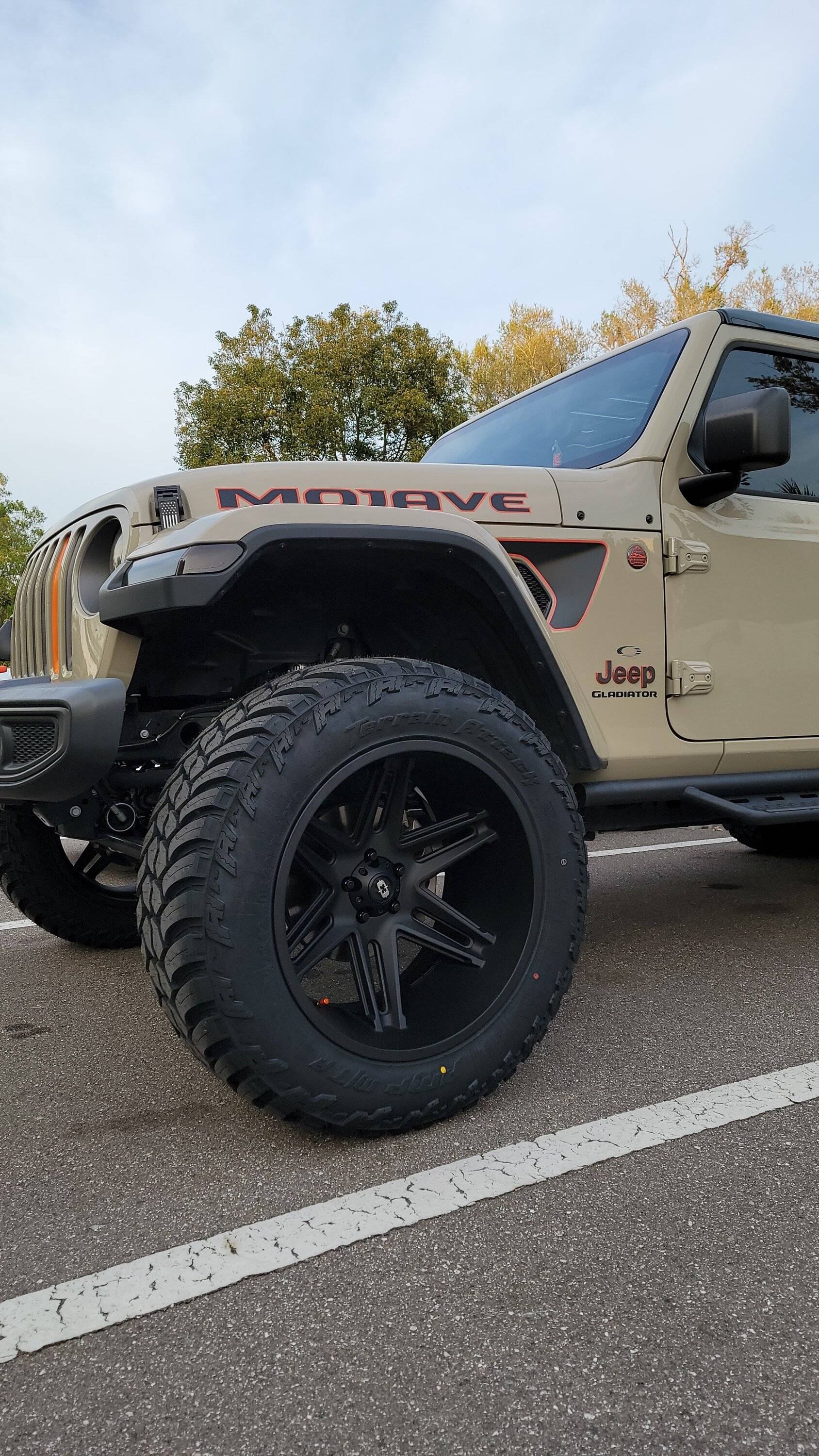

2.5" Skyjacker here on 37's on 22×12s. Plenty of room for 38's if I wanted. Adjustable track bar and LCA brackets too. The ride feels like factory almost. 2020 Mojave
