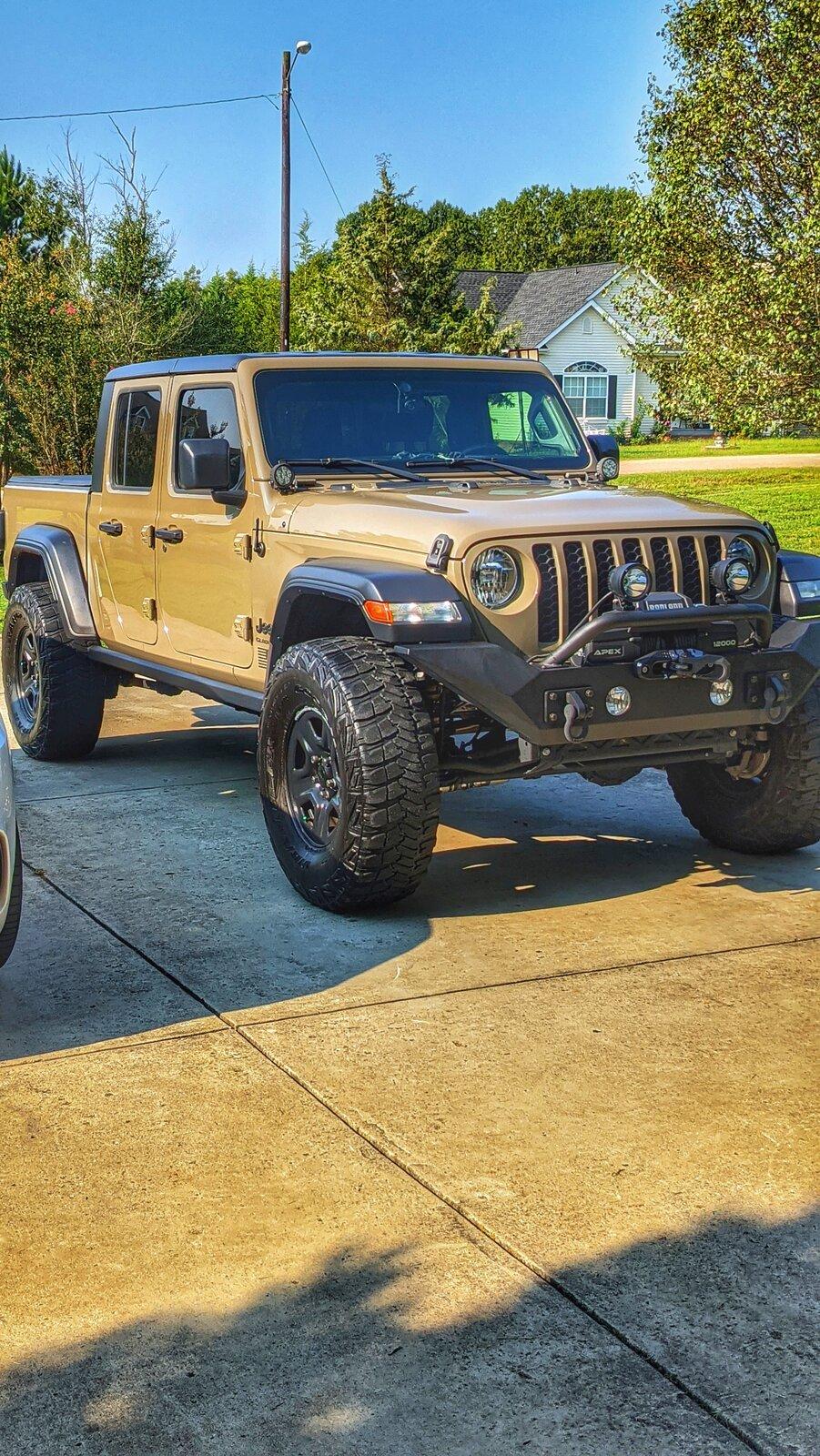

I got a 2.5" Readylift SST lift kit on mine with Rubicon take off front springs. Kept my Rear Max Tow springs but that gives you about 3-1/4 up front and 2 in the rear and it looks like this on 37's. Rides and drives great. I'll be adding a adjustable track bar soon but other than that all I did was add Geo Brackets to control arms. Also Fox Steering stabilizer.
Jeep Gladiator 2.5-3.5" lift With rear spacers PXL_20210825_134024483.PORTRAIT-01

Yes factory wheels. I got a Max Tow with wider axles like the Rubicon and Mojave so no they want rub with 37 12.5 17 tires. I am running 1.75 inch wheel spacers now but I ran 315 70 17 tires on them with no spacers and had no rubbing at all. If you don't got the wider axles then you will rub on the lower control arms.
Panthers65
Brent
Aug 23, 2021
46
574
593
Atlanta, GA
NA
Account Manager
Awesome, I'll have the max tow as well, still bouncing back and forth on aftermarket wheels or not. I actually really like the look of the factories
Jeeperjamie
Jamie
Feb 12, 2020
135
4,754
5,412
Kannapolis nc
2020 jeep gladiator
Weyerhaeuser
Me too! That's why I stayed with them and added spacers. If you got the stock black ones like me then I think it's a good look. I found a set like mine for sale local to me for $75, I'm considering buying them so 8 got a spare set in case one of mine gets damaged.
I only added the spacers to get a wider stance. I rode on the 315 70 17 wheels for about two months with no spacers.

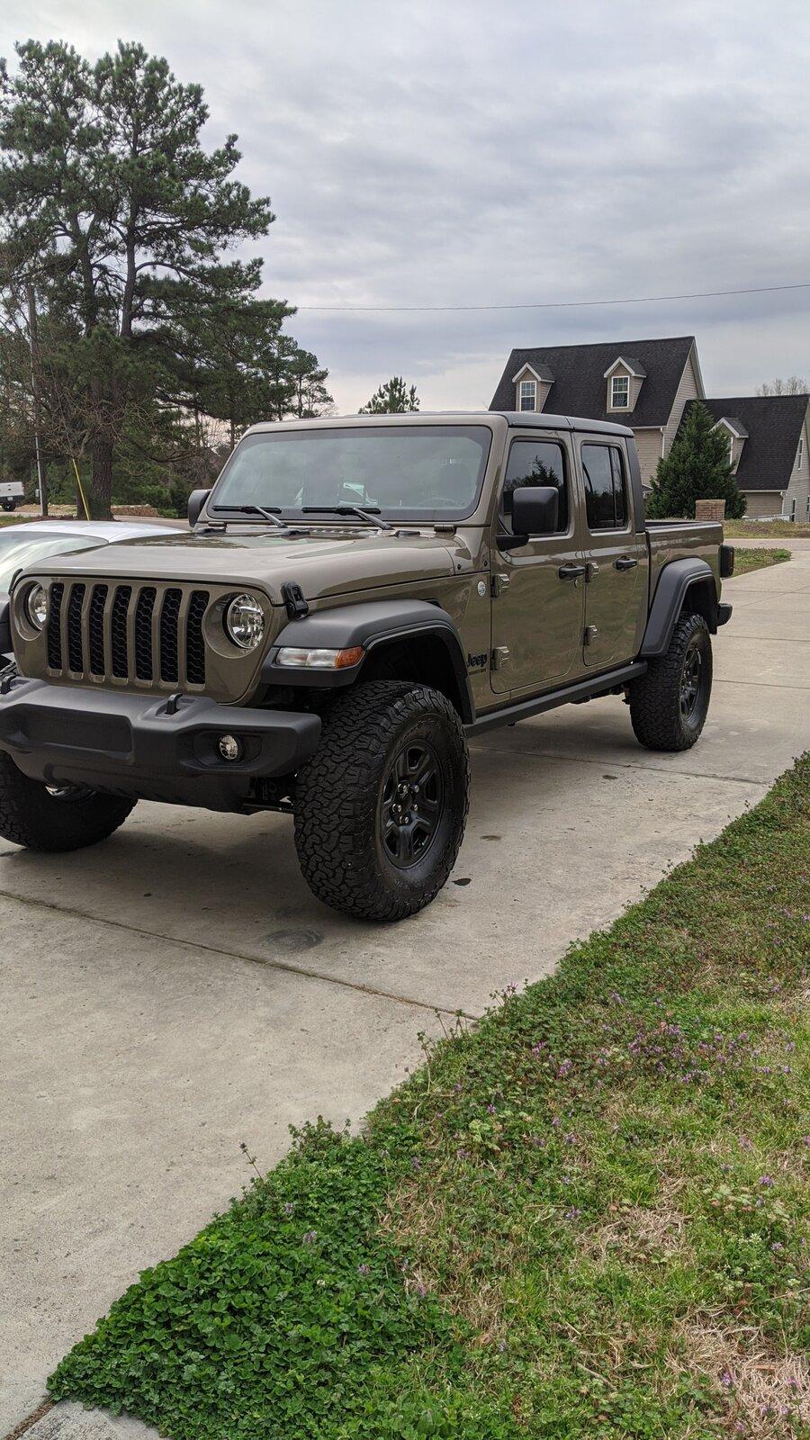

This is what it looked like with just the 2.5" Readylift SST lift kit installed and 315 70 17 BFG KO2s no wheel spacers.
Jeep Gladiator 2.5-3.5" lift With rear spacers MVIMG_20200315_104758
