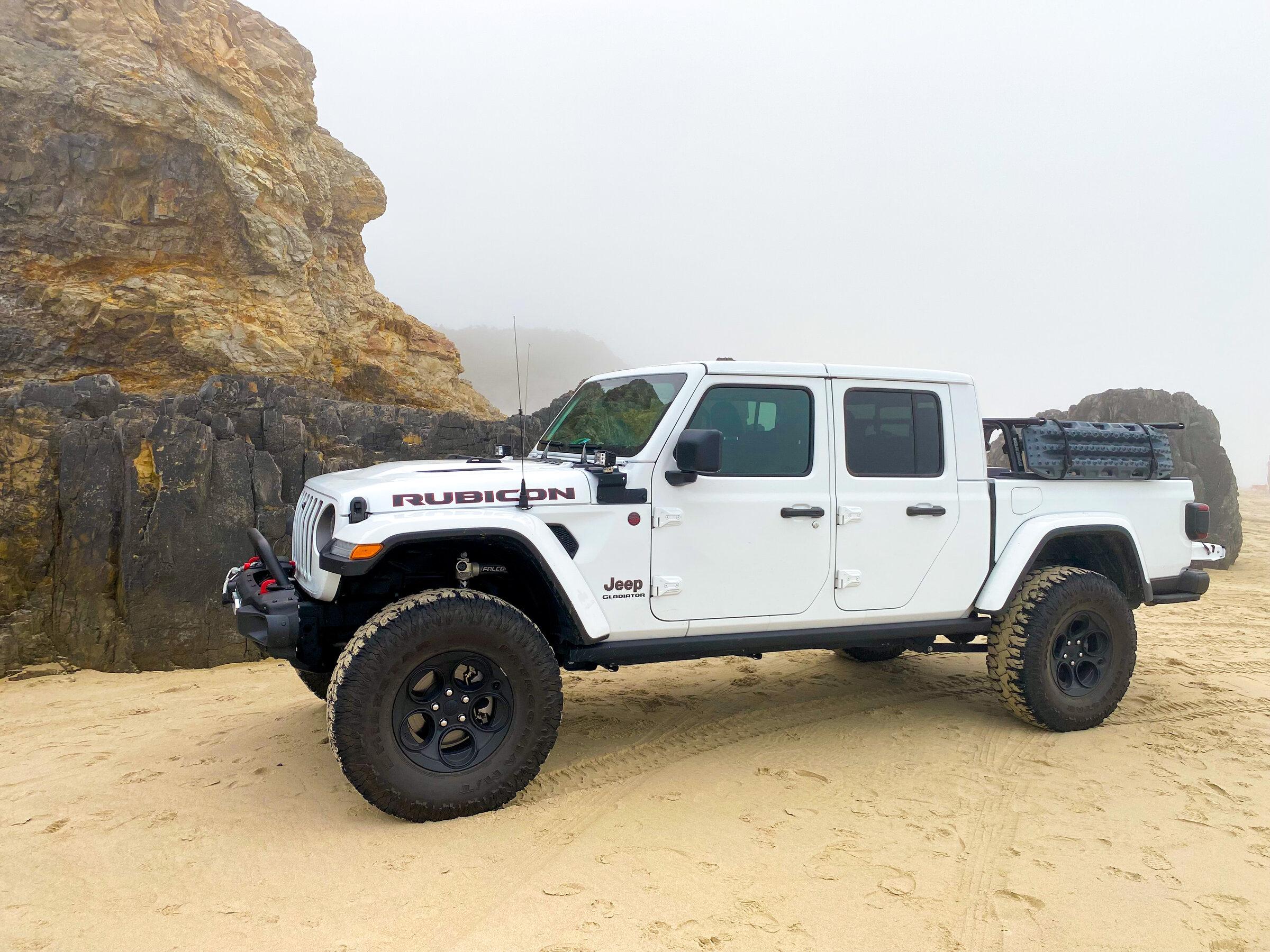

I’m running 2.5” evo coils and I like the ride paired with my falcon sp2 shocks. I was about to pull the trigger on the Clayton 3.5 but couldn’t help wonder if there is a downside to just throwing in some 3/4” spacers to get a little bit more clearance on my break over or bumper.
Would you go to 3.5 coils or just add spacers ? Running 37” tires.
