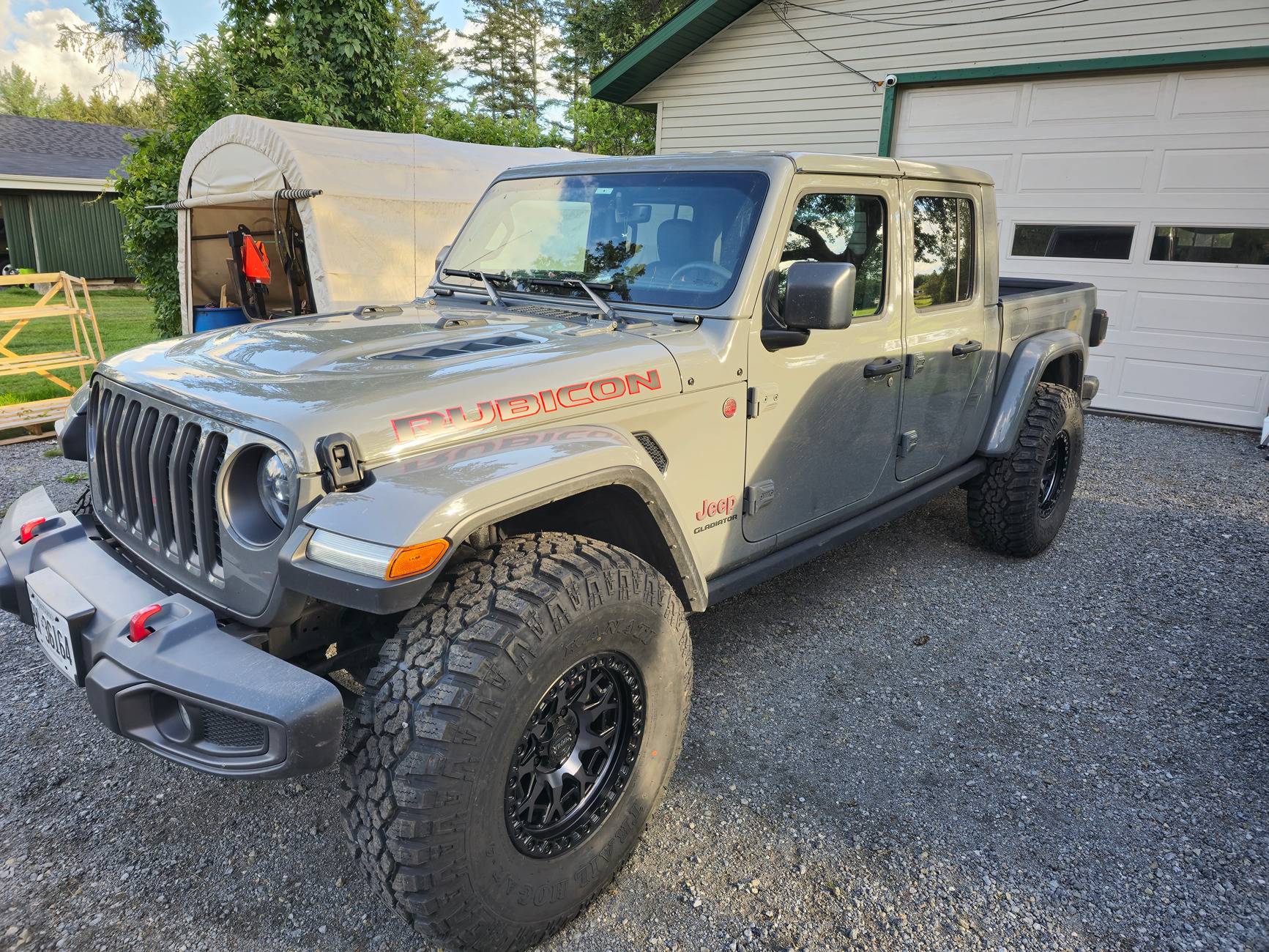

Just installed 37" Kanati Trail Hog AT that measure 36" when on vehicle. I don't do any rock crawling and 95% on road driving with the other 5% bein dirt roads driving to lakes or fishing. Should I do a 2.5" or 3.5" suspension lift and what are your votes for top 3 kits under $700 and top 3 kits staying between $700-1000??​

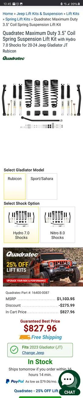

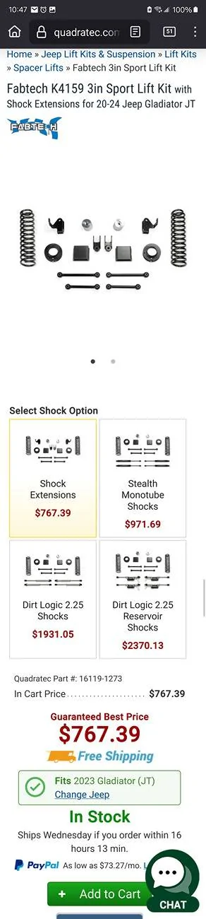

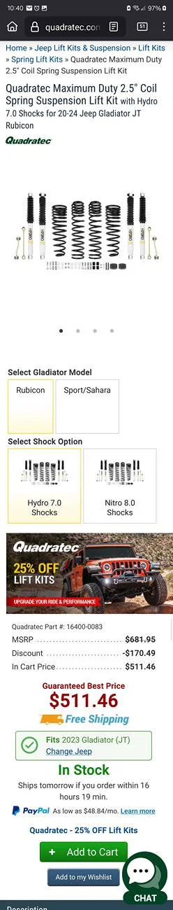

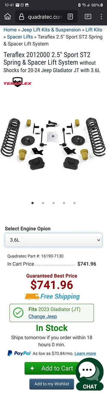

What about these 2 kits.​

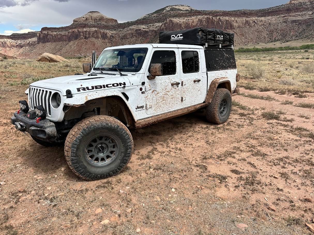

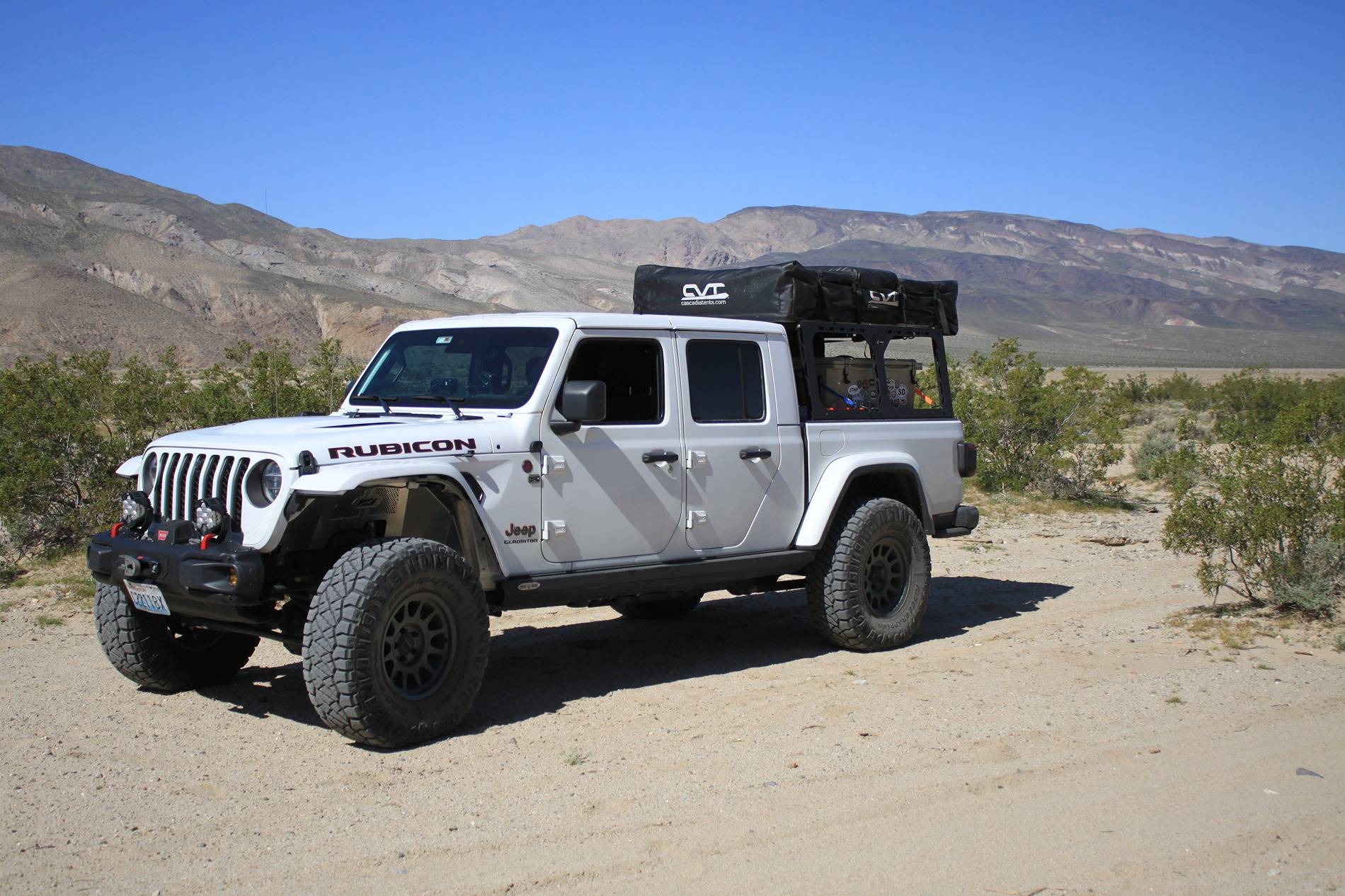

It really comes down to personal preference. For me, I knew that the Jeep would be going on long road trips with a rooftop tent. Because of those two things, I wanted a minimum lift to clear 37" tires so I went with a 2.5". For reference, this is a 2.5" with 37" Nittos. For an inexpensive lift, you could just go with a spacer lift if It's just on pavement and dirt roads. Down the line, you can upgrade the lift you're able to. If you would rather not have a spacer lift, then I would go with the Taraflex kit and reuse you're shocks. Just make sure it has brackets to relocate the shock mounts.

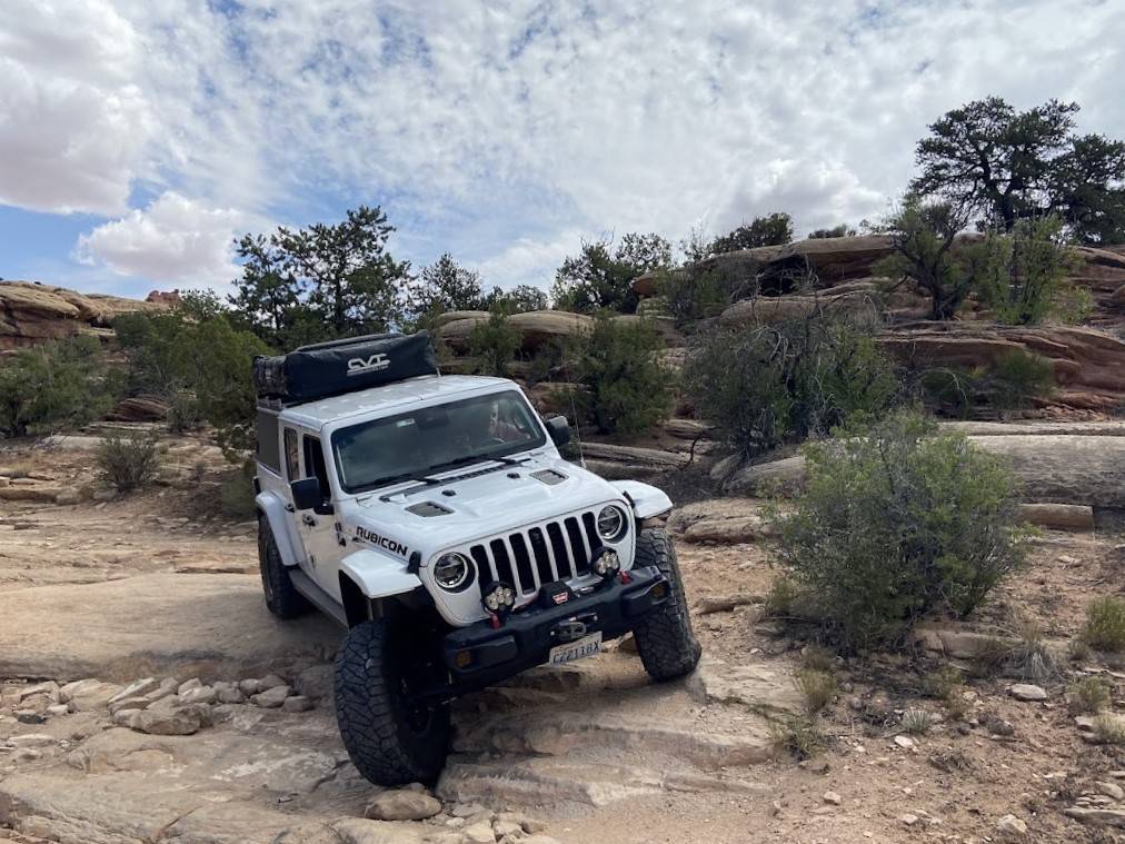

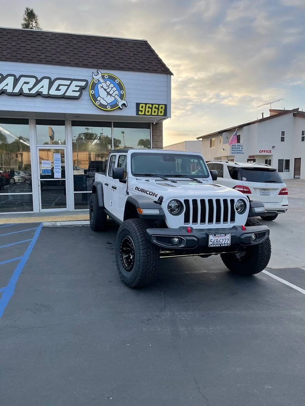

I went Metal Cloak 3.5” lift but I do rock crawling in SOCAL. If I wasn’t I’d be happy with the 2.5” lift but on a Rubicon you effectively getting an extra 1-1.5” since it comes stock with a small lift over the Sport.
