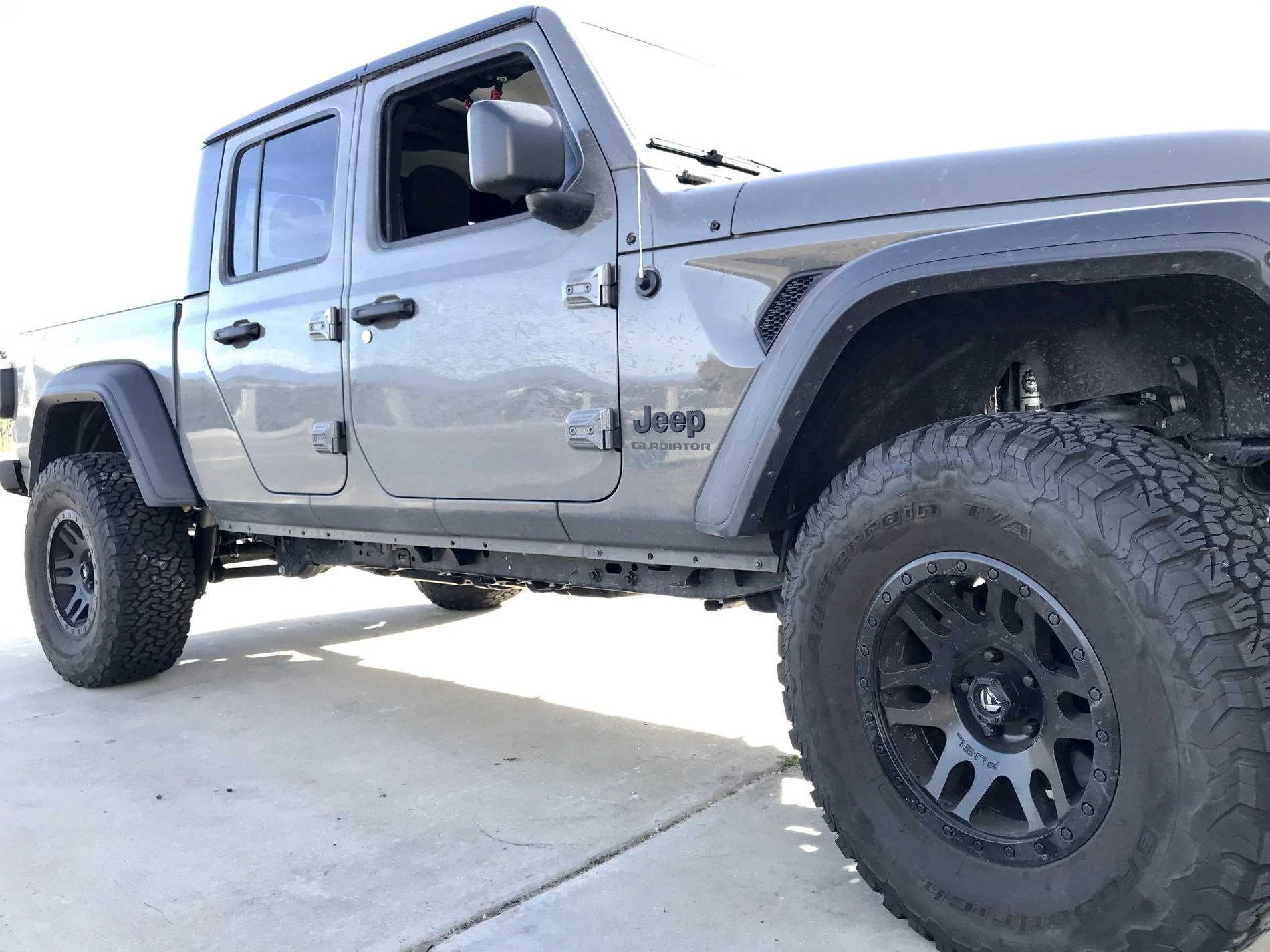

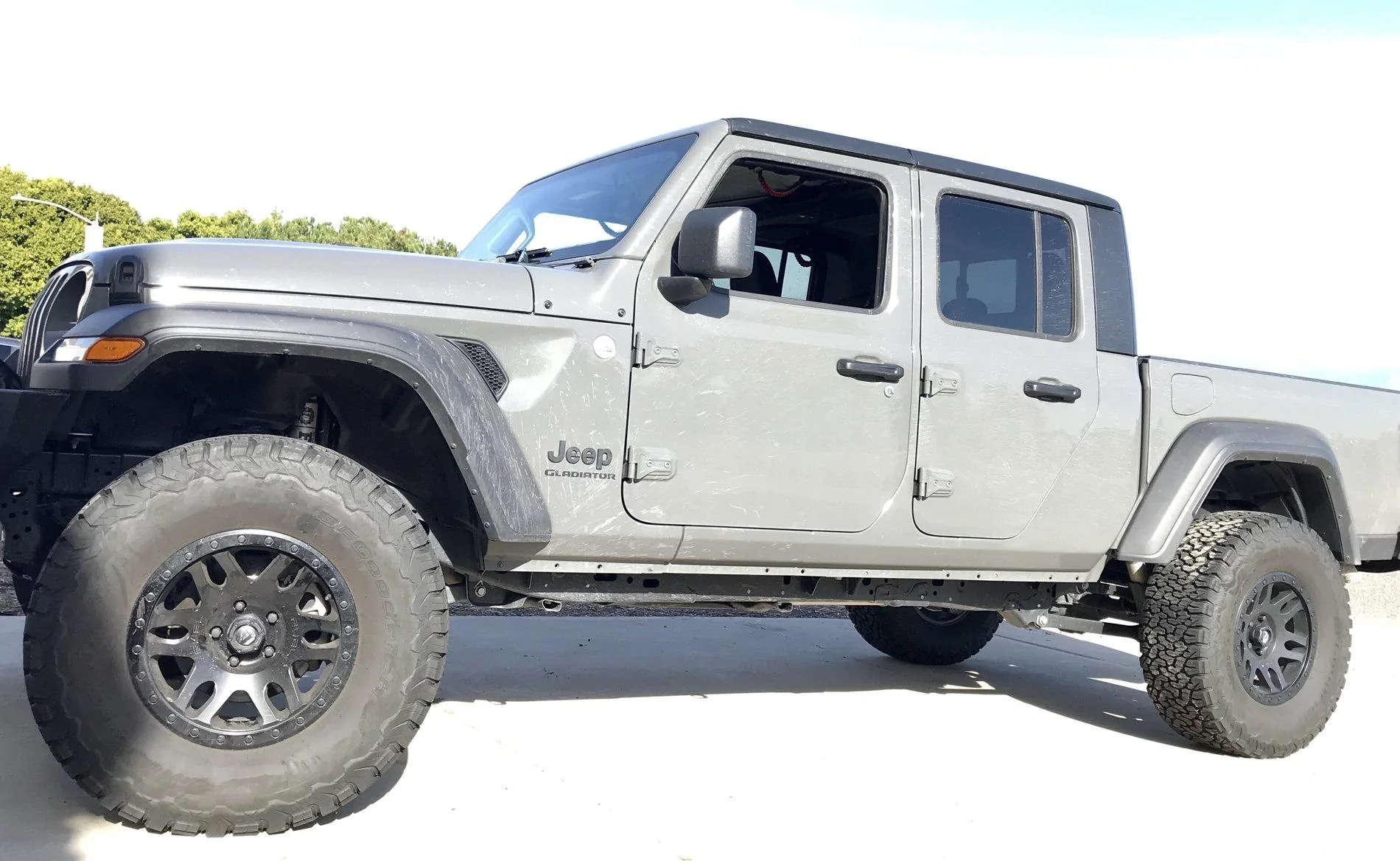

Just installed 1” front spacer on my 2” Mopar
lift. After installing steel bumper/winch I gained about 175lbs up front.

Looks awesome! From pics it looks level. But is it level? Have you measured it? Any difference in driving from lift vs lift/spacer?

Thankyou! So sorry, but I didnt put a tape on it prior to install, it feels close to level and looks just slightly close to level with a hair of rake. I know, Im a horrible historian, I told myself to document the measurements before and after but just jumped into it. I might have some from last week but need to go look it up to see.

No worries, I usually do the same myself.
