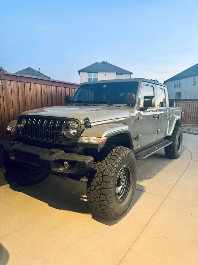

I Extended/leveled my mopar lift with 1.5” teraflex spacers up front and 3/4” daystar spacers in the rear.
Also installed Teraflex alpine adjustable lower front control arms, a Teraflex adjustable front track bar and shock extensions.
I gained quite a bit of length and it rides a lot smoother!
Looks great.
I'm thinking this will be my exact route as well. I have the Teraflex spacer in already and the rear Daystar spacer as well on stock springs. I'm assuming those are 37"? Looking to buy just the springs and then build out the rest of the lift with the components I want.
Yep they're 37s. They measure at 36.6 exactly.
I just went with shock extensions, but once they wear out, I'll probably get new springs and shocks.
