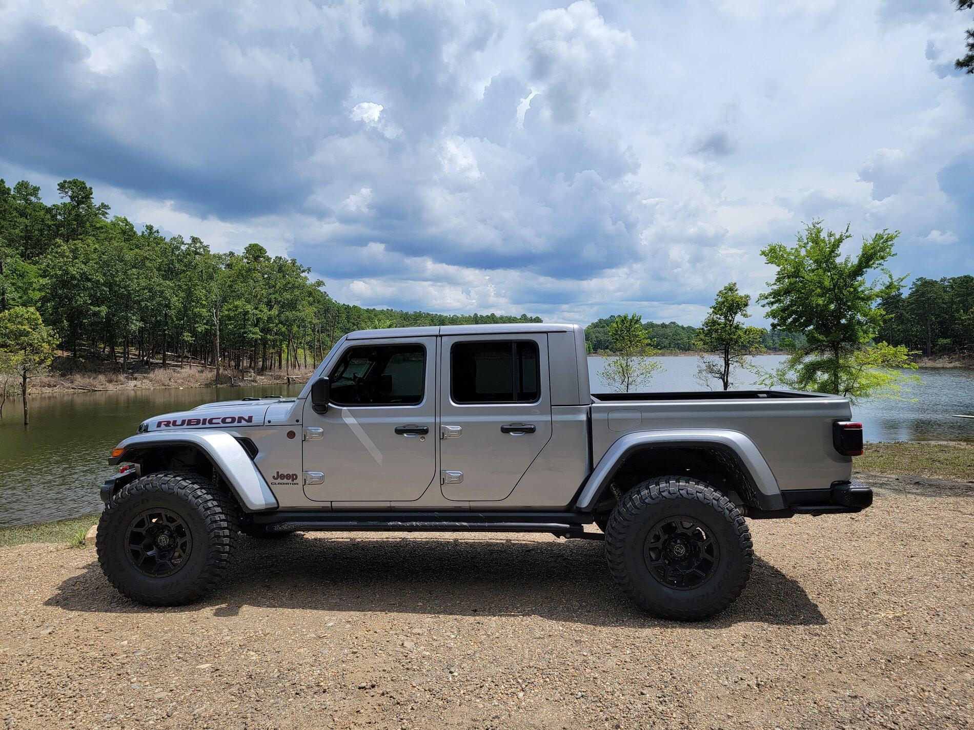

I have the Mopar lift with 37's.
It's perfect for the off-roading I do, but I plan on adding a few additional pieces that this kit doesn't come with (adjustable track bars, heavy duty ball joints, etc.) because I plan on keeping this truck for a while, and I want to just beef it up slightly more than what the Mopar kit provides. As others have stated, there are better kits out there. Just depends on how you ultimately want your truck to perform. Not saying you're trying to turn your Rubicon into a Mojave, but if you like the ride of the Mojave that much better, maybe consider trading?? You can dump a ton of money trying to build a "Mojabicon", and ultimately still not be pleased with it.
I notice it looks like there is a lot of rake on your truck in that pic. Lift is on the way to me as we speak. I’m wondering if I should buy the leveling kit in addition to the 2” Mopar lift now? Anybody? Is it necessary if I don’t want rake?

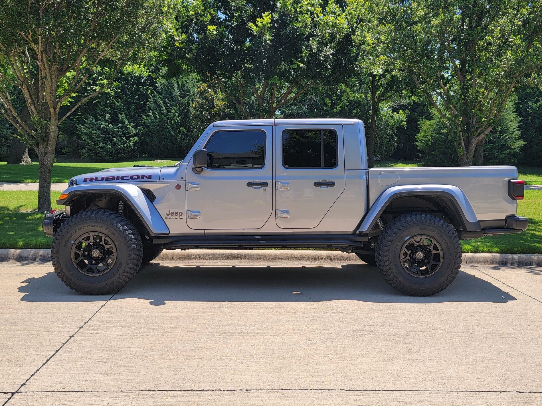

That photo is a little deceiving because I was parked on uneven ground. Here's a pic on level ground. There is still some rake though. I'm actually considering installing a leveling kit when I have my heavy duty ball joints installed. I don't mind a little rake, but I'm not trying to make it perfectly level either. Just depends on what look you're going for. Measuring to the bottom center of the front/rear fenders, my front sits about 1.0" to 1.5" lower than the rear. Hope this helps you make your decision.

That photo is a little deceiving because I was parked on uneven ground. Here's a pic on level ground. There is still some rake though. I'm actually considering installing a leveling kit when I have my heavy duty ball joints installed...
I'd just leave it as is. It looks great.
