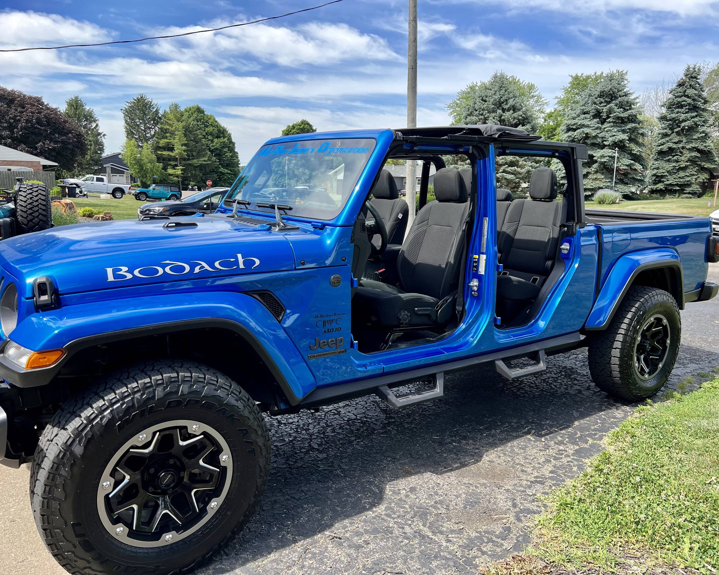

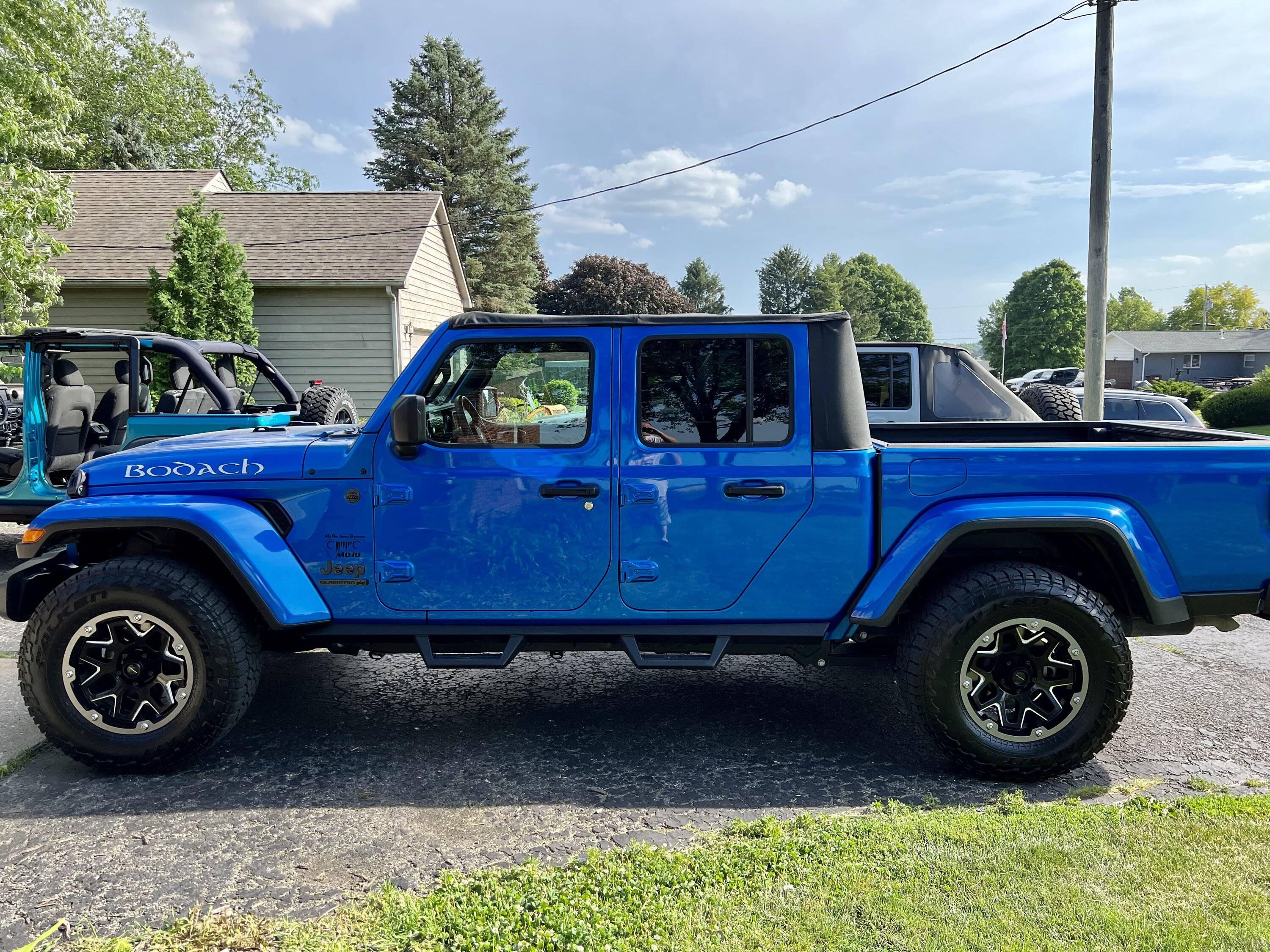

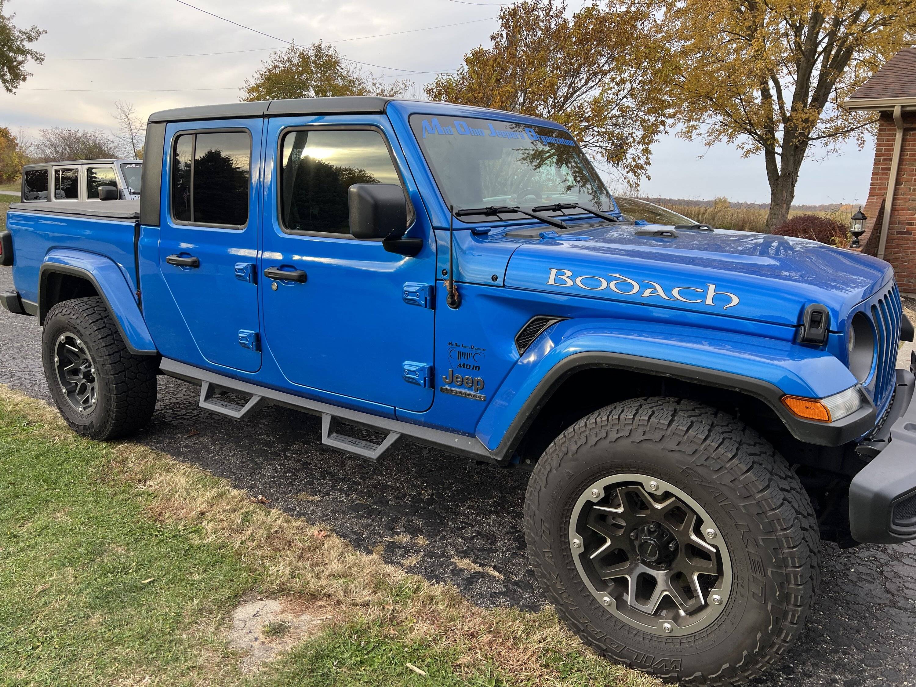

I wasn't sure if anyone would remember that I had a white 21 Gladiator Rubicon before. Then switching to the 22 Ford Ranger Tremor and getting back about 10 grand on trade to help support my need to take care of my one dog's knee surgery's. Damn that was expensive to help her walk. This new black Sport S is a great Jeep and as much as I would like to lift it and after reading all these replies, I may just leave it stock, for now anyway and do a small level with a spacer lift later. Yes, the $$$ saved on gas mileage does make a difference when not working anymore and being retired. Plus, the wife is going to retire soon and wants to travel. Dammit...LOL!!! Now if the economy gets better and I go back to work, then you never know what may happen. Pics below and thanks for the welcome back :like:
