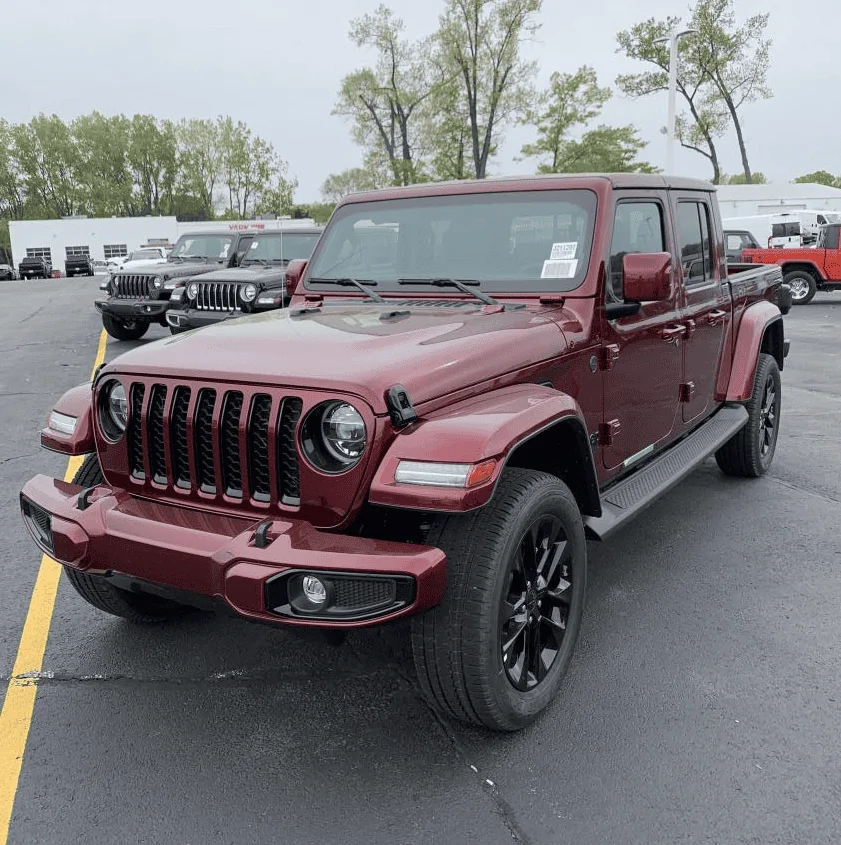

Well I guess I am different here. I am retired and 68. Went the Overland route. I added Line x, Tonneau cover and mopar mudflaps. I get 21- 22 mpg around town and 25-26 on interstate here in Colorado with higher elevation with 85 octane gas. I think I’m staying with this. Larger tires and lift hurt fuel mileage, power and ride for sure. I don’t off road really so what the heck ? this thing rides great,handles good and performance seems good . Why mess with it especially while it’s under warranty ?

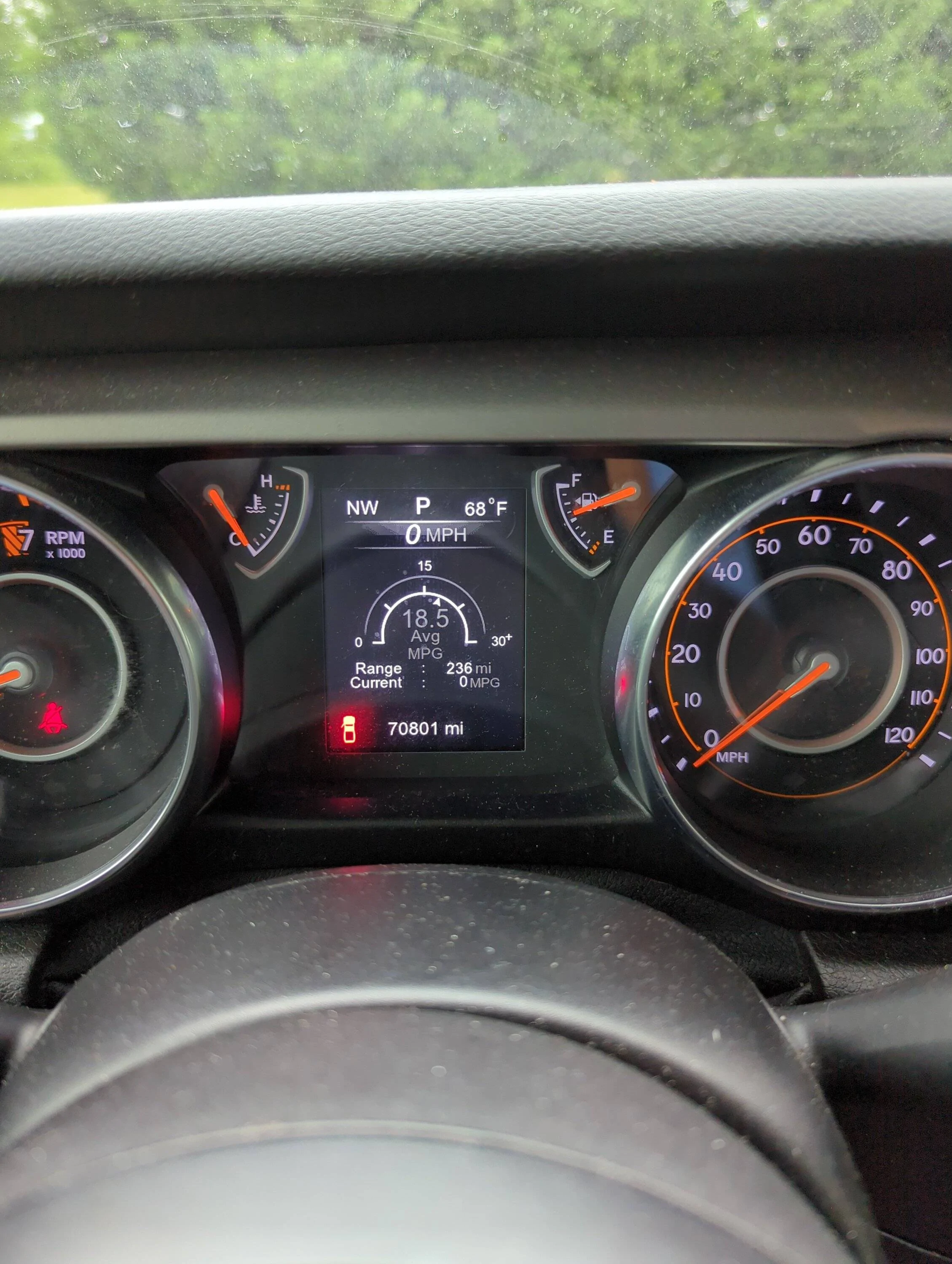

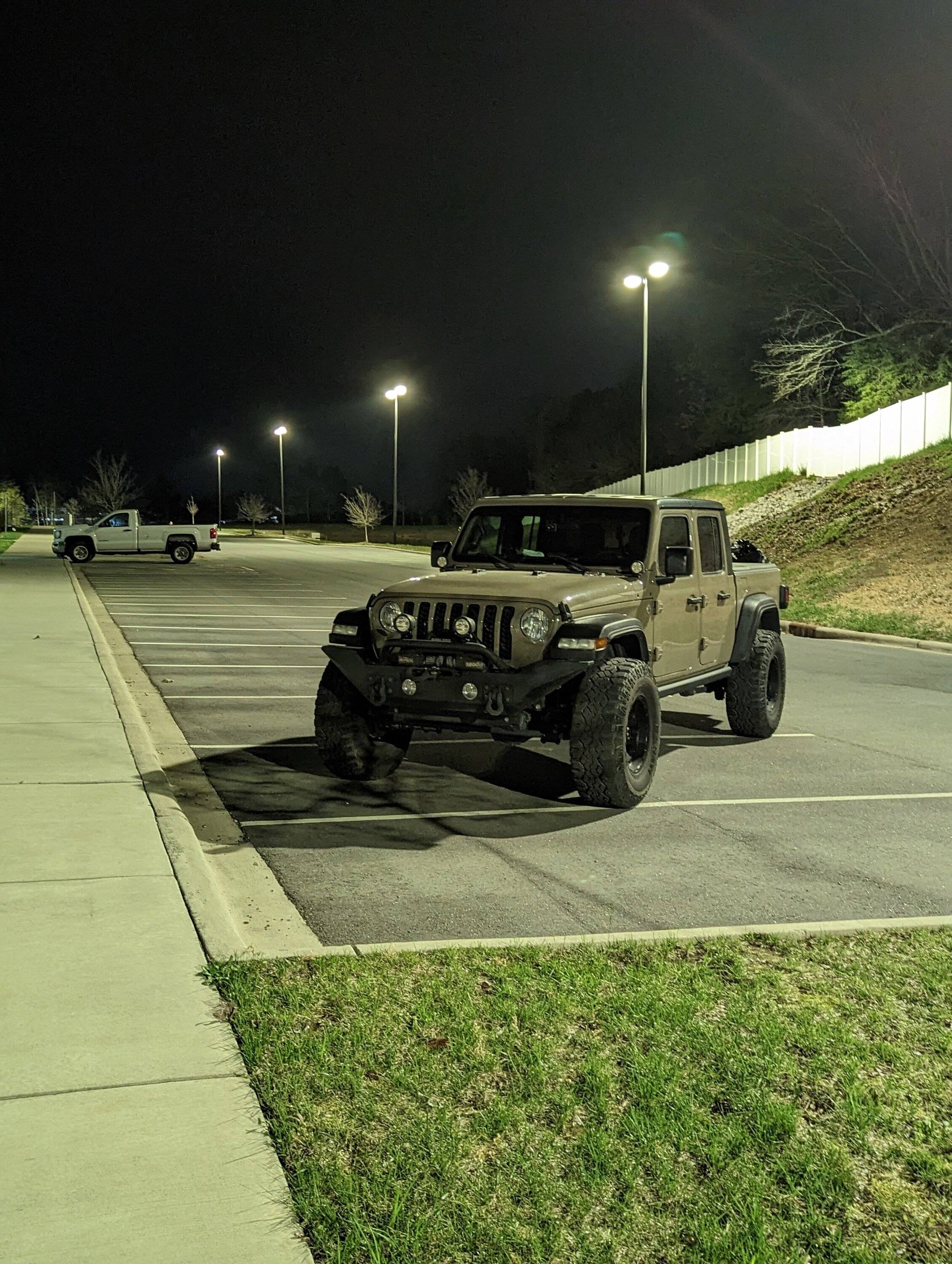

Your gonna lose MPGs if you lift it. You got to decide what it's worth to you. I get 17+ I'm mine lifted 3-1/4 inches on 37's. I also have a Max tow with 4.10 gears. We averaged over 18 overall on the way to the Mountains yesterday there and back total. Was around a 4hr round trip plus the 4 or 5 hours we rode around while up there mine looks like this but everyone's MPGs are gonna be different based on weight, bumpers and tires, brand and type etc. Also driving habits come into play as well.
Jeep Gladiator Should I lift the Gladiator or not? PXL_20230310_061643019.PORTRAIT
Today's average after yesterday's trip
Jeep Gladiator Should I lift the Gladiator or not? 16835525793764977377645899585718
You can ask 100 different people what their MPGs are and 100 different answers. You gotta decide if it's worth it to you or not to do it. If you don't need to lift then why do it but if you want the look then there will be compromise. To me I had goal as far as running 37's before I bought the JT. I said if I could get at least 17 MPGs on average then it was worth it to me and I put a lot of thought into my build with that in mind. Researched weight of tires bumpers and winch before putting them on and chose a more aerodynamic front bumper as well. In the end though if your looking for validation then you can definitely get it here, I say do it.

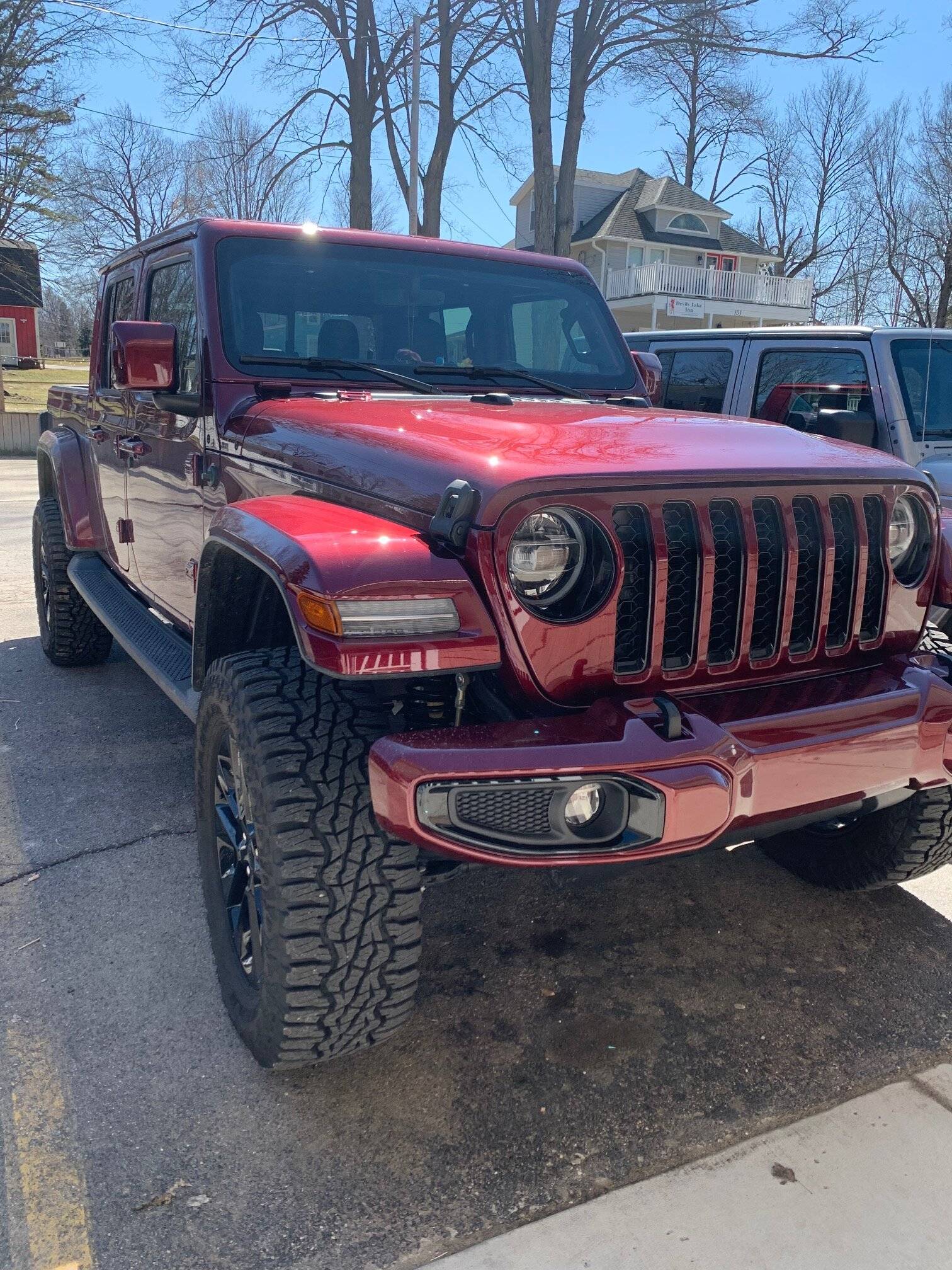

So just to give you an idea, here is my JT….
80th Anniversary Edition which is based off the Sport.
1.5” Teraflex Leveling kit (which is around $100)
Vision Se7en wheels with 295/70R18 Falken Wildpeak AT3W (which is a 34x11.5) both from @Discount Tire for total of $1600 during a sale.
Added Mopar LCAs ($70 at the time) to bring back some caster.
My daily drive to work is 60 mph on country roads and I’m averaging 18mpg (hills, winding turns, a few stops). Highway driving is closer to 20mpg.
Rides better than stock (thanks to the LCAs) and looks a little better I think.
Thank you for the shout out. Great looking rig! Thanks for sharing.
