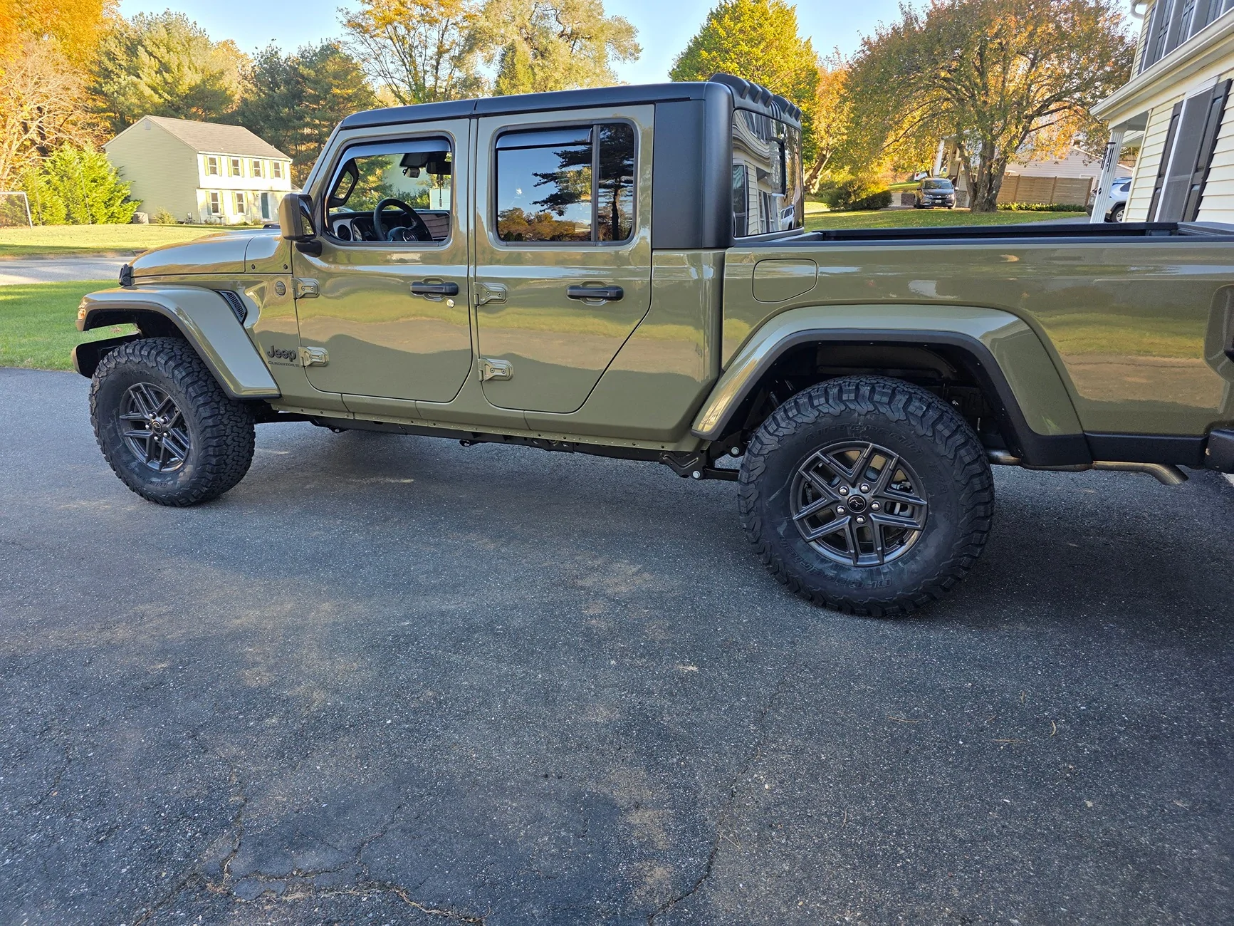

Wait, you're running 2.5 up front and nothing rear? Are you doing that stupid Carolina Squat crap?
I think you’re overthinking it. You have a 2.5” spacer lift now that’s being removed so you’d be back to factory height. You then want to add a 3.5” lift all around. You should expect the front to be about 1.5” higher than it sits with the spacers now. And the rear to increase approximately 3.5”. If the kit says it results in a level stance it should result in a level stance.
I assume you’ll notice the difference. Why your friend noticing matters, I’m not sure.
Ditto. If the claim from RC is it's a 3.5" lift and removes rake, then it's a 3.5 lift that removes rake.

Here is picture with 2.5 leveling spacers. It’s sit level, it’s not higher in the front, it sits level.
Jeep Gladiator Asking experts again. 3.5 lift after removing 2.5 leveling spacers in front. 20251027_160616_Original
