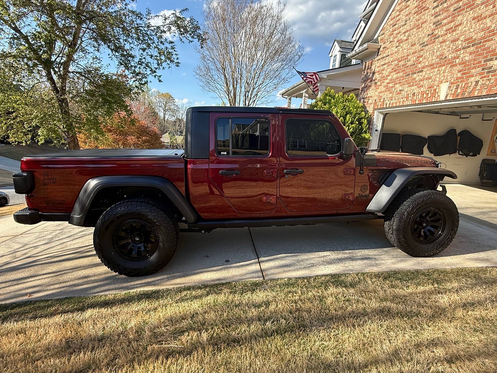

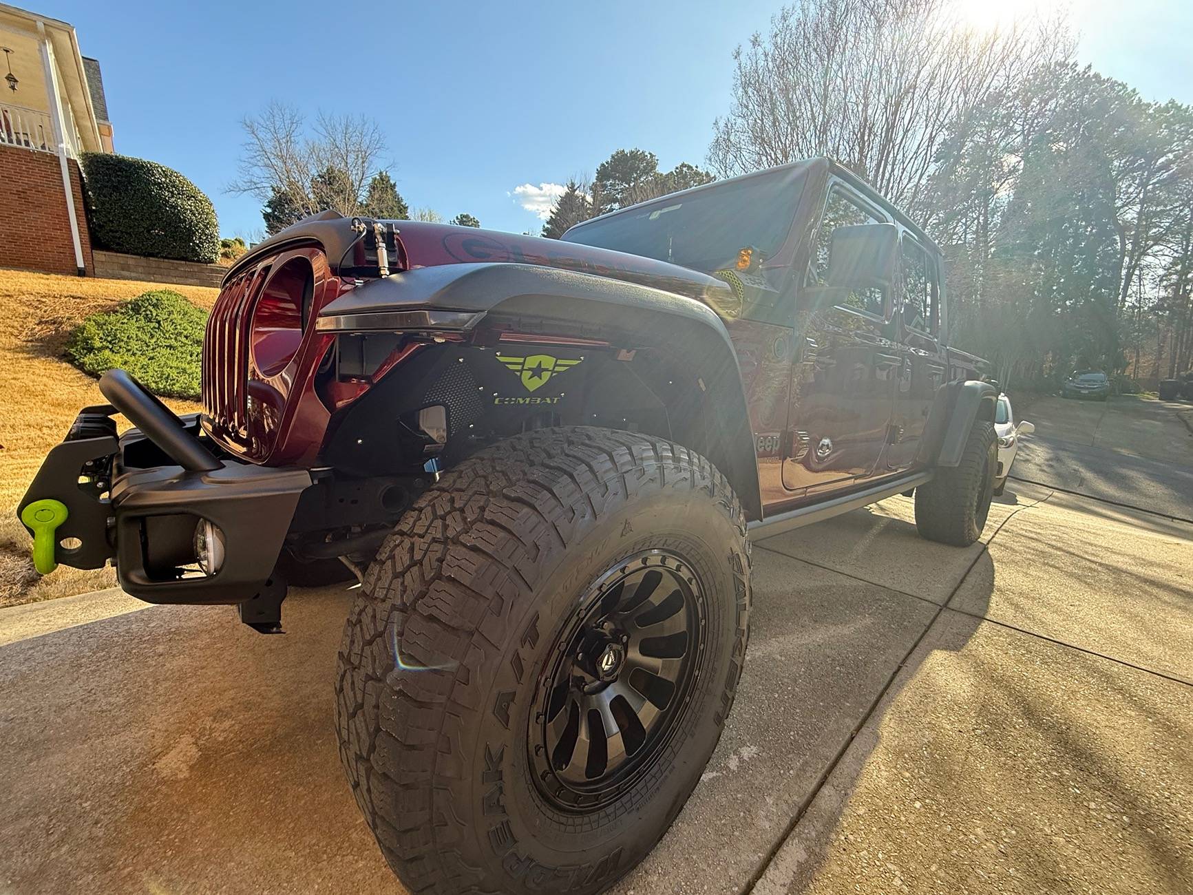

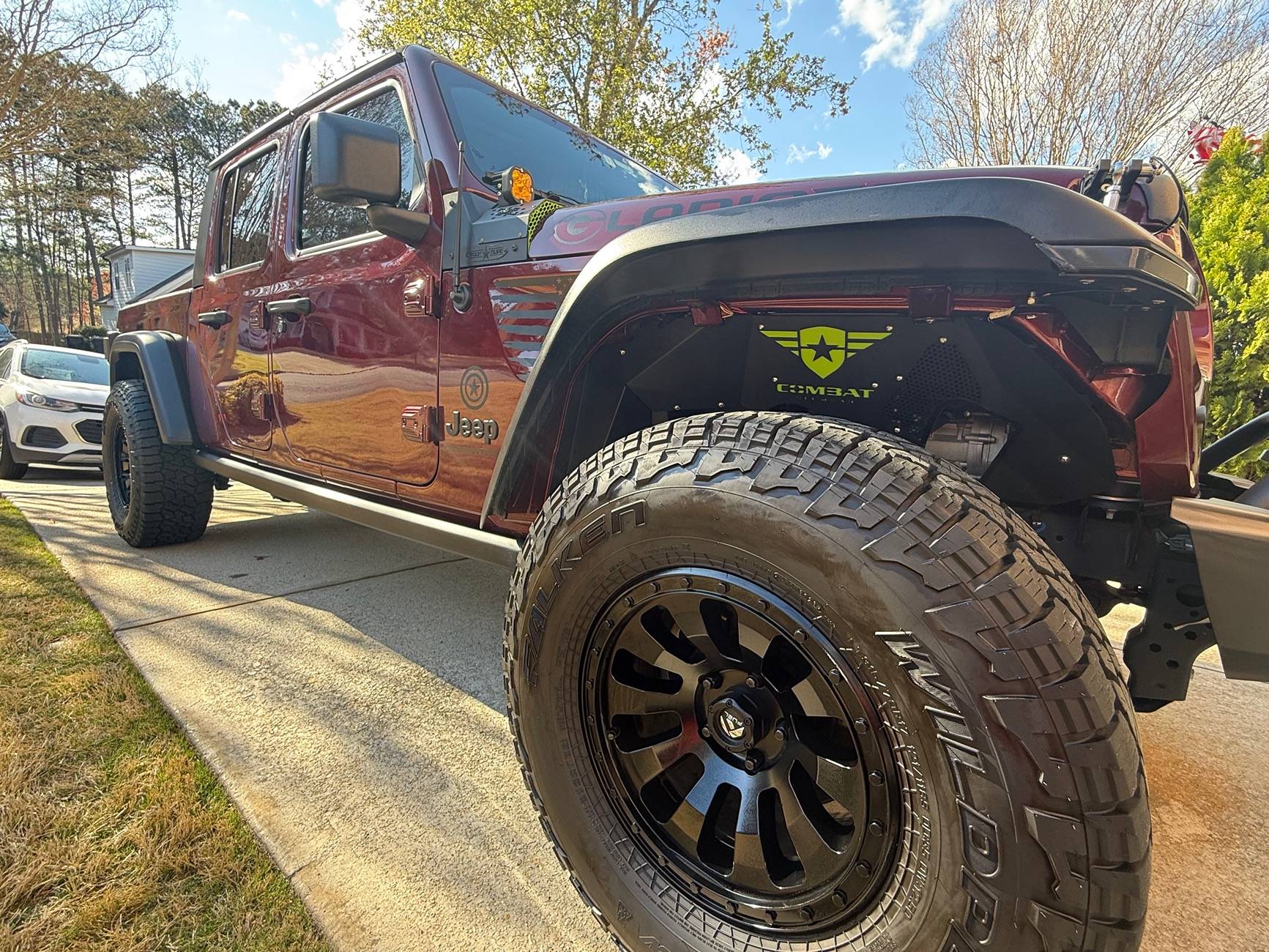

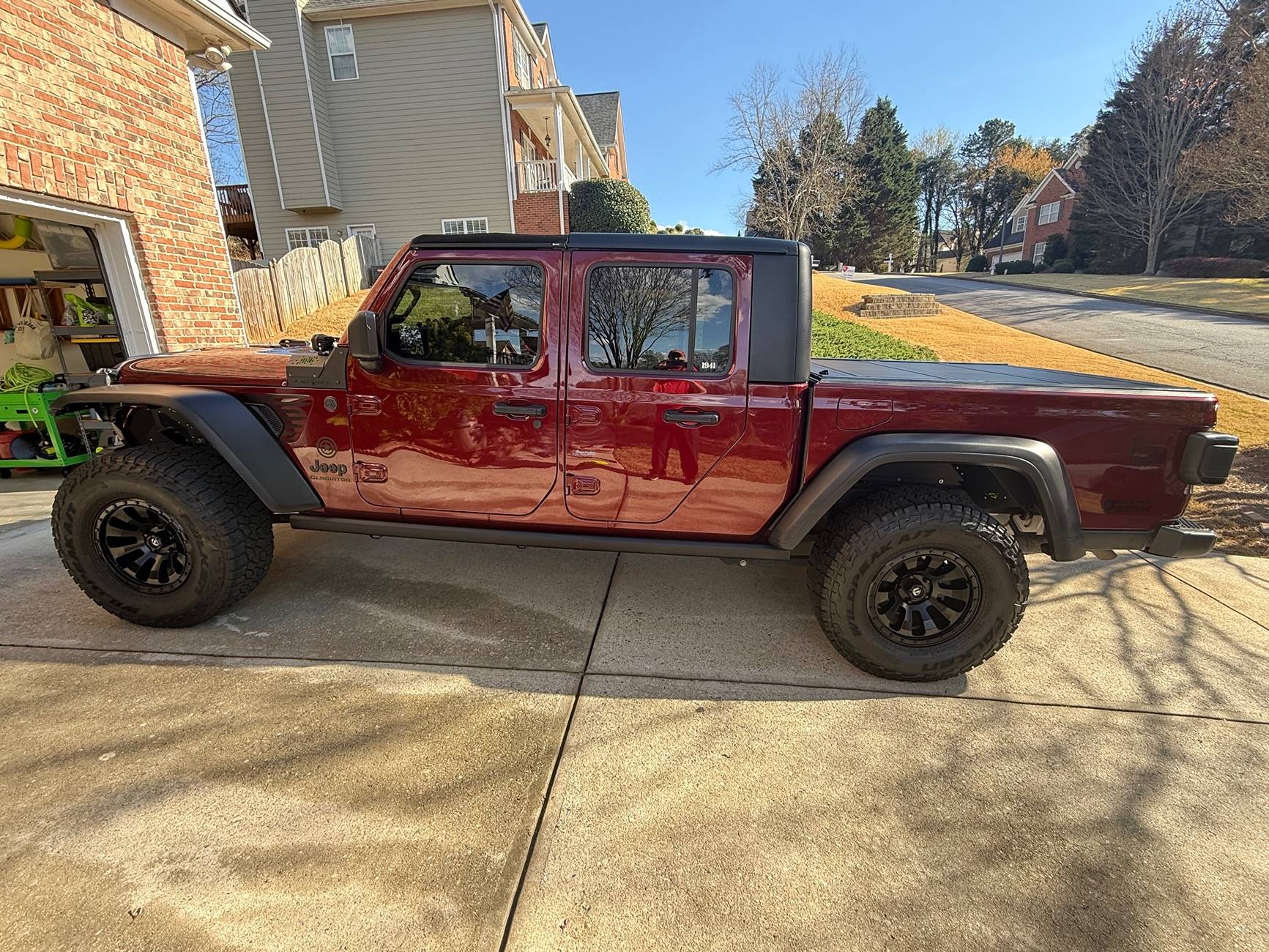

I put some takeoff Rubicon fender flares on my 22 Sport S. I did the front fender chop with the Infinite Offroad kit and have been pleased with everything. I may chop the rear flares but haven’t made up my mind yet. I had the stock color matched fenders.
