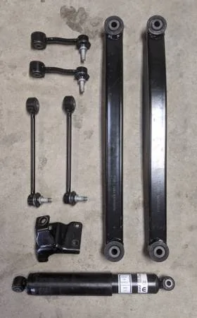

What parts do you need to make this work? I see the springs, shocks and spring seats for $200 and I see all fo that and a lot of other parts and maybe a steering damper for $300.
Jeep Gladiator Rubicon take off suspension 00Z0Z_aNjNPRvfJMs_0i60t2_600x450

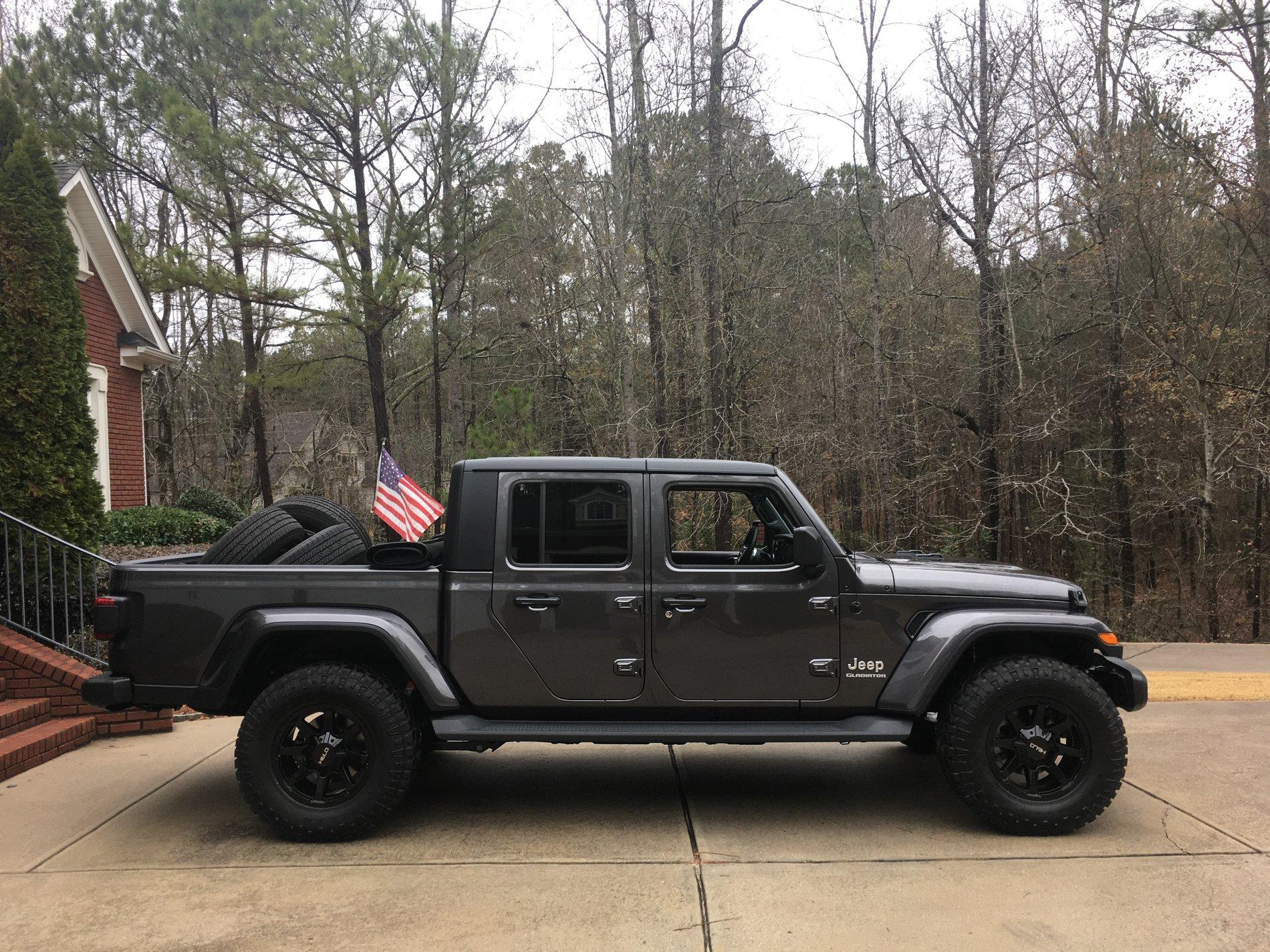

Gladiator Overland: The Overcon ‘82 CJ-7
The Overcon.
Overland with full Rubi suspension on 35’s.
No spacers....... yet,
Jeep Gladiator Rubicon take off suspension 1B79A8F3-B29E-4ECE-BD0E-A27D16215EDE
