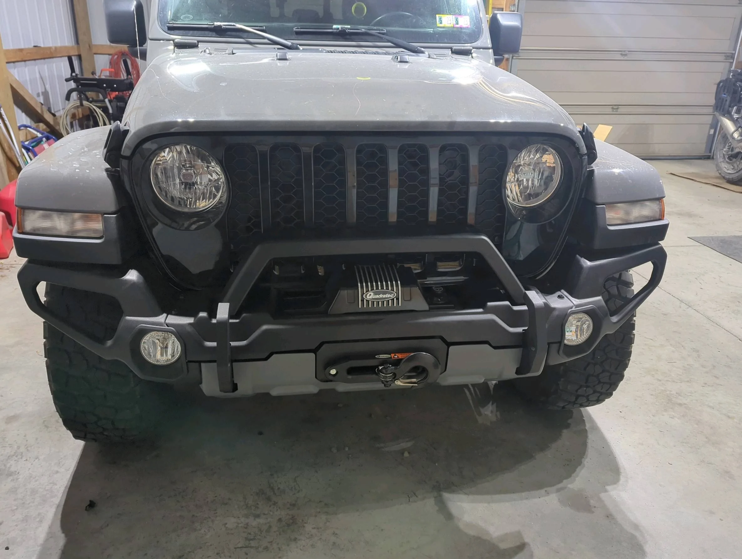

Installed the front bumper and winch yesterday.
Looks like it added about 3/8" sag to the front.
I was at 36 3/4" I am at ~36 3/8"
Seems like it should be ok.

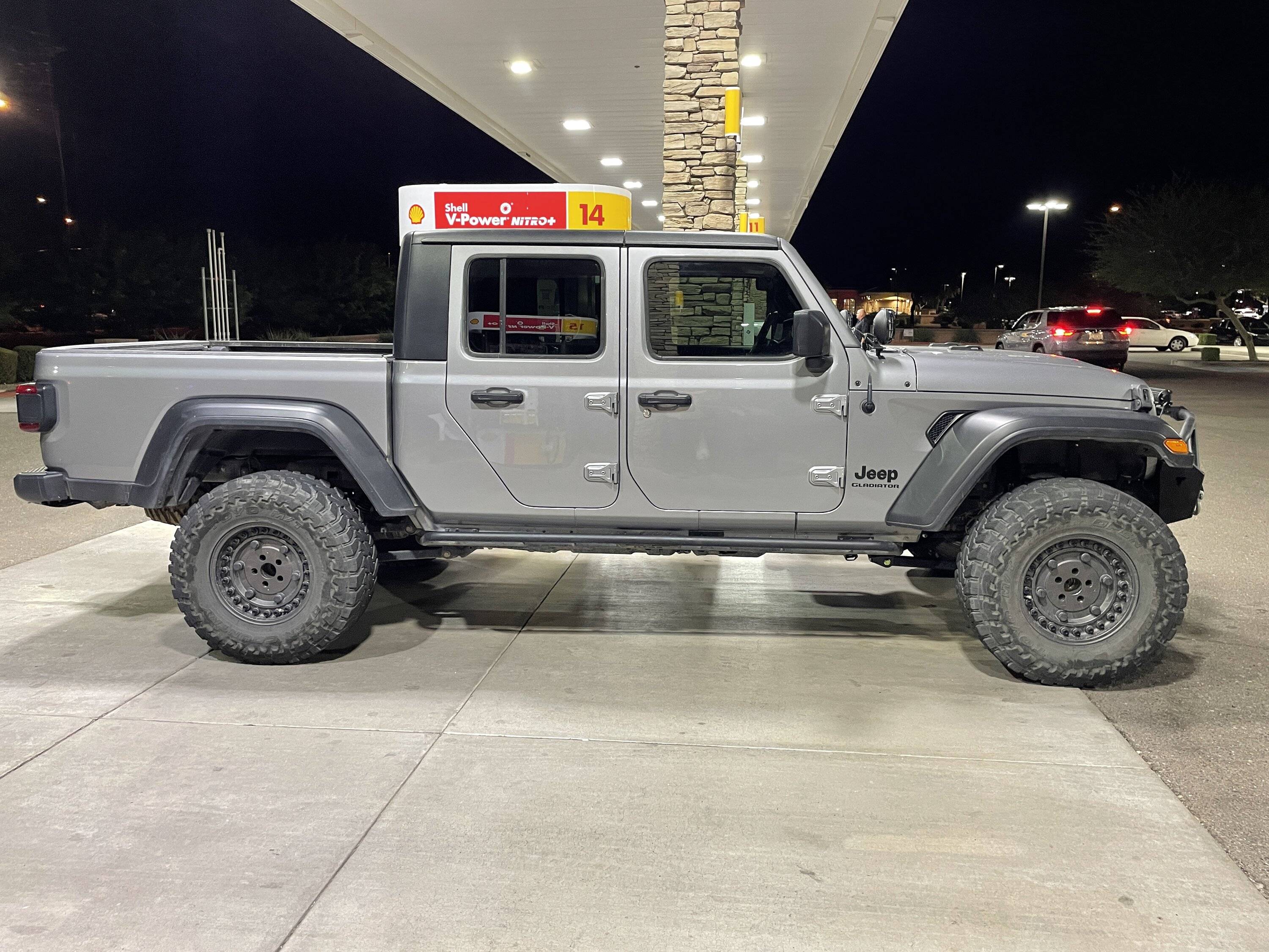

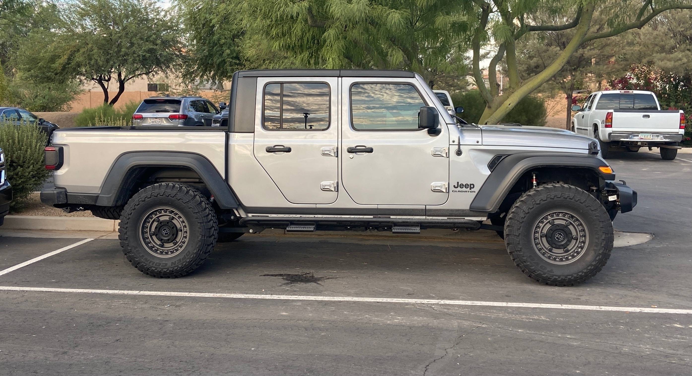

These are as close to two apple to apple pics that I have (first one is pre-bumper and winch). However, they both are when the truck was on 35s and had stock fenders. The top one is Rubicon takeoff suspension and a Teraflex level kit, the second one is with the 3.5" lift I got.
Jeep Gladiator Rubicon take off suspension help IMG_4133
Jeep Gladiator Rubicon take off suspension help IMG_7507

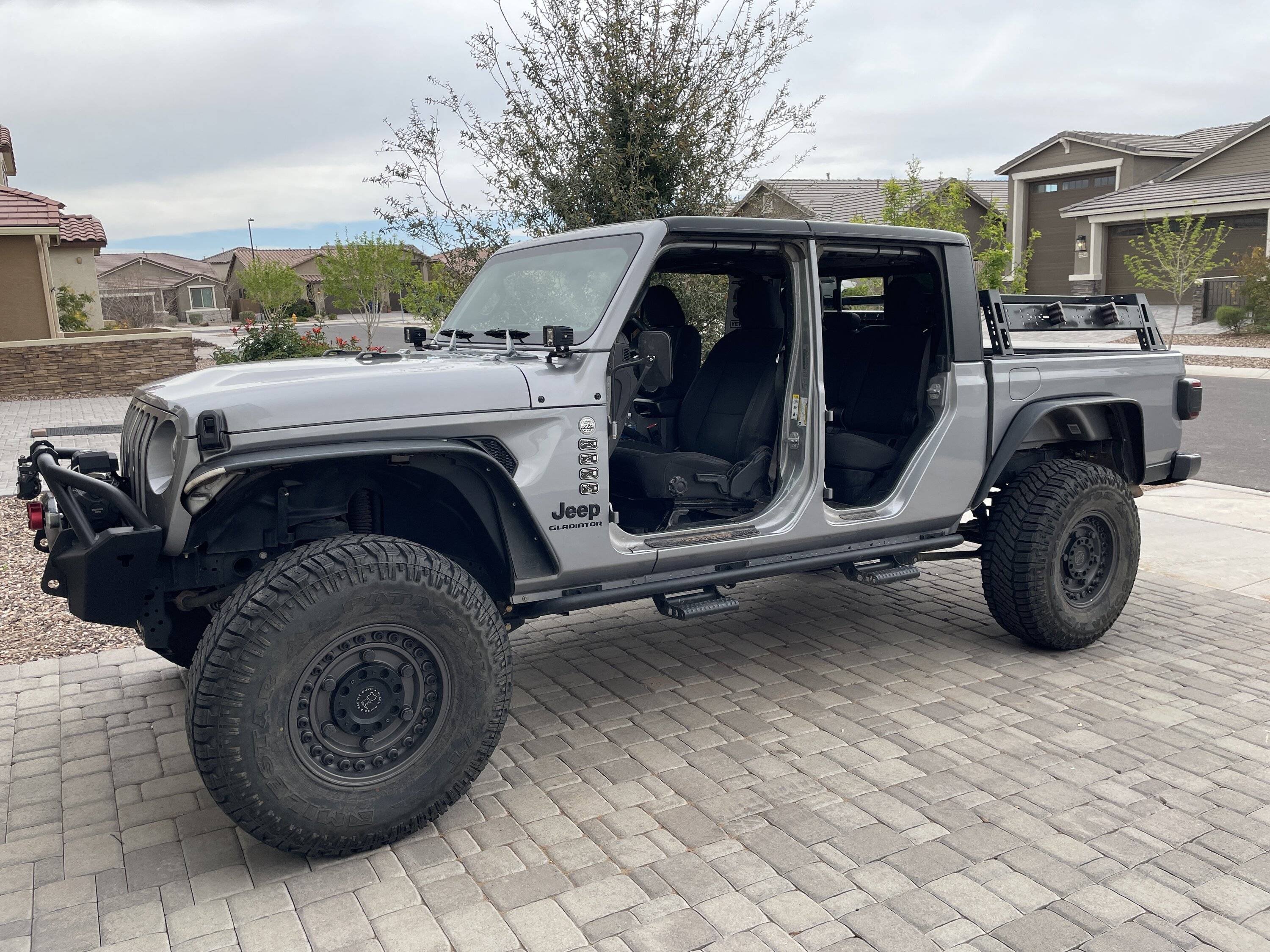

And here's a gratituous shot of how it looks now
Jeep Gladiator Rubicon take off suspension help IMG_0439
