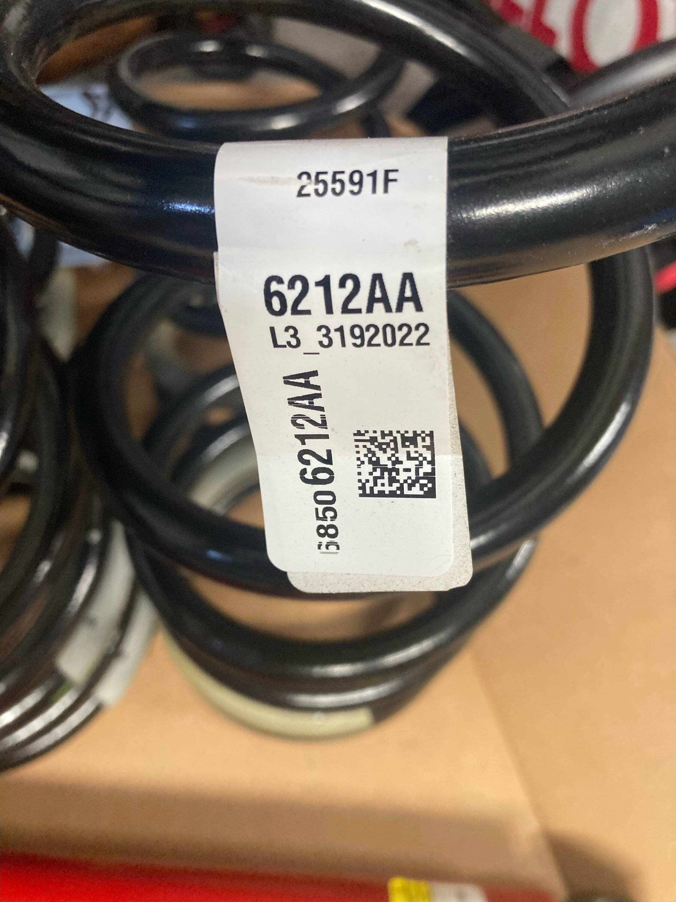

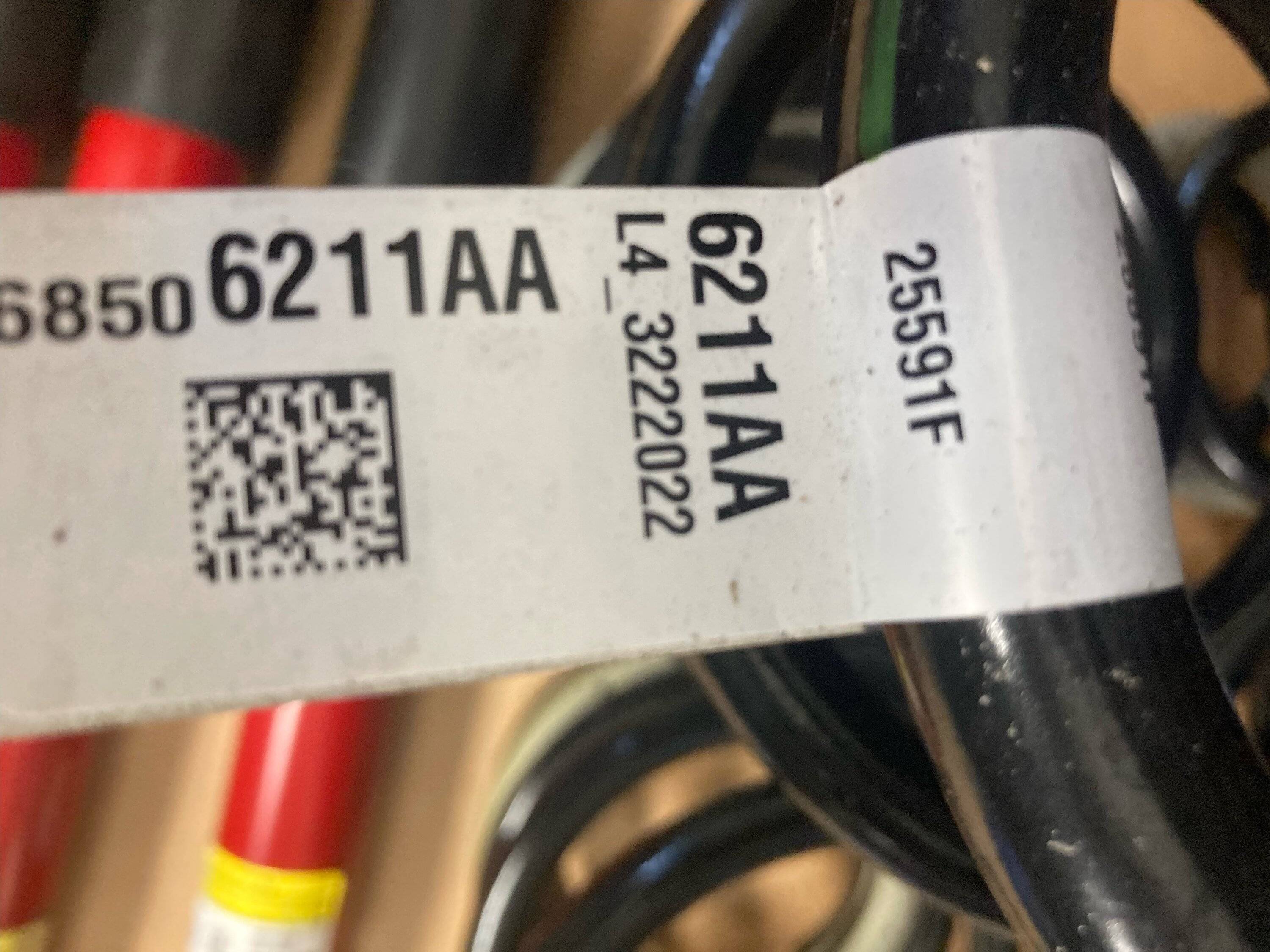

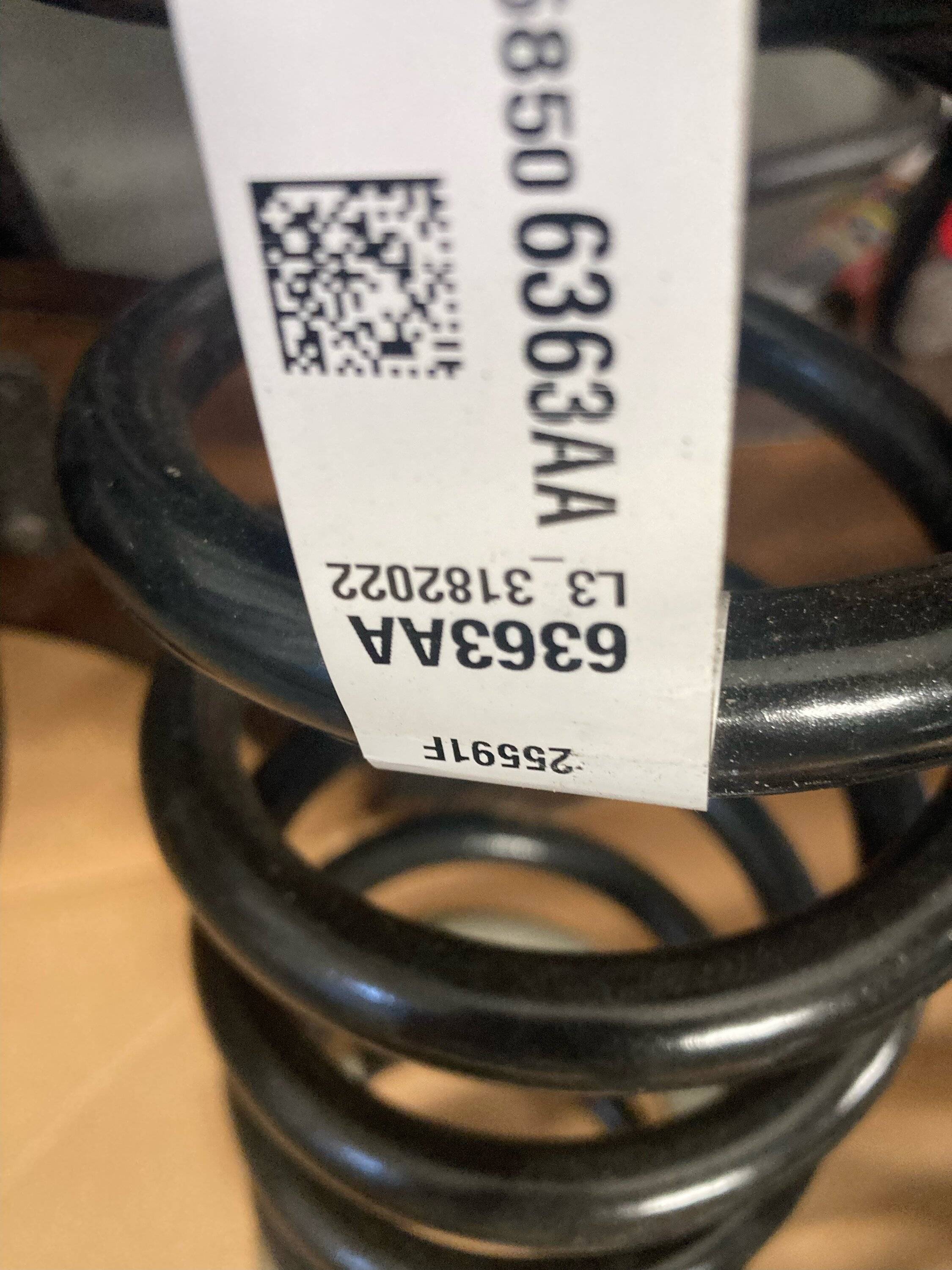

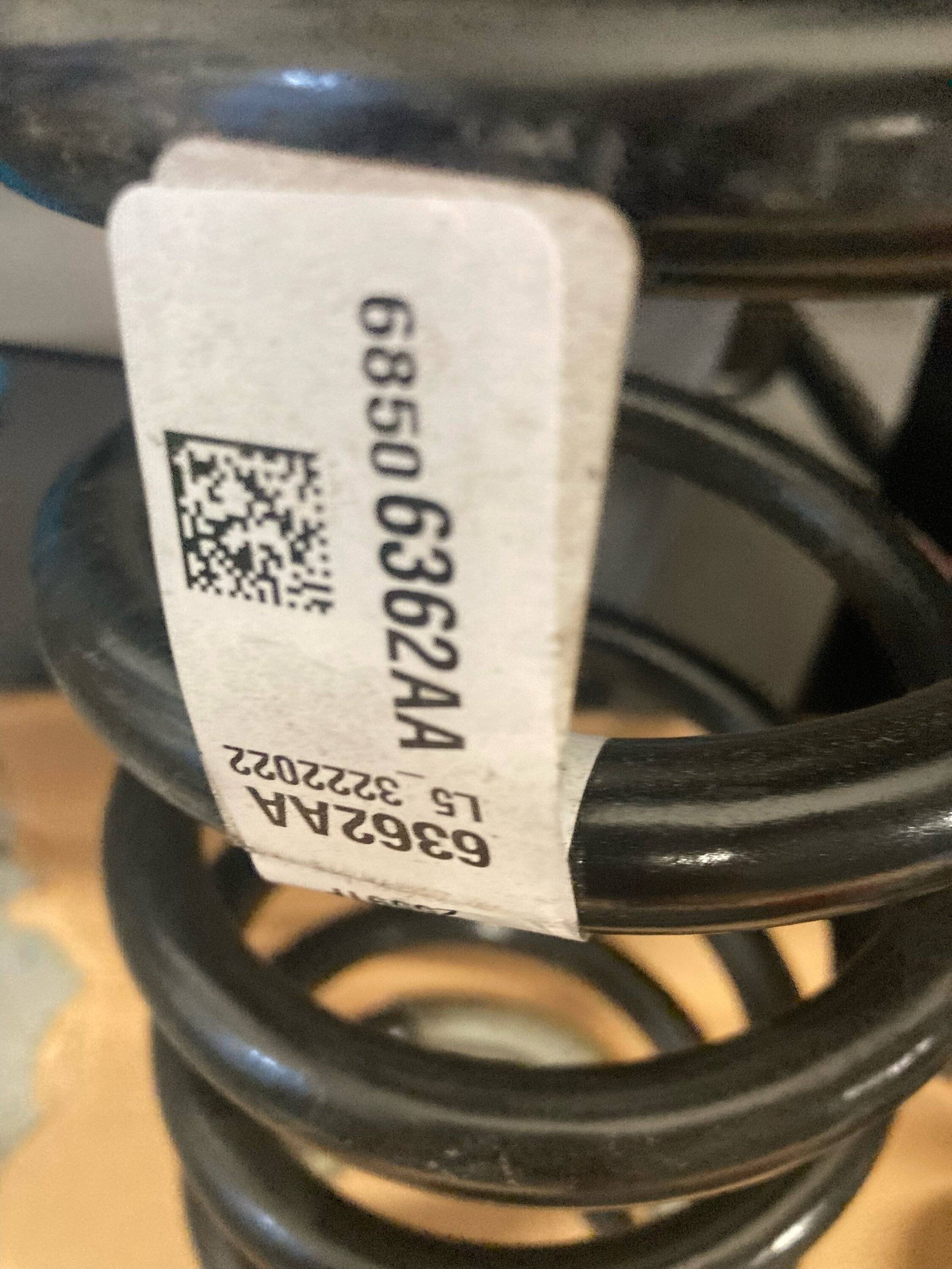

What I got:
Springs:
58606211AA
58606212AA
68506362AA
68506363AA

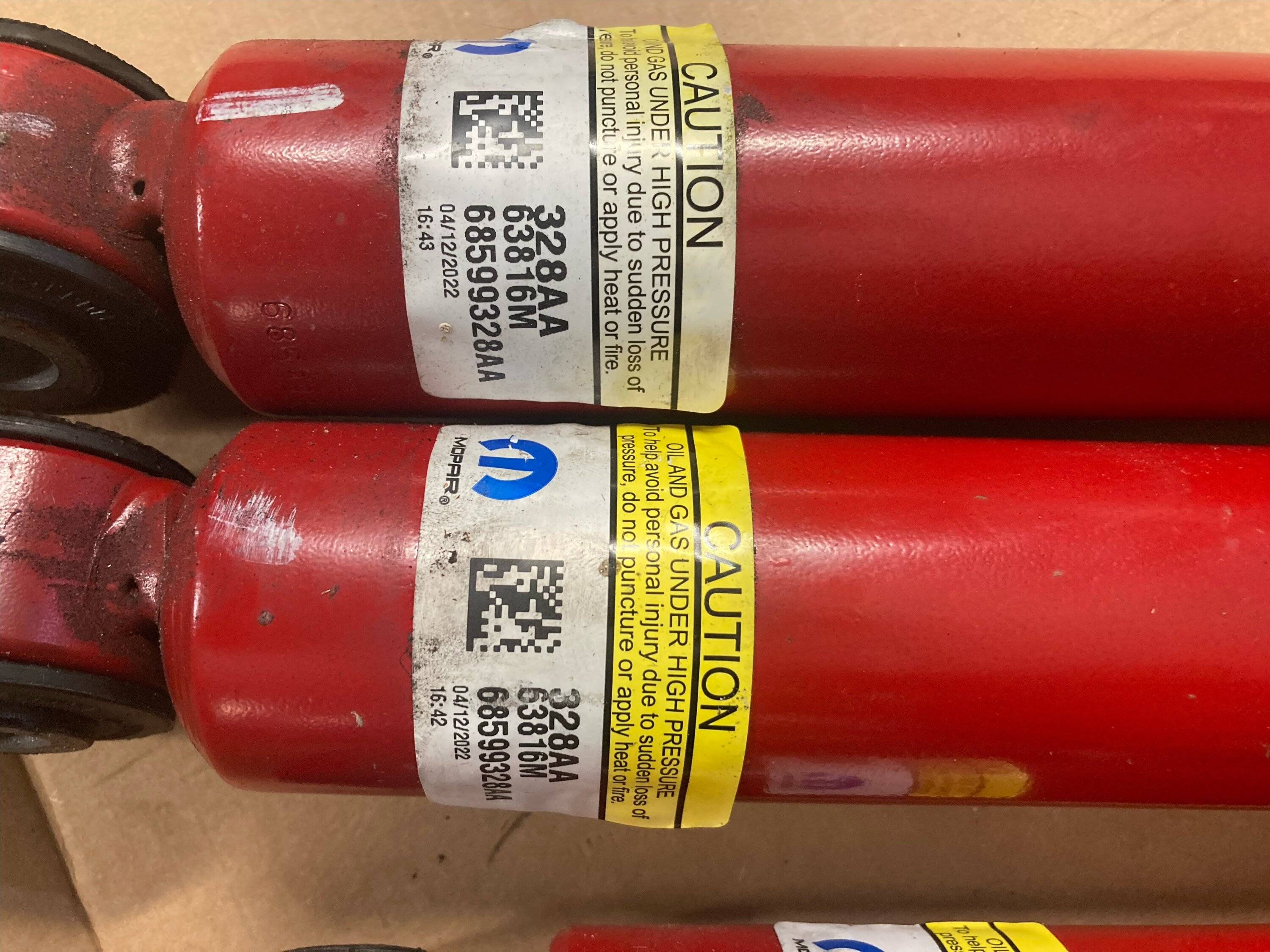

RubiRed Shocks
Each pair is matching with 3 part numbers on each
327AB
63816M
68599327AB
328AA
63816M
685993228AA
I just need to know which things go in which places.

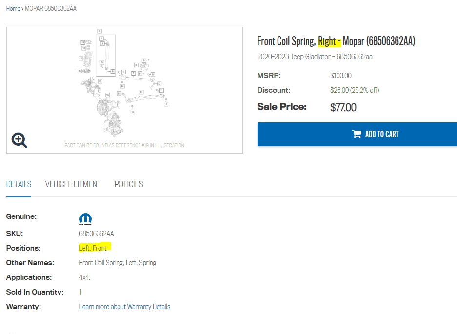

I went to that site also, If you look carefully it says Right in one spot and left in another. Clear as Mud...
I think the fronts are universal and rear are universal, there is no right or left, just front and rear.
No, there's a left and right. On a gasser, the higher number (higher rate) goes on the right side.
You can't go by part number because the right front on one Overland, just for example, could be the left front on another. You have to compare the pairs.

Given the numbers above - use the spring with the higher part number for that pair on the right, the spring with the lower part number for that particular pair on the left.
And you can't mix up front and rear springs - pretty easy once you get into it.
Do not look up springs online - it will only confuse. Go by the specific pair you received and put the higher number of the front pair on the right side, the higher number of the rear pair on the right side.
Another truck may have that high number as the low one in its pairs.
