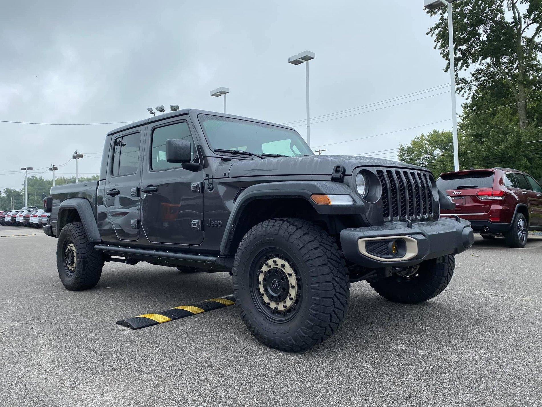

I did the Rubicon suspension swap on my gladiator and I love it. 35’s will fit without a lift. Had my wheels and tires on well before the suspension.
Jeep Gladiator Rubicon suspension takeoff question C28912F2-8F4C-4E45-AA82-2229D7651866
